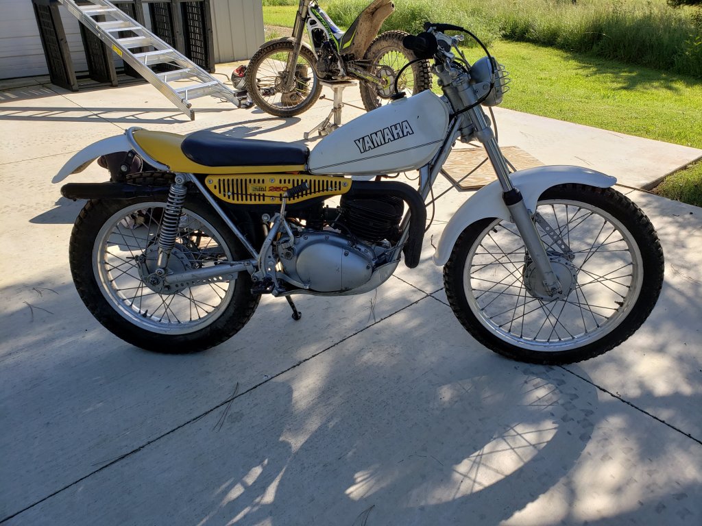

lolosuzuki Posted May 20, 2019 Report Share Posted May 20, 2019 Where do i start!? It runs and rides. 1. The previous owner has the throttle cable going into the case but mixes fuel. I was told replace rhe whole control with a domino and run the cable directly to the carb. What cable do i buy? 2. What ratio and premix type? I run motule 800 80:1 on my modern bikes. 3. What fluid do i put in the transmission? 4. Forks seals leak. Should i order oem stuff or is there a better alternative? 5. Bearings! Do i use oem or is there better? 6. Sprockets and chain. Where do i get these? These are my "initial" questions. I plan to use thia bike for sime vintage competitions. I would like to make the bike better. Not restore it to original. Thanks! 2 Quote Link to comment Share on other sites More sharing options...
