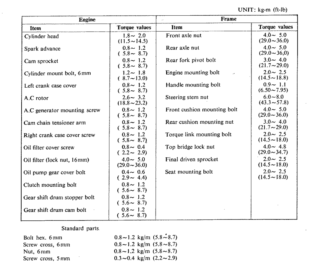

sirsherco1 Posted May 28, 2019 Report Share Posted May 28, 2019 hi, got a reco 125 tl but there is, light oil seep from gasket what is the head re-tightening sequence and torque ? Cheers. Quote Link to comment Share on other sites More sharing options...
Bilko Posted May 28, 2019 Report Share Posted May 28, 2019 Nothing in the manual i have but these are from the cb sl 125 which is basically same engine Quote Link to comment Share on other sites More sharing options...
gasserocm Posted May 29, 2019 Report Share Posted May 29, 2019 Thank you, i think i read somewhere that the 76 125 s tl was 20-22ft lbs, prior was 13-14ft lbs, is there a squence or just an X pattern on the top bolts ? Quote Link to comment Share on other sites More sharing options...
