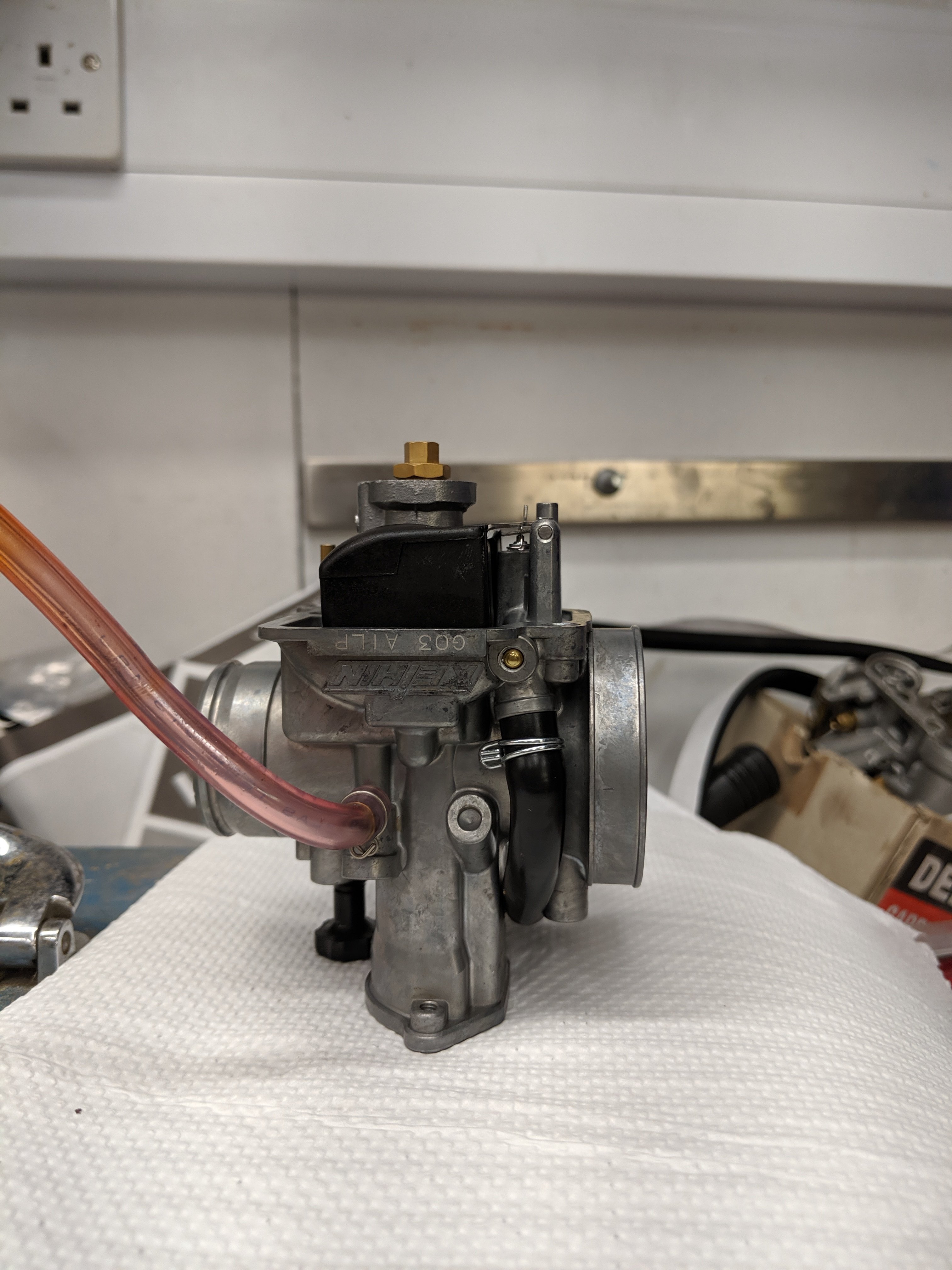

nigel dabster Posted June 17, 2019 Report Share Posted June 17, 2019 Spoiler Float level Quote Link to comment Share on other sites More sharing options...

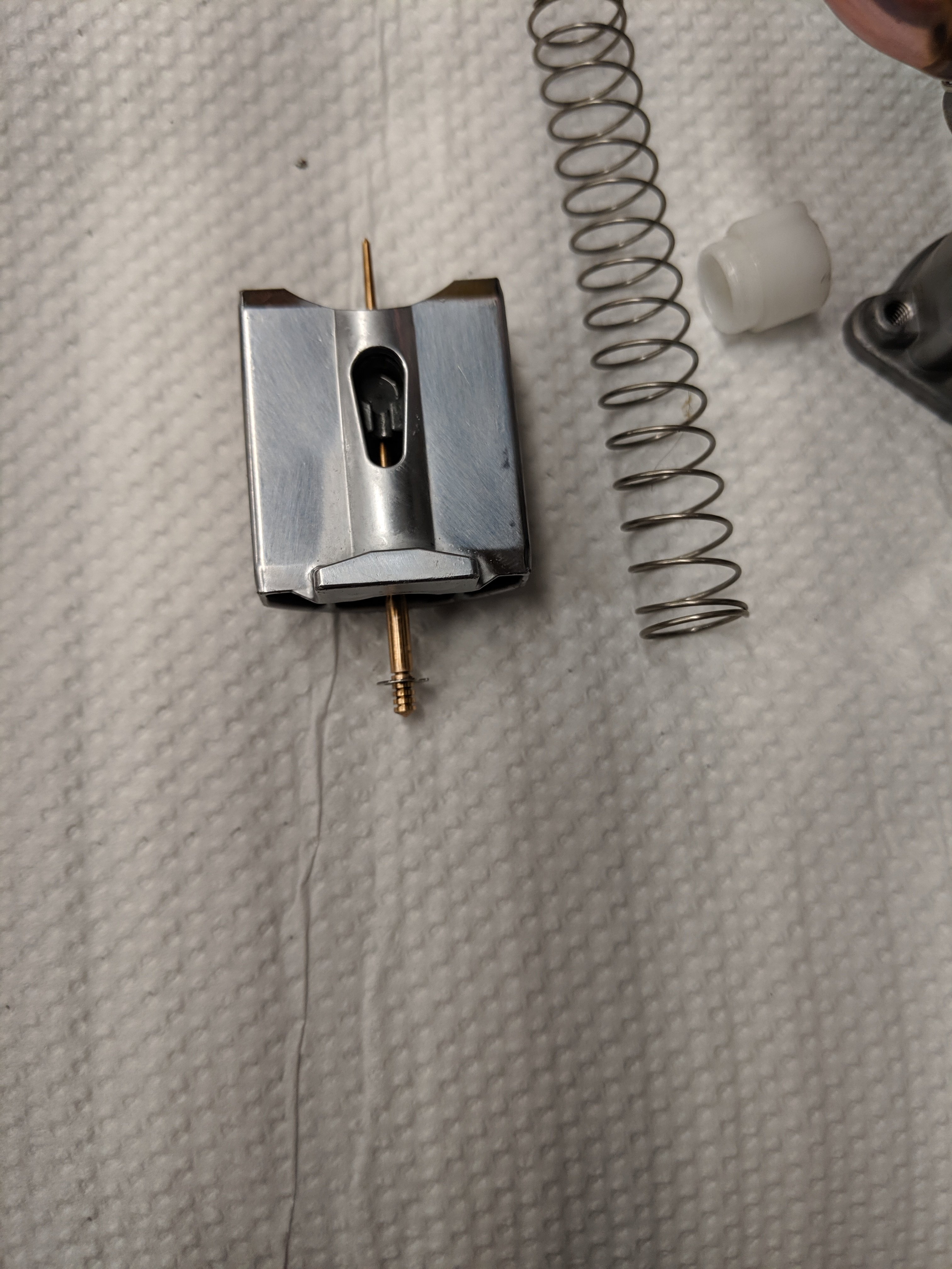

nigel dabster Posted June 17, 2019 Report Share Posted June 17, 2019 Needle clip position Quote Link to comment Share on other sites More sharing options...

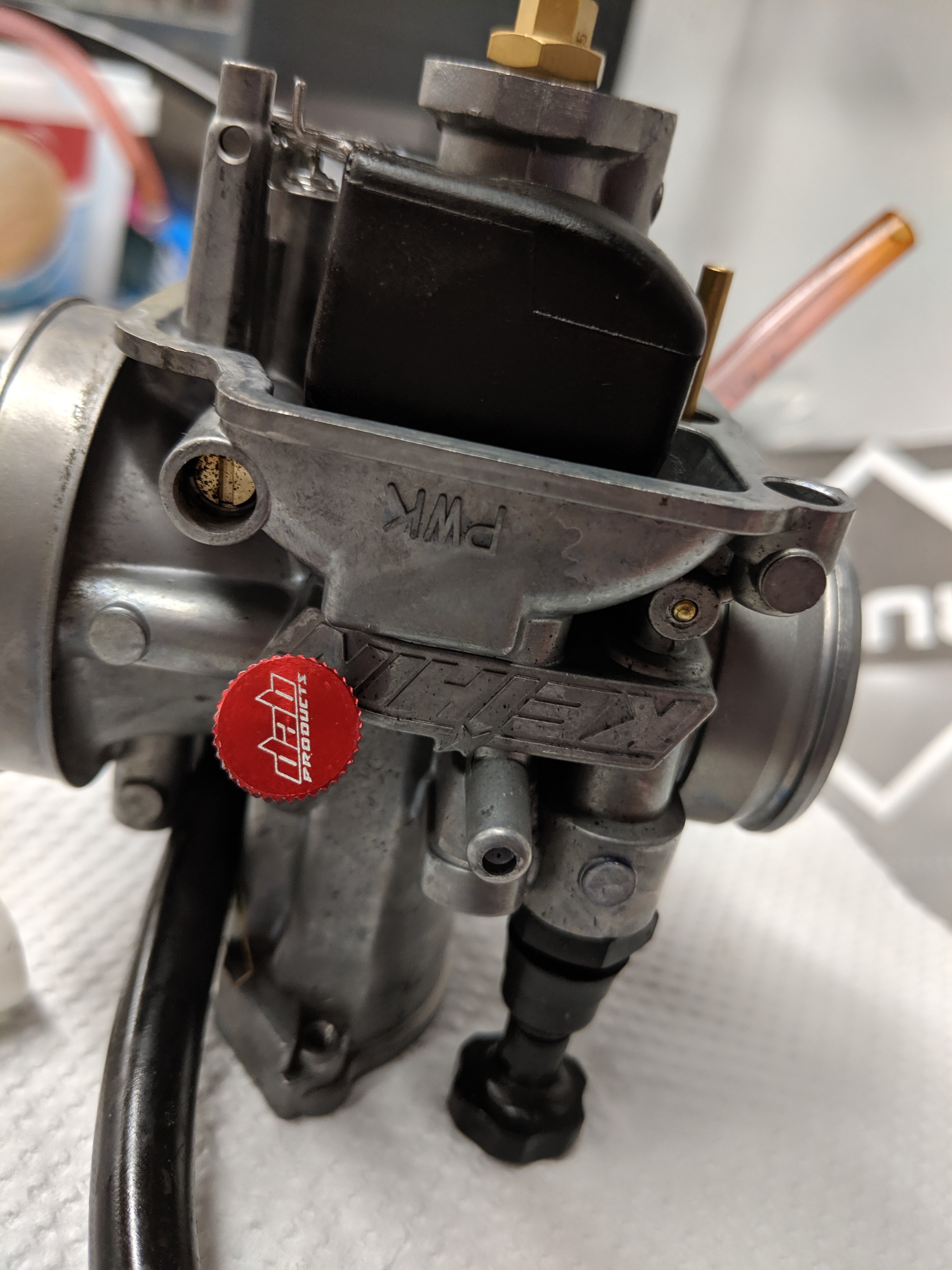

nigel dabster Posted June 17, 2019 Report Share Posted June 17, 2019 Note original air screw, tickover is ok with after market. Quote Link to comment Share on other sites More sharing options...

collyolly Posted June 17, 2019 Author Report Share Posted June 17, 2019 Many thanks for the info, your needle clip is as mine was originally now it's in the middle, but I don't think that would effect the starting do you ? What have you heard or experianced re the after market mixture screw ? Does it just not work correctly. Have you tried a flywheel weight, I had one on a 2009 250 and it made the starting easier but killed the throttle response I seem to remember I ended up reducing the mass by around 50% Quote Link to comment Share on other sites More sharing options...
nigel dabster Posted June 22, 2019 Report Share Posted June 22, 2019 On 6/17/2019 at 10:00 PM, collyolly said: Many thanks for the info, your needle clip is as mine was originally now it's in the middle, but I don't think that would effect the starting do you ? What have you heard or experianced re the after market mixture screw ? Does it just not work correctly. Have you tried a flywheel weight, I had one on a 2009 250 and it made the starting easier but killed the throttle response I seem to remember I ended up reducing the mass by around 50% Hi I hate flywheel weight s. Change to original airscrew it's a waste of time after market. If your carb is set up line this it should be fine. Starting is as much about technique as much as anything. Quote Link to comment Share on other sites More sharing options...
