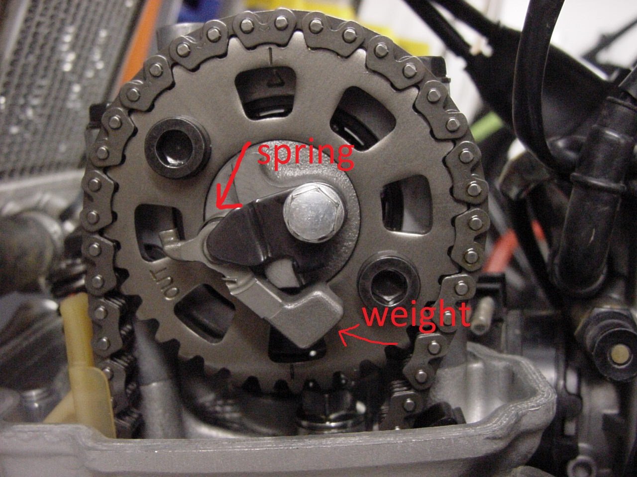

konrad Posted June 15, 2019 Report Share Posted June 15, 2019 (edited) 4 hours ago, ivanrs01 said: Today I have done a compression test and wanted to discuss the results with you, with the 125 psi cold engine and the 200 psi hot engine, I do not understand these results because in the manual it says that the figure has to be 65 psi. Sounds like your automatic decompressor (compression release) is not working. At kicking speeds, the exhaust valves are held open slightly. This system is very common on modern 4Ts. It allows a higher rotational speed for starting and easier kicking. Once the engine fires, the decompressor ceases to operate and the cylinder pressure returns to that of normal operation. The decompressor is built into the camshaft. See the service manual for more information. Edited June 15, 2019 by konrad spelling 1 Quote Link to comment Share on other sites More sharing options...

konrad Posted June 16, 2019 Report Share Posted June 16, 2019 (edited) There is more to the decompressor than just a spring. There is a centrifugal mechanism to inhibit it from releasing compression when the engine is actually running. Americans call "tickover" the idle speed. There is an adjustment on the throttle body. It should be 1700 to 1900 rpm when the engine is up to temperature. Hard starting can result if set incorrectly. Also check that the valve clearances are set correctly. I see that you've done this already. Edited June 16, 2019 by konrad 1 Quote Link to comment Share on other sites More sharing options...

konrad Posted June 16, 2019 Report Share Posted June 16, 2019 The photos in the 4RT manual are not clear. Here is a photo of some of the decompressor parts on a CRF150RB. It may be similar to the 4RT. Does your compression gauge read directly in PSI? Maybe a units conversion error? Quote Link to comment Share on other sites More sharing options...
ivanrs01 Posted June 16, 2019 Author Report Share Posted June 16, 2019 the checked the decompressor i think it works well, I leave you link: https://youtu.be/O0T9fJ-2l6o I have also checked the distribution marks of the camshaft and they are fine, the compression meter that I use is this, I do the test as the manual says, hot engine and the gas completely open I leave some more images, I think it's all right Quote Link to comment Share on other sites More sharing options...
konrad Posted June 17, 2019 Report Share Posted June 17, 2019 While testing compression are you kicking so rapidly that the decompressor behaves as though the engine is running? That would explain the the high pressure reading. I'm just guessing here, but typical kick-starting speed may be 250 rpm. The decompressor probably deactivates at around 1000 rpm. Quote Link to comment Share on other sites More sharing options...
