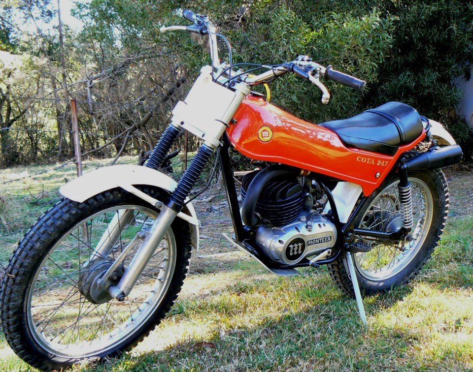

keychange Posted June 16, 2019 Report Share Posted June 16, 2019 I need to paint two Cota 247 bodies. I have done it in the past but results were mixed. I want to do this right and finish off with a very hard, fuel proof, KBS Diamond clear coat. But before I get their I need to use the right pre-coat and top coat. I would appreciate suggestions for both pre-coat that will give me a well attached base that I can sand to a good finish and then a sound top coat. Quote Link to comment Share on other sites More sharing options...
