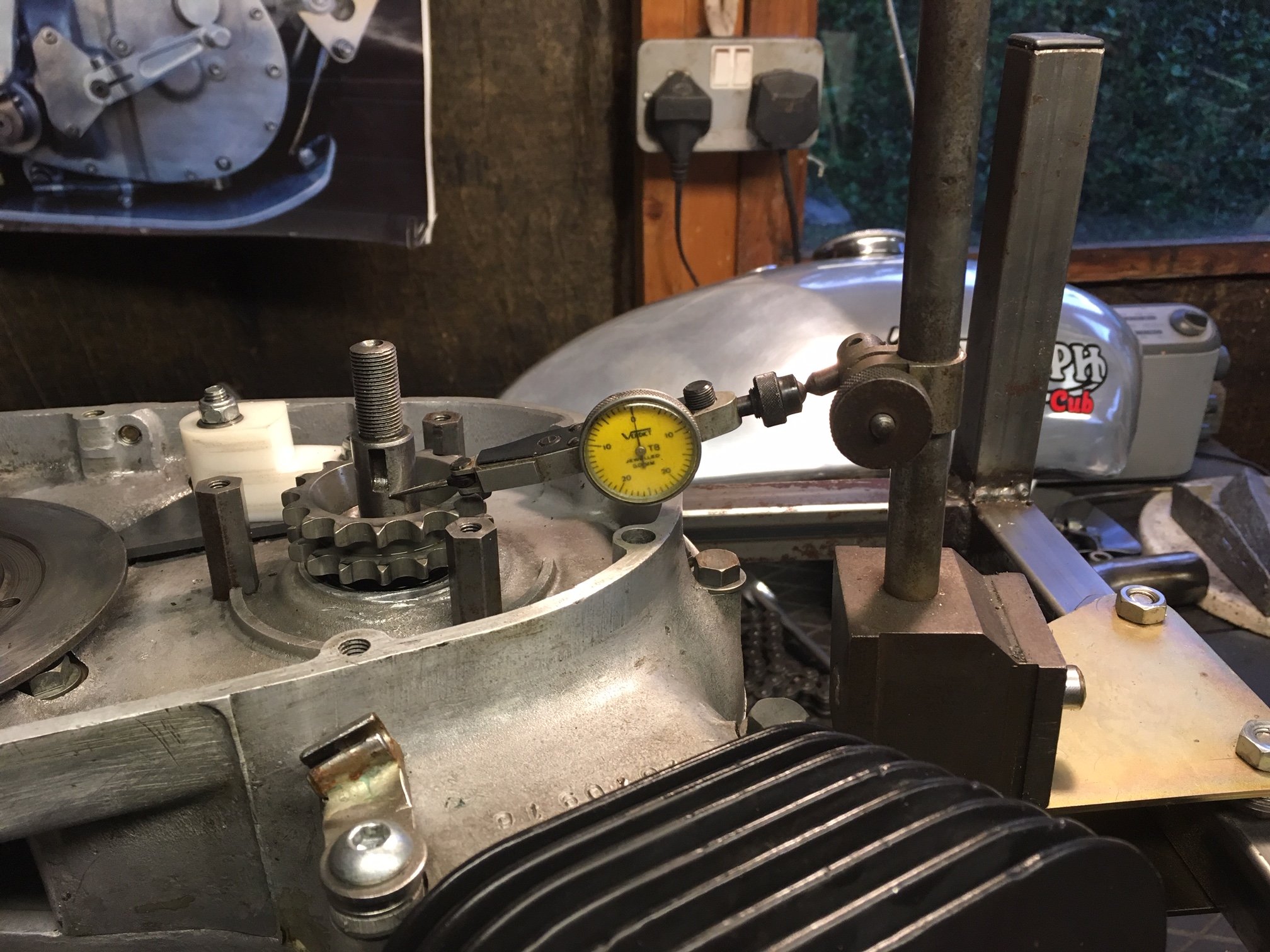

brucey Posted July 6, 2019 Author Report Share Posted July 6, 2019 On a slightly different note, I have stripped the engine and measured the crank alignment near the ignition rotor key way. It appears to be running out around 0.3mm (about 10 thou) total. I have been advised this is ok. The ignition rotor doesn't touch the stator (I recon about 0.5mm clearance). although it does 'wobble' a little bit ? Has anyone else measured the crank run out on their engine? Bruce. Quote Link to comment Share on other sites More sharing options...
thai-ty Posted July 31, 2019 Report Share Posted July 31, 2019 (edited) 1. Again no Cub expert, but ten thou seems a lot. 2. Having sold up my Triumph shop in 2003, i am not familiar with a plastic ball oil pump kit, but it just sounds so wrong. 3. If you are getting wet sumping with a Triumph type plunger oil pump, it can only be balls not seating on the seat. Normally dirt. However a light plastic ball again just does not seem right. 4. By the sounds of things, the whole thing needs to come apart and be blueprinted. Regards. Edit, on our race or high performance twins we always ditched the timed breather, and ran a proper large bore non timed breather pipe from either the timing cover, primary cover or c/case. We also ran top end breathers from both r/boxes. None of our engines had oiling problems or oil leaks. Again, these were all 650-750-830 twins. Edited July 31, 2019 by thai-ty 1 Quote Link to comment Share on other sites More sharing options...
