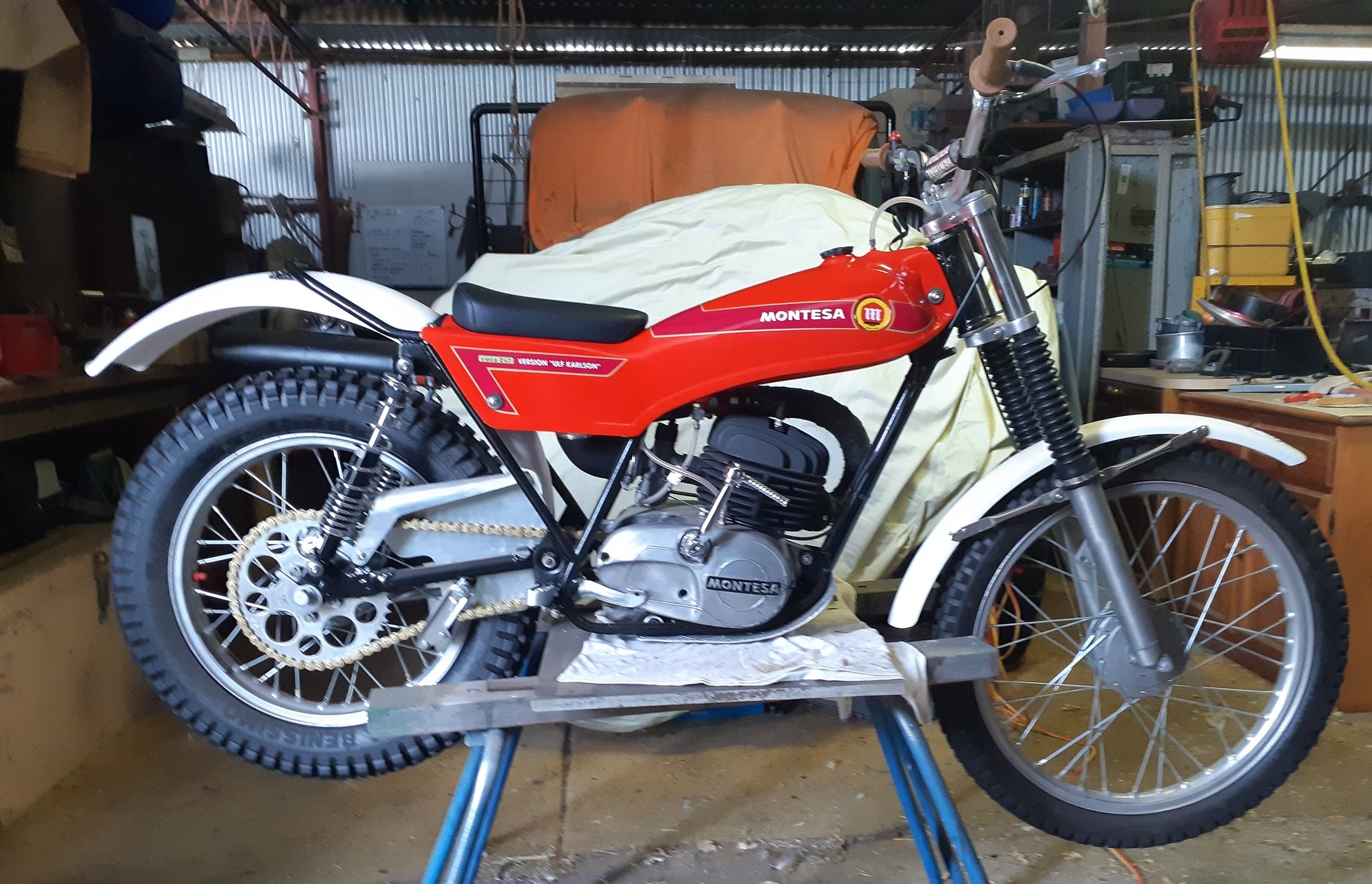

oldaz Posted July 3, 2019 Report Share Posted July 3, 2019 I finished the rebuild on my 247 a few months ago, dropped a bit of fuel in it and rode it around the back yard then put it away in the shop with a view to sell it. I figured one ride at my 74 years was enough for this old body. A friend wanted to have a look at it (the bike, not the old body) and to my dismay the paint on the fuel tank had bubbled in several places. I had sealed and refinished the tank, so expected it would be good. This bike had been worked hard, then sat out in the weather for 30 odd years before I got it and apparently our Australian sunshine didn't do the fiberglass any favors. After inspecting as much as I could I decided the only way to fix it properly would be to take the tank apart and fix from the inside. I used a Dremel type tool to carefully cut the base out of the tank assembly and I'm now glad I made this decision. The inside of the top section is all cracked and crazed and no way would a sealer ever have "fixed" it. I now have the dilemma, do I use the base to make a new fiberglass tank that will fit inside the original cowling, or do I re-fiberglass the inside of the cowl section and glass the bottom back in? The bottom is much thicker and no signs of cracking, so I'll at least use it. Attached picture of the bike when I finished it 1 Quote Link to comment Share on other sites More sharing options...

mattylad Posted July 3, 2019 Report Share Posted July 3, 2019 (edited) I would fabricate an alloy tank to sit inside the cover as they did on UK bikes. See the "Shedworks" site for examples. PS lovely bike Edited July 3, 2019 by mattylad addition 2 Quote Link to comment Share on other sites More sharing options...
sherpa325 Posted July 3, 2019 Report Share Posted July 3, 2019 Resin and glass mat are relatively cheap and I assume you are retired so you have the time to do a thorough repair job. Just remember not to use any fuel with ethanol in it. 1 Quote Link to comment Share on other sites More sharing options...
oldaz Posted July 5, 2019 Author Report Share Posted July 5, 2019 On 7/3/2019 at 5:50 PM, mattylad said: I would fabricate an alloy tank to sit inside the cover as they did on UK bikes. See the "Shedworks" site for examples. PS lovely bike Thanks for the heads up on shedworks and thanks for the nice comment. I've decided to go fiberglass, but yet to decide which way. Quote Link to comment Share on other sites More sharing options...
oldaz Posted July 5, 2019 Author Report Share Posted July 5, 2019 On 7/3/2019 at 8:52 PM, sherpa325 said: Resin and glass mat are relatively cheap and I assume you are retired so you have the time to do a thorough repair job. Just remember not to use any fuel with ethanol in it. Not officially retired as I'm still farming, but do have time to do a good job. I've decided to go fiberglass, just haven't made up my mind as to whether the repair will be like the original or whether the base of the original will be the base for a stand alone tank to fit in the original fairing. Non ethanol fuel isn't a problem here in Oz, but I'll look into ethanol resistant resin as used in the shedworks glass tanks. Quote Link to comment Share on other sites More sharing options...
oldaz Posted July 5, 2019 Author Report Share Posted July 5, 2019 On 7/3/2019 at 4:04 PM, feetupfun said: If it was me I'd fix the top part and put it back together Since looking at the shedworks site, my thoughts are heading in this direction using ethanol resistant resin. I don't think the extra glass and resin will add much weight (smiles) or reduce the fuel capacity much for the extra strength and security. I was interesting to see the amount of cracking inside and how much the fiberglass had deteriorated from uv exposure, the new lining was never going to do a good job. Disappointed that I'll have to repaint the outside again and now have to find another set of stickers, not a cheap exercise. Quote Link to comment Share on other sites More sharing options...
