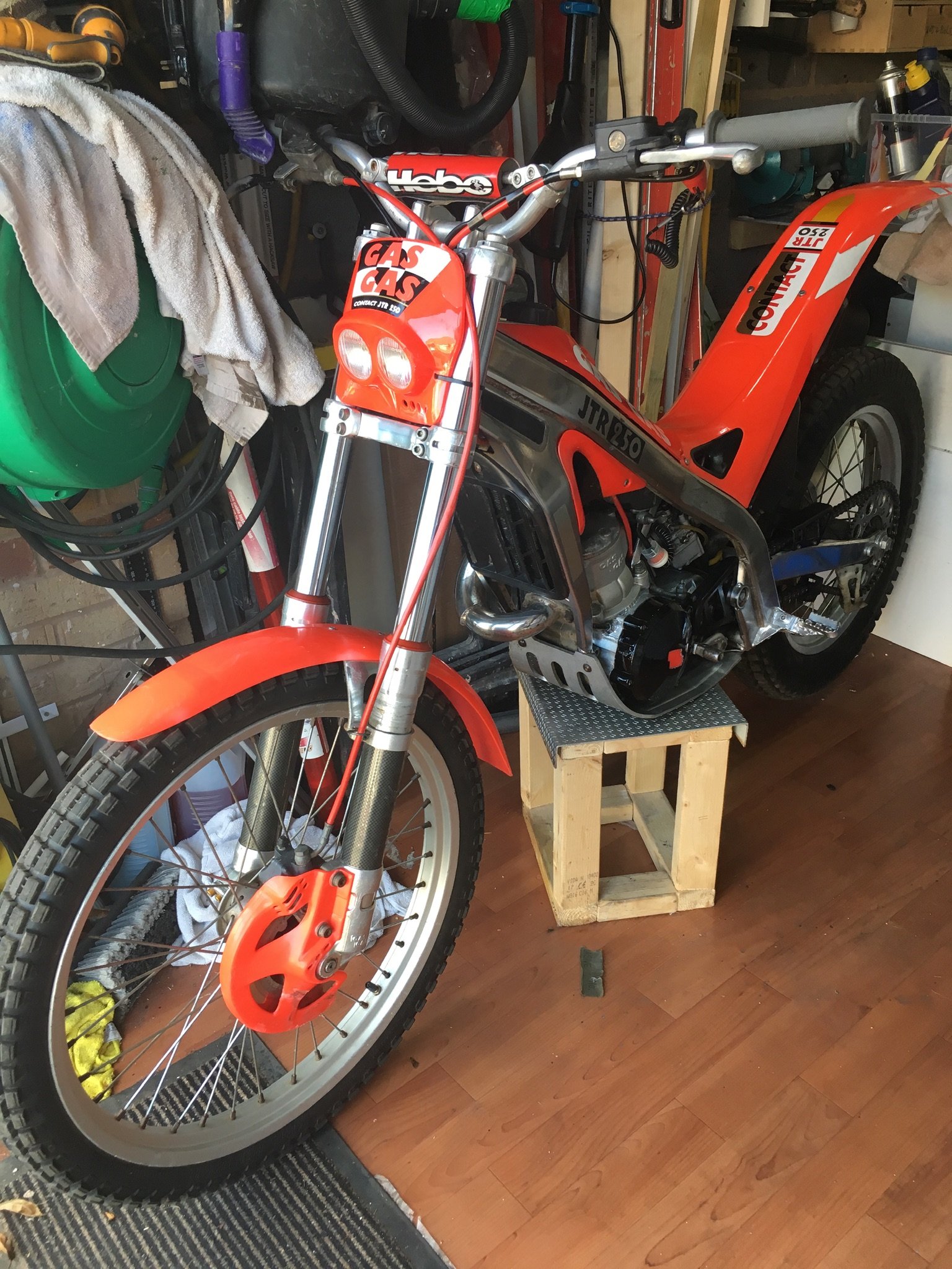

Dragontest Posted August 12, 2019 Report Share Posted August 12, 2019 Your bike looks nice. Mines a bit tatty as a 17 year old had it before and didn't have a clue on looking after it. It's getting plenty of attention now though. These bikes are getting rare. A blast from the past. Quote Link to comment Share on other sites More sharing options...
Tilly60 Posted August 12, 2019 Author Report Share Posted August 12, 2019 Mines 23 yrs old but been well looked after, your right hopefully collectors items in time Quote Link to comment Share on other sites More sharing options...
