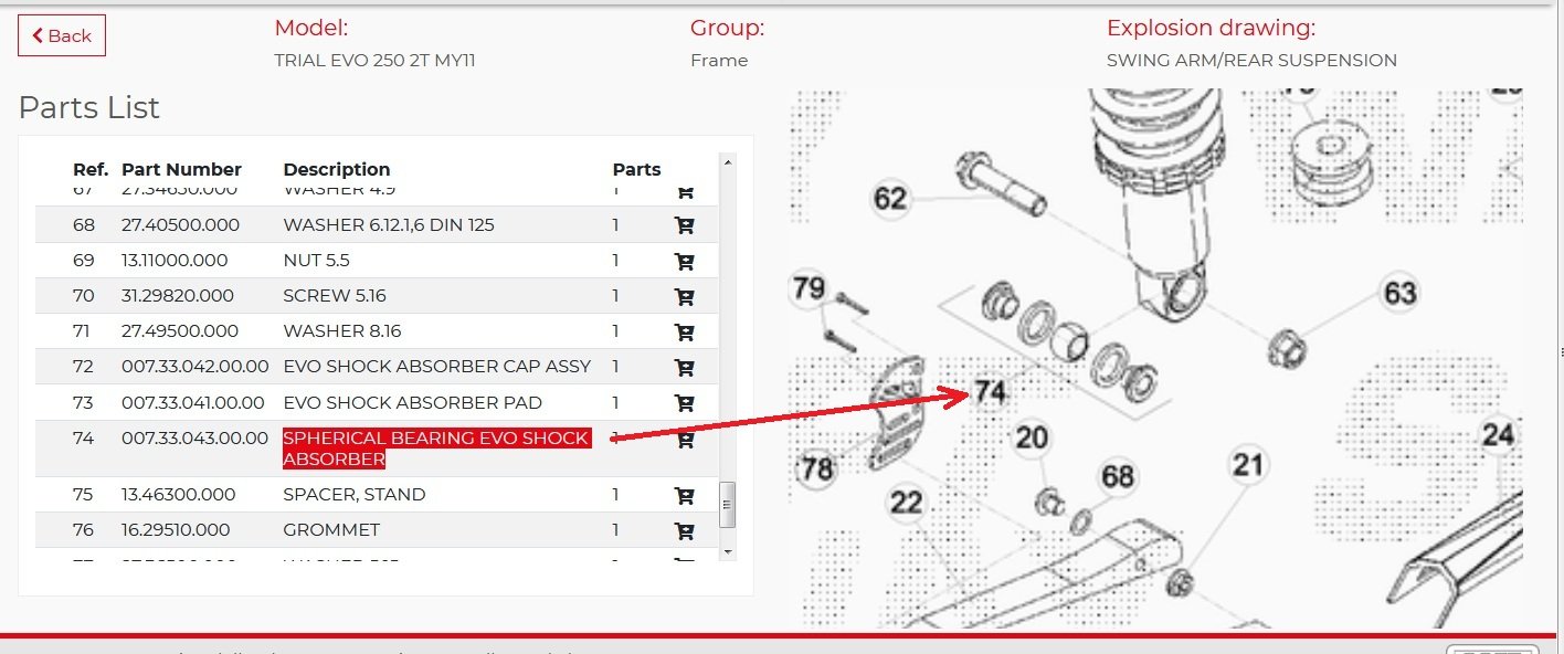

Hi all, Does anyone know what size the Spherical Bearing is for the lower end of the shock to Linkage
Parts manual ( REF: 74 ) simply states Spherical Bearing   No sizes.

12x22x12 is the size but it is hard to find in the correct depth.  SKF ones are 7mm the ones you need are 10.5mm.  Splat has them for £20 and lists them with the Beta part number above.
