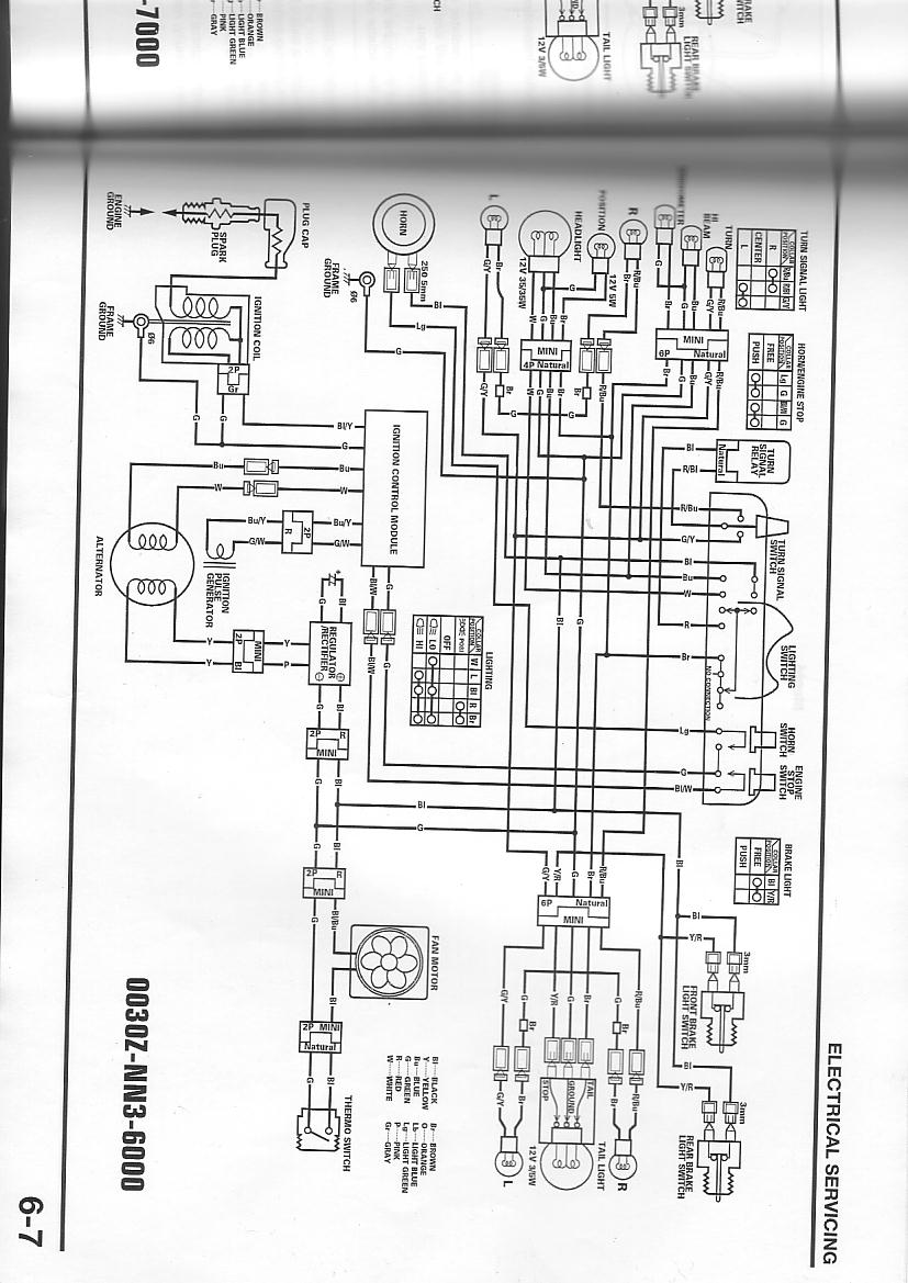

konrad Posted July 12, 2019 Report Share Posted July 12, 2019 Probably would not hurt to post a scan/photo/screenshot of your wiring diagram, as I am not familiar with that system. Quote Link to comment Share on other sites More sharing options...
Trialeovince Posted July 12, 2019 Author Report Share Posted July 12, 2019 On 7/12/2019 at 7:27 PM, lineaway said: You more likely have a corrosion problem, from sitting than anything else. So, yes trim the wire. Check the bolts. Does the stator have a ground wire? Not usually, it runs through the engine to the frame. Chances are all those bolts are chalk white on the threads. Expand Will defenitly check. On 7/12/2019 at 8:47 PM, konrad said: Probably would not hurt to post a scan/photo/screenshot of your wiring diagram, as I am not familiar with that system. Expand Here it is: Original post:: https://www.trialscentral.com/forums/topic/4980-cota-315r-help-needed/ Quote Link to comment Share on other sites More sharing options...
konrad Posted July 12, 2019 Report Share Posted July 12, 2019 The two power coils in the alternator are "floating" so there's nothing to ground (therefore corrosion of the alternator cover bolts can't cause your problem). The G/W wire from the ignition pulse generator connecting internal to the CDI ground wire is not necessarily a problem (and would be unlikely to cause the intermittent symptoms you describe). Quote Link to comment Share on other sites More sharing options...
