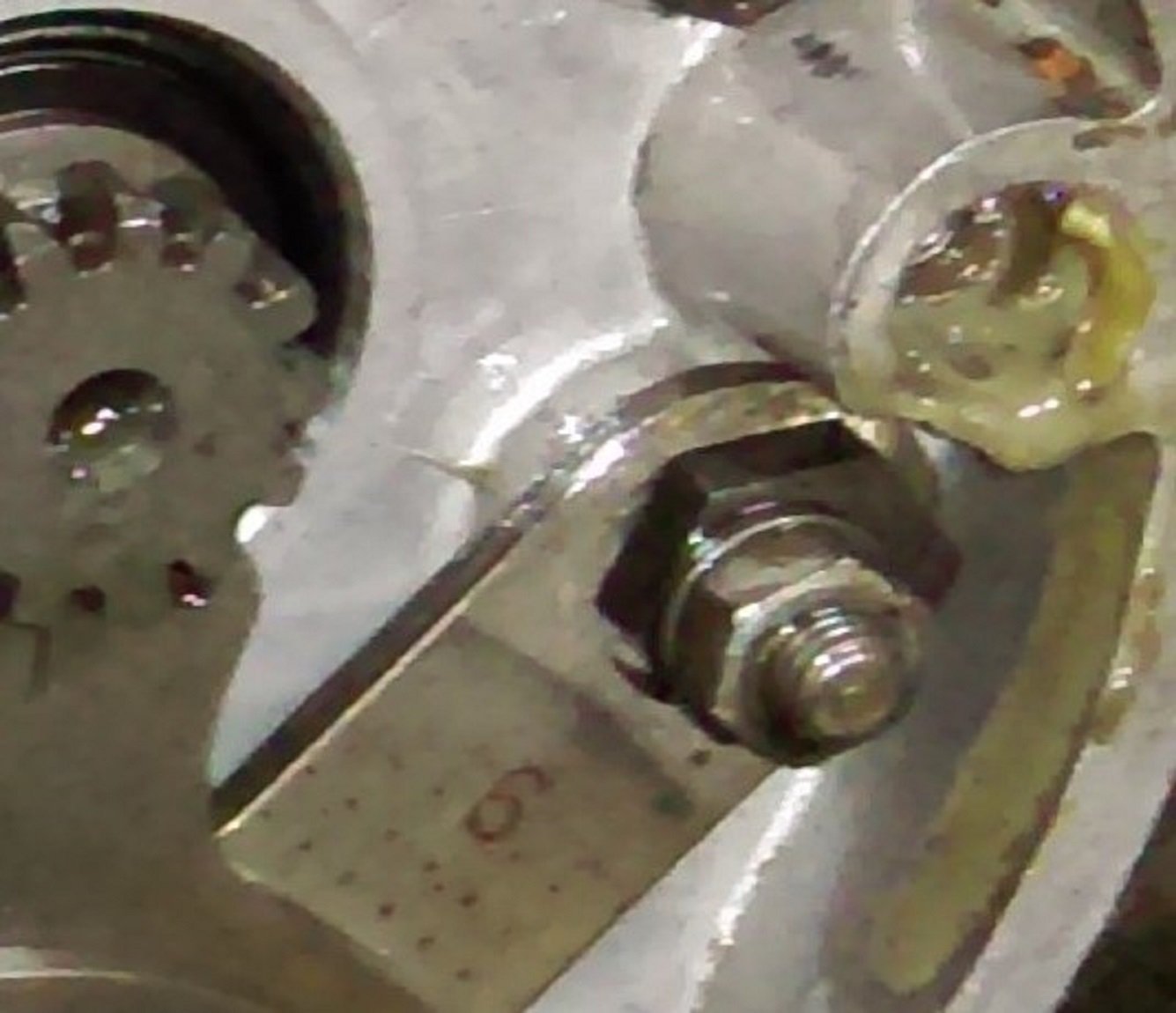

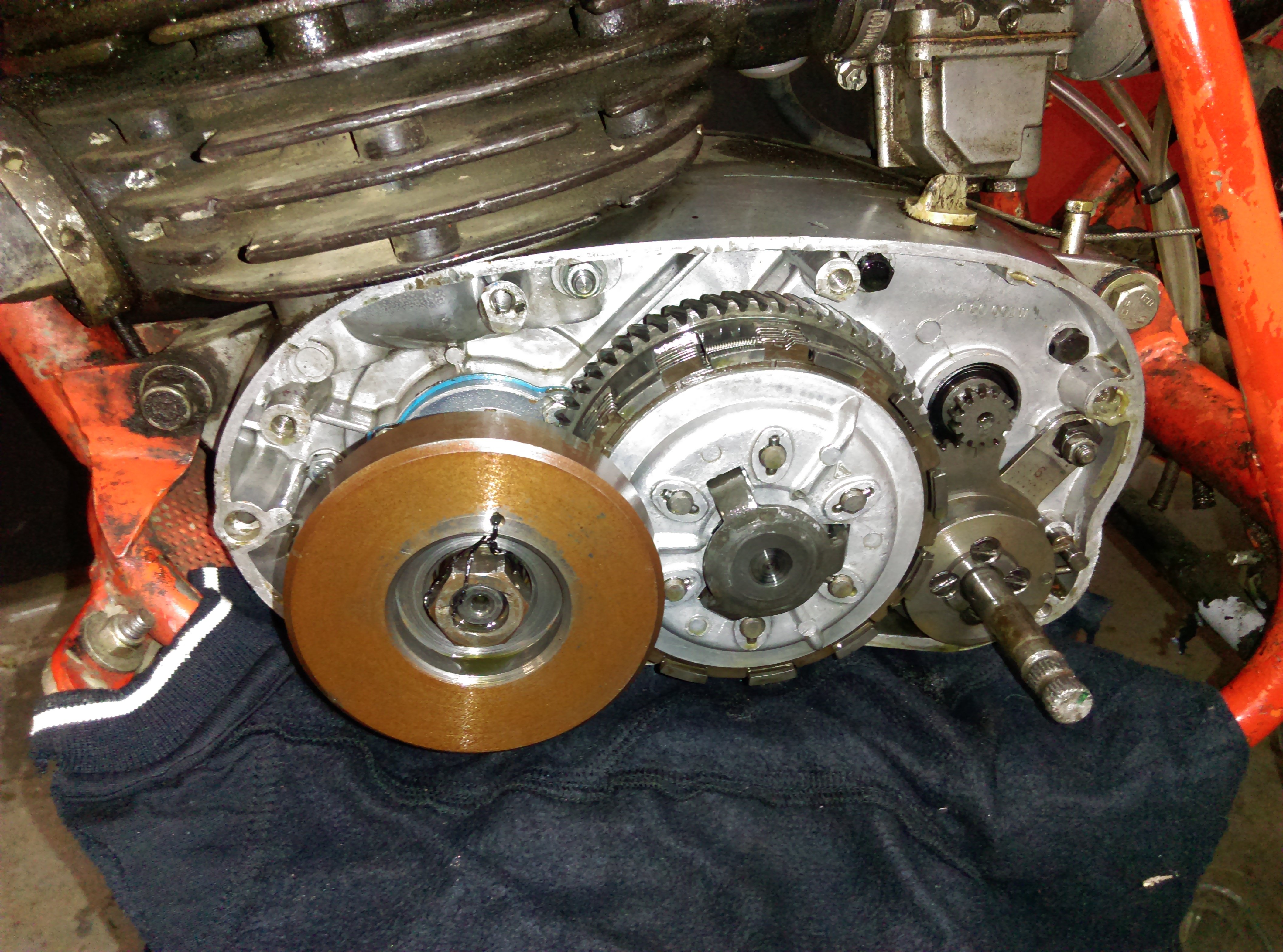

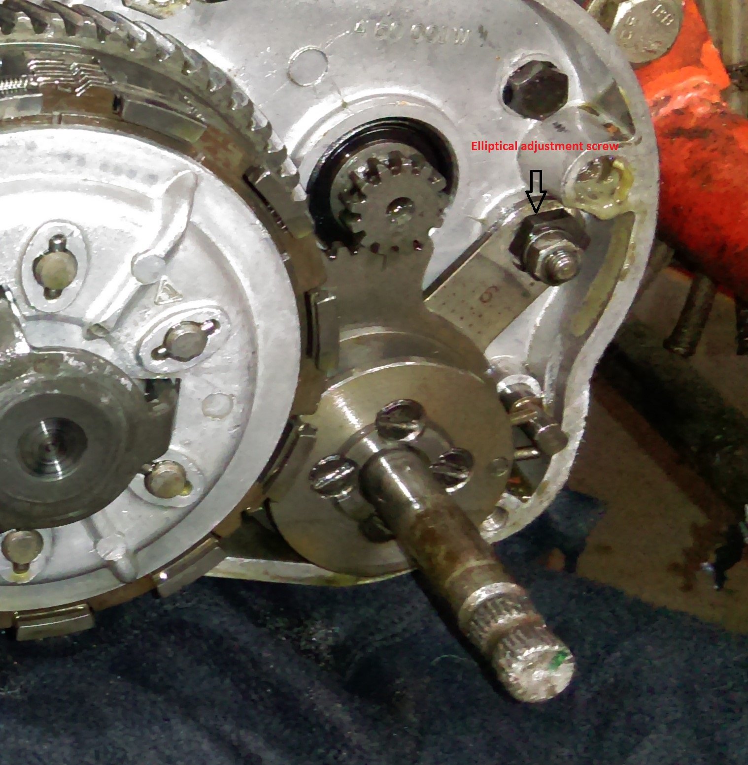

viva 1 Posted July 24, 2019 Report Share Posted July 24, 2019 Hi guys new here but been riding cotas since 1975 i have a cota 247 mk2 1975 and insidw the outer cover on the gear change side is an elliptical adjuster but i dont know how its supposed to be set can anyone help please much appreciated in advance Quote Link to comment Share on other sites More sharing options...
kingscorpion Posted July 24, 2019 Report Share Posted July 24, 2019 If it had a fixed position, it wouldn't need to have an elliptical screw. You have to find the proper position for you gearbox. In fact, there's no need to dissasemble the selector when you open the cases, but if you did it so, you'll have to make some tests with several positions until you find every gear is properly engaged when shifting upwards and downwards. Quote Link to comment Share on other sites More sharing options...
lineaway Posted July 24, 2019 Report Share Posted July 24, 2019 I cannot get a close enough view. Are you sure there is not a centering mark on both the cam and lever. Seems thier was on my 200. Quote Link to comment Share on other sites More sharing options...

brownie001 Posted July 31, 2019 Report Share Posted July 31, 2019 Hi, see the pdf I attached. Have fun, Phil Adjuster001.pdf Quote Link to comment Share on other sites More sharing options...
