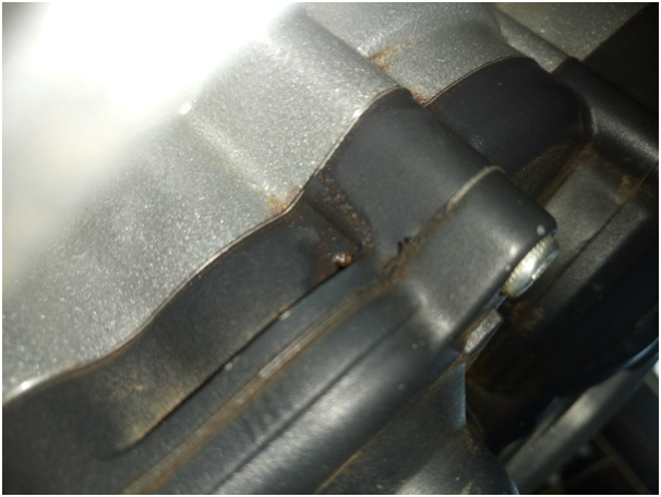

dwb5151 Posted July 25, 2019 Report Share Posted July 25, 2019 (edited) Hi my 2018 trs rr 300 is leaking coolant from this hole in the clutch casing, is there supposed to be a hole here. The casing was replaced under warrenty a few months ago with a 2019 part including the gasket. It only started doing this last night. Many thanks Edited July 25, 2019 by dwb5151 Quote Link to comment Share on other sites More sharing options...

baldilocks Posted July 25, 2019 Report Share Posted July 25, 2019 If it's the pin home on the underside of the water pump that means the seal has failed. The idea is you notice it weeping before it does too much damage. Drain the oil as soon as you can as the clutch plates may react with the coolant then you will need a new set Quote Link to comment Share on other sites More sharing options...

the dabster Posted July 25, 2019 Report Share Posted July 25, 2019 As baldilocks has said the TRS pump is designed to let the fluid exit rather than enter the gear oil when the seal fails. Coolant can react with the plates and ruin the clutch also. I've experience both things. Quote Link to comment Share on other sites More sharing options...

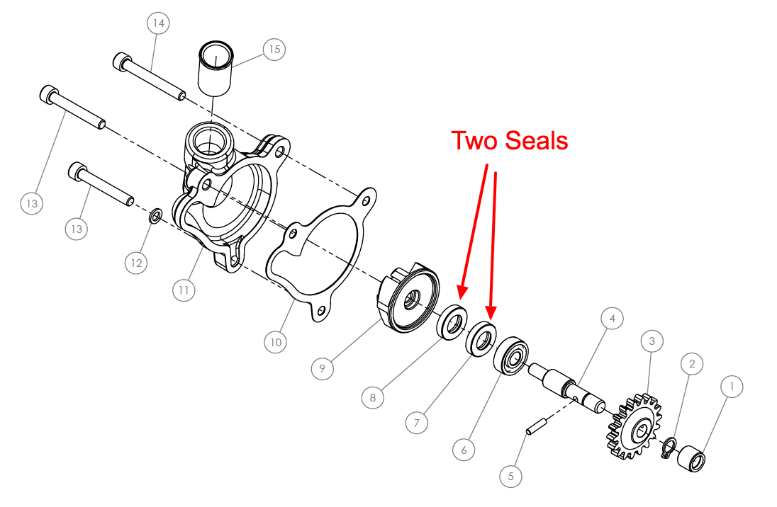

arnoux Posted July 25, 2019 Report Share Posted July 25, 2019 (edited) There is TWO seals. One to seal the coolant from exiting the pump, and the other on the shaft to seal the oil in the case and not contaminate the coolant. Both same size but different part numbers as one is NBR and the other Viton. In the little cavity between the two seals is a small hole that exits just below the water pump. (7 o'clock if you are looking straight at it). This allows coolant or oil to exit if either seal is compromised. As there is no "expansion tank" in the coolant system, I have found if you fill the radiator all the way to the top this can happen. The pressure relief valve on the top of the radiator sometimes gets a bit crusty or blocked a little and won't blow off completely, so the only other way for the system to relieve pressure is blowing past the WP seal and out that little hole. Before changinging seals make sure your coolant level is not right up to the top (I leave about 8 -10 mm gap - about half way up the top tank above the fins) and get that little pressure relief valve out and give it a good clean up. It may be OK. Edited July 27, 2019 by arnoux 6 Quote Link to comment Share on other sites More sharing options...

lineaway Posted July 26, 2019 Report Share Posted July 26, 2019 (edited) I would just change it again. Almost all the time it comes out the weep hole when the seals are bad. Not a bad idea to keep a spare outside seal. Which can be changed without taking the bike further apart. By the way the above diagram is incorrect. You need to look at the 2018 RR parts book. The seals are on the outside of the gear. Edited July 26, 2019 by lineaway 2 Quote Link to comment Share on other sites More sharing options...
