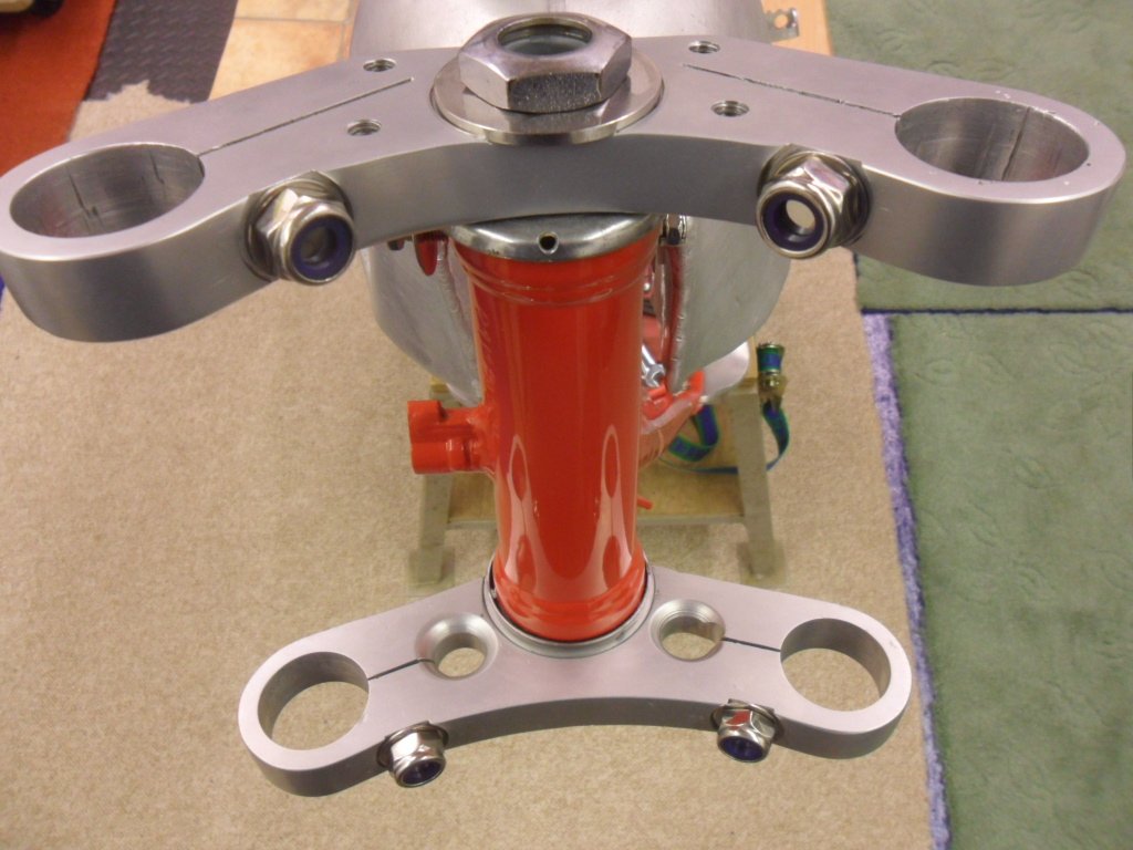

dr nosh Posted August 13, 2019 Report Share Posted August 13, 2019 Well that's a surprise. Rolled plate. I wonder why ? Picture of my yokes during assembly. Quote Link to comment Share on other sites More sharing options...
