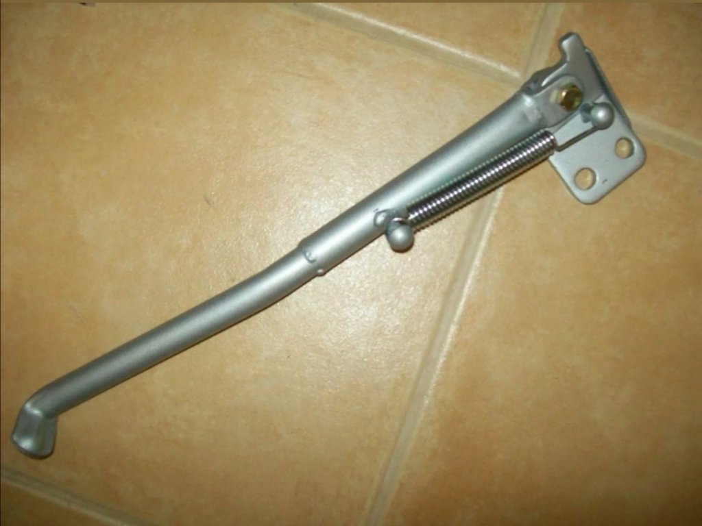

Dragontest Posted August 14, 2019 Report Share Posted August 14, 2019 I'm new to trials bikes. Can anyone help. So I've just bought a universal side stand where would be the correct place to fix it on my GasGas JT25 1995 bike. Swinging arm or on the frame? Quote Link to comment Share on other sites More sharing options...
pjw123 Posted August 14, 2019 Report Share Posted August 14, 2019 You need to fit it to the swing arm. There should be captive nuts there. Doesn't look like a GG stand though. Quote Link to comment Share on other sites More sharing options...
Dragontest Posted August 16, 2019 Author Report Share Posted August 16, 2019 On 8/14/2019 at 4:50 PM, pjw123 said: You need to fit it to the swing arm. There should be captive nuts there. Doesn't look like a GG stand though. Expand No I couldn't find one on eBay for sale but found this universal one, hopefully it will do the job, I got fed up with the bike falling over, when others just put a side stand down. Quote Link to comment Share on other sites More sharing options...

trapezeartist Posted August 18, 2019 Report Share Posted August 18, 2019 (edited) On 8/17/2019 at 5:05 PM, d2w said: Or what about getting the OEM stand from someplace like Trials Bike Breaker? They're even on your side of the pond. Expand Seems like a good plan. But if you want to use the one you’ve bought, you’ll have to cut out and drill a bracket to attach it to, then carefully work out and mark the exact position where it needs to go, then get someone to weld it on. Then clean up and paint. Edited August 18, 2019 by trapezeartist Quote Link to comment Share on other sites More sharing options...
doctorchopper Posted August 21, 2019 Report Share Posted August 21, 2019 side stand on the gas gas fits to the right side, that stand looks like its for the left side Quote Link to comment Share on other sites More sharing options...
Dragontest Posted August 23, 2019 Author Report Share Posted August 23, 2019 On 8/21/2019 at 8:12 AM, doctorchopper said: side stand on the gas gas fits to the right side, that stand looks like its for the left side Expand Yep I bought for the wrong side such a Muppet I know. Quote Link to comment Share on other sites More sharing options...
