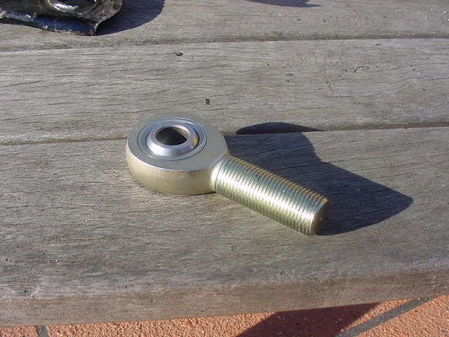

chris Posted January 20, 2006 Report Share Posted January 20, 2006 You might need the rose joint for the top and bottom of the shock aswell. Sorry don't know the sizes without looking. Quote Link to comment Share on other sites More sharing options...
charliechitlins Posted January 21, 2006 Report Share Posted January 21, 2006 What's a rose joint? Quote Link to comment Share on other sites More sharing options...
copemech Posted January 21, 2006 Report Share Posted January 21, 2006 Must belike a Heim joint(politically corrected)! Go Figure! Quote Link to comment Share on other sites More sharing options...
bikespace Posted January 21, 2006 Report Share Posted January 21, 2006 Not sure it is a rose joint? Apparently this is a rose joint, also called a rod end: seen in action here, right in the middle OK for nipping down to the shops eh? Quote Link to comment Share on other sites More sharing options...
chris Posted January 21, 2006 Report Share Posted January 21, 2006 Alright then a Spherical plain bearing to be correct. Also know as a rose joint, ball joint, rod end bearing and apparantly a heim joint. Cheers Chris Quote Link to comment Share on other sites More sharing options...
bikespace Posted January 21, 2006 Report Share Posted January 21, 2006 Whatever the bearings are called for the top and bottom of the suspension, I couldn't find an exact match for them t a bearing supplier. I've put a couple in mine that are right apart from the width (a little too narrow). Work fine but I'd rather the real thing if anybody manages to get the number for them. Bit of a rip off for the real thing - don't remember how much I was quoted, but the ones from Bearing Man were that cheap my mate gave me them. Quote Link to comment Share on other sites More sharing options...
chris Posted January 22, 2006 Report Share Posted January 22, 2006 I think they must be a special size as they are even listed on the SKF website, they do some similar but like the one you have i.e. a bit thinner 10mm instead of 12mm. The proper ones do come with new seals and bushes I think. Quote Link to comment Share on other sites More sharing options...
