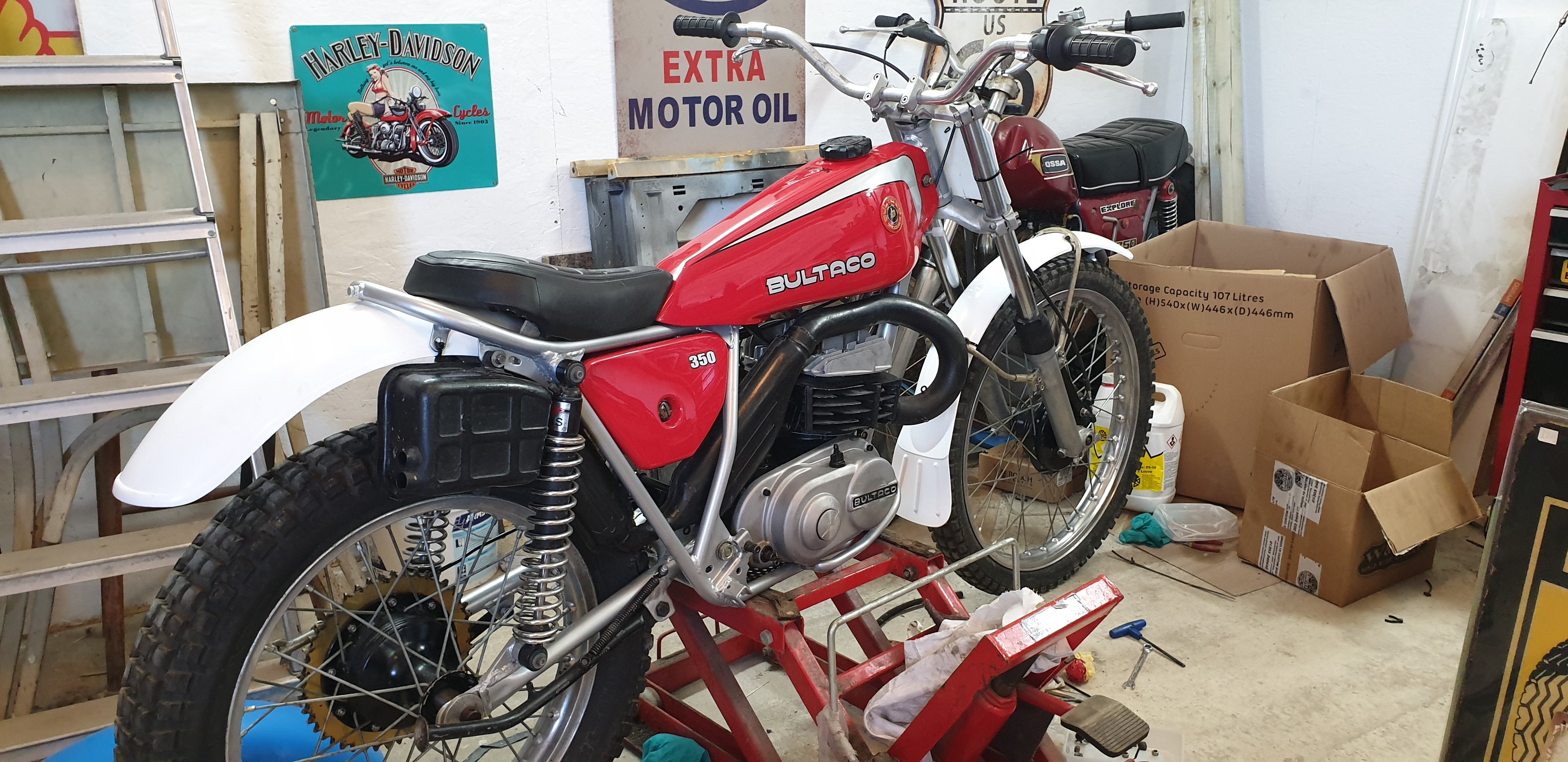

WJSmith Posted August 31, 2019 Report Share Posted August 31, 2019 I am in the process of putting my sherpa back together. I have fitted the fuel tank (aluminium) with the long mounting bolt through the front, but am a bit lost at the back of the tank. Is it just the seat that holds these tanks in place? Or is there a strap of some sort that holds it? Thanks in advance Quote Link to comment Share on other sites More sharing options...

WJSmith Posted August 31, 2019 Author Report Share Posted August 31, 2019 Ok people thanks for the advice. The tank has the proper grommets with sleeves fitted to prevent the issue with the front bolt. Here it is at the moment ? 1 1 Quote Link to comment Share on other sites More sharing options...
