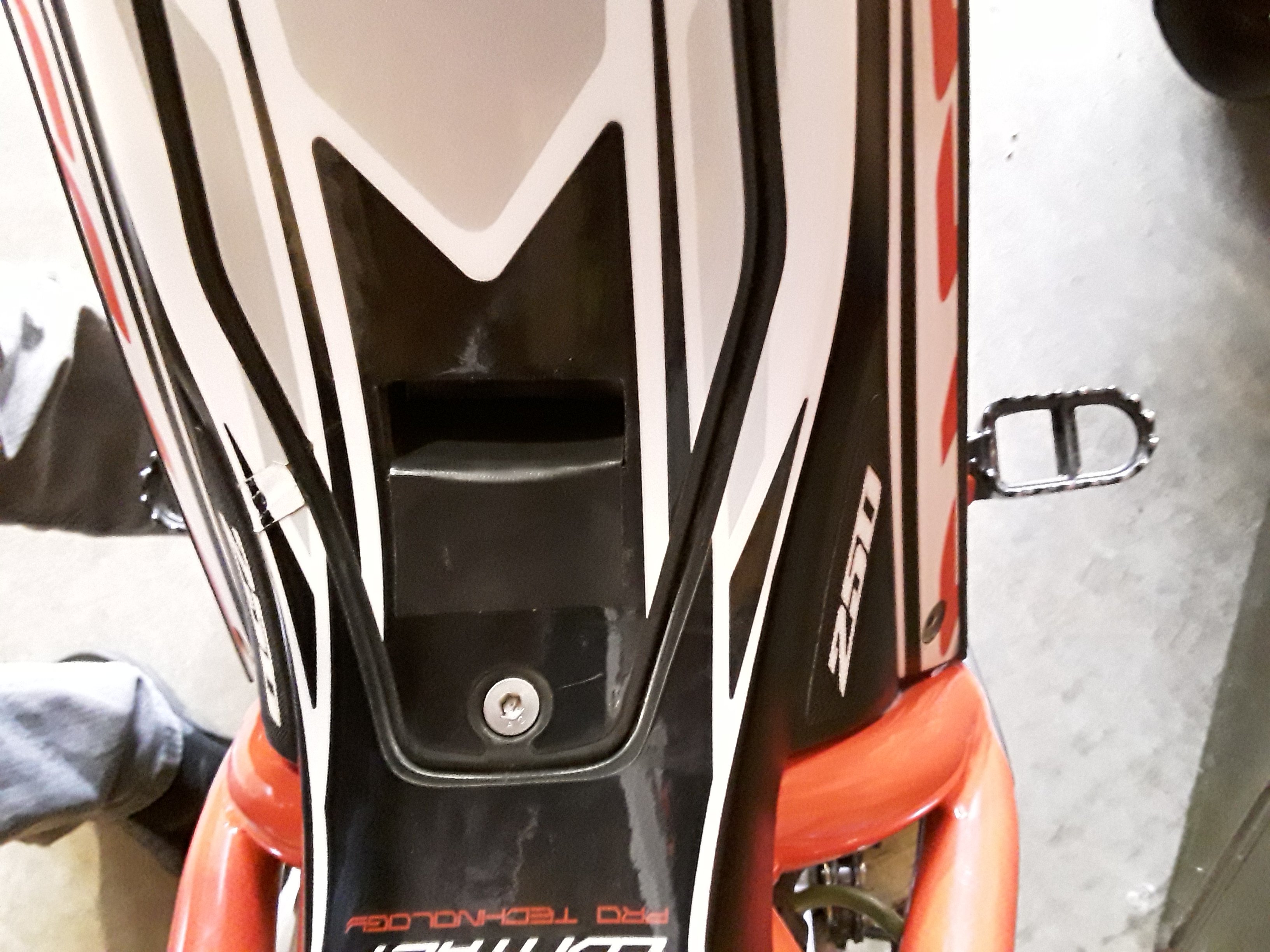

sherco70 Posted September 3, 2019 Report Share Posted September 3, 2019 Gets real dusty, here in the riding area, and my 2017 Gasgas seems to get a lot of the fine dust into the airbox. I blocked off the intake from the front, and cut an opening in the top lid, and made a baffle under the hole. So far it is reducing the amount of dust that enters the airbox. Art Quote Link to comment Share on other sites More sharing options...

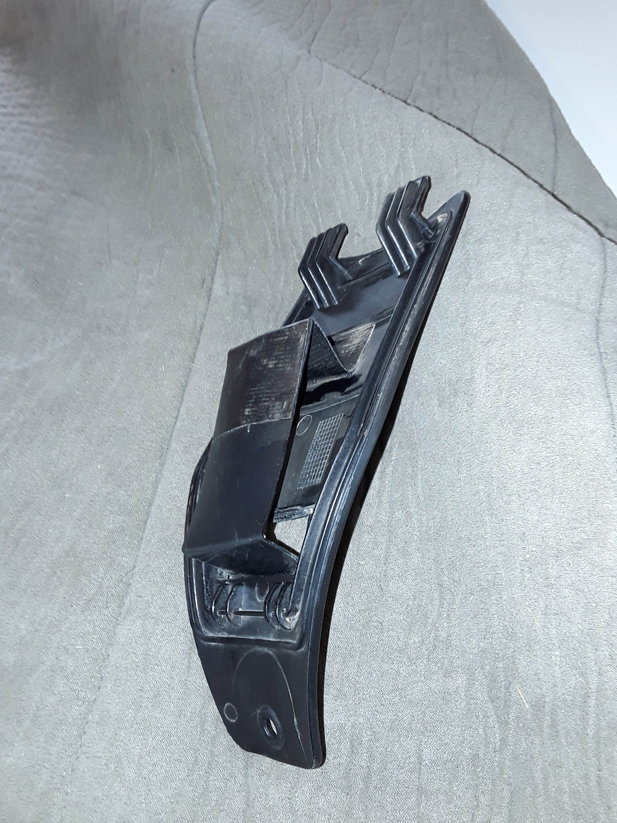

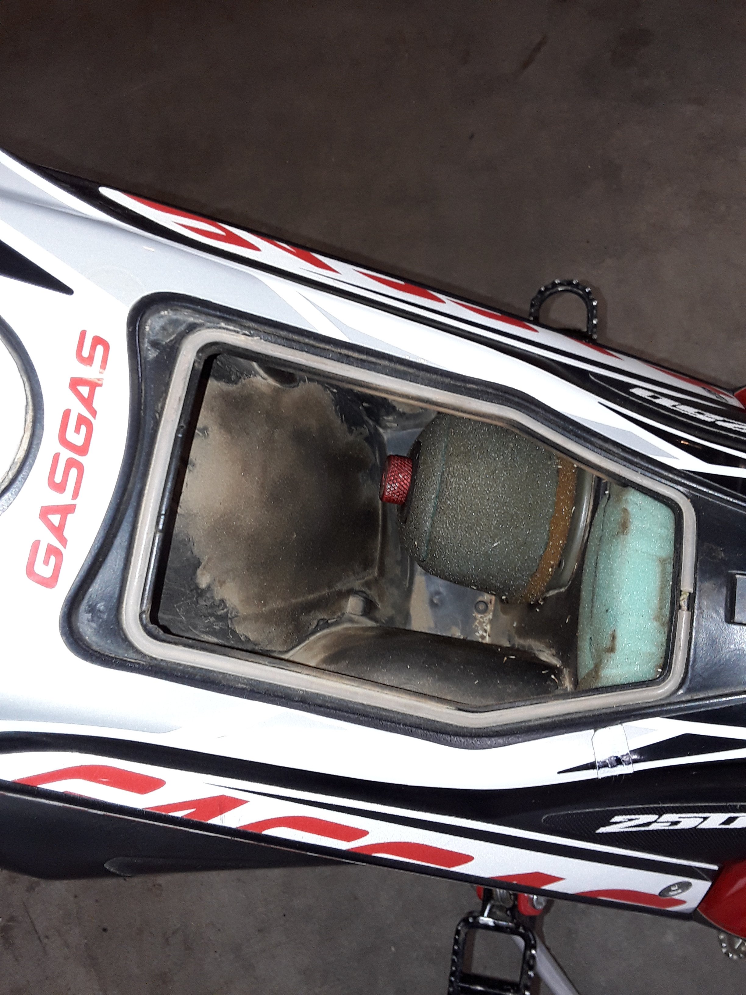

sherco70 Posted September 5, 2019 Author Report Share Posted September 5, 2019 Quote Link to comment Share on other sites More sharing options...
sherco70 Posted September 5, 2019 Author Report Share Posted September 5, 2019 (edited) The opening I cut is in the black of the decal and not noticeable. The baffle under the hole is a simple piece of plastic, taped in place. The front opening to the airbox, is blocked with some filter foam, I had , and oiled some. Still the intake gets it's share of dusty air, but seems to go longer between filter cleaning. It's a little faster to check the filter now. Art Edited September 5, 2019 by sherco70 Quote Link to comment Share on other sites More sharing options...

2stroke4stroke Posted September 6, 2019 Report Share Posted September 6, 2019 It looks like you are not taking the normal precaution of applying grease to the walls of the airbox to trap dust? Quote Link to comment Share on other sites More sharing options...
huski Posted September 6, 2019 Report Share Posted September 6, 2019 It helps if you split the 2 halves of the air box and seal it with Stikaflex available from motor factors,a lot of c--p comes in through the unsealed from factory joint Quote Link to comment Share on other sites More sharing options...
