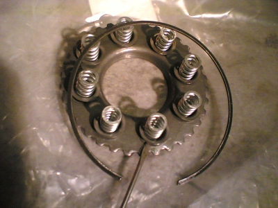

Ok...so I should have asked first... :closedeyes:
I have the clutch cover off and was hoping to see the clutch springs held down by screw....but there is a plate with spring covers/retainers. The plate is held by a large ring that is very snug in against the basket.
What next?
Ease the ring out and watch the clutch fly apart?
Get a magic tool that does it for me? (Seems like the plate is forced against the ring by the springs and therefore the clutch would need to be pressed in to allot eh removal of the ring)
Help pleeeeezzzz...not seen this type before

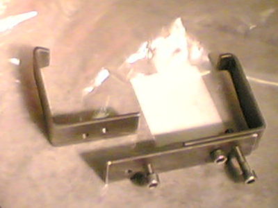

Hi, Well I ended up building my own clutch compressor tool to get around the problem of trying to release the retaining ring...
Took about two hours or so of measuring, cutting, bending, drilling, tapping, assembly.....and about 1 minute to dismantle the clutch!!!
