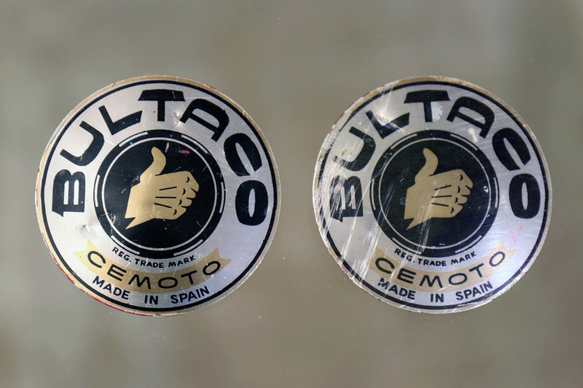

My Model 27 Sherpa has metal tank badges fitted. I have just removed them to repair and paint the tank, and would like to fit new metal badges.
I am sure I previously found someone selling new metal badges on the web, but have been unable to find them again. All the sites I checked just have the vinyl adhesive badges.
Is anyone able to point me in the right direction to someone who sells the metal badges?
Mine are pictured below.

Hi Peter. I look around on the internet a lot for Bultaco trials stuff and I have never seen any metal tank badges for sale. I didn`t even know the M27`s had metal badges. I resprayed an M49 a few months ago and it had plastic ones on it. I don`t know if they were original or not but they look correct. Good luck. Graham.
  • Like 1
Link to comment
Graham,
Thanks for the reply. Looks like the aluminium badges were only on the early Bultacos. My M27 has them fitted but an M49 uses the resin ones.
I now have identified two sources for the aluminium badges. If others are looking for them these are:
www.recambiousado.com
www.motosdelabuelo.com
There may be other sellers.
Regards,
Peter.

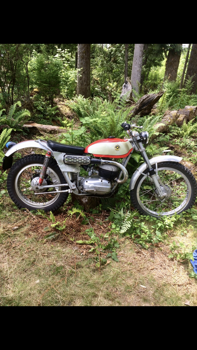

Hi,
yes my M27 is all running and never touched since it left the factory.

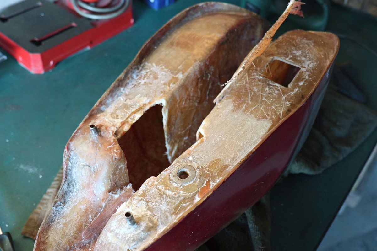

Focus at the moment is repairing the tank which had part of the tunnel removed, plus a couple of extra holes cut in the bottom. These were then patched with aluminium and a resin that is not compatible with the original. At present I am cutting and peeling the repair layers off to get back to the original tank.

That's a real mess Peter, good luck with fixing the tank. I've only ever needed to deal with metal tanks so I'll be interested to see how you get on
Have you ever worked with fibreglass before? I'm about to have my first go at doing a fibreglass repair on the inner guard/airbox on the CZ sidepipe mx bike I'm restoring at the moment, I'm glad it's only rebuilding 1 of the mounting sections rather than being cosmetic or sealing a tank like you're doing
  • Like 1
Link to comment
Hi Tony,
I have no experience with repairing fibreglass but am getting advice from someone who works with it every day.
What I have learnt so far is that there are a number of different epoxies and polyesters.
On my tank the wrong filler has been used which means it hasn't cured properly, resulting in the tank leaking.
The previous owner fixed this by adding more filler until the tank no longer fitted over the frame tube.
Luckily the incompatible filler softens (and the original fibreglass doesn't) by using a heat gun so first task is cutting and peeling the repairs off.
