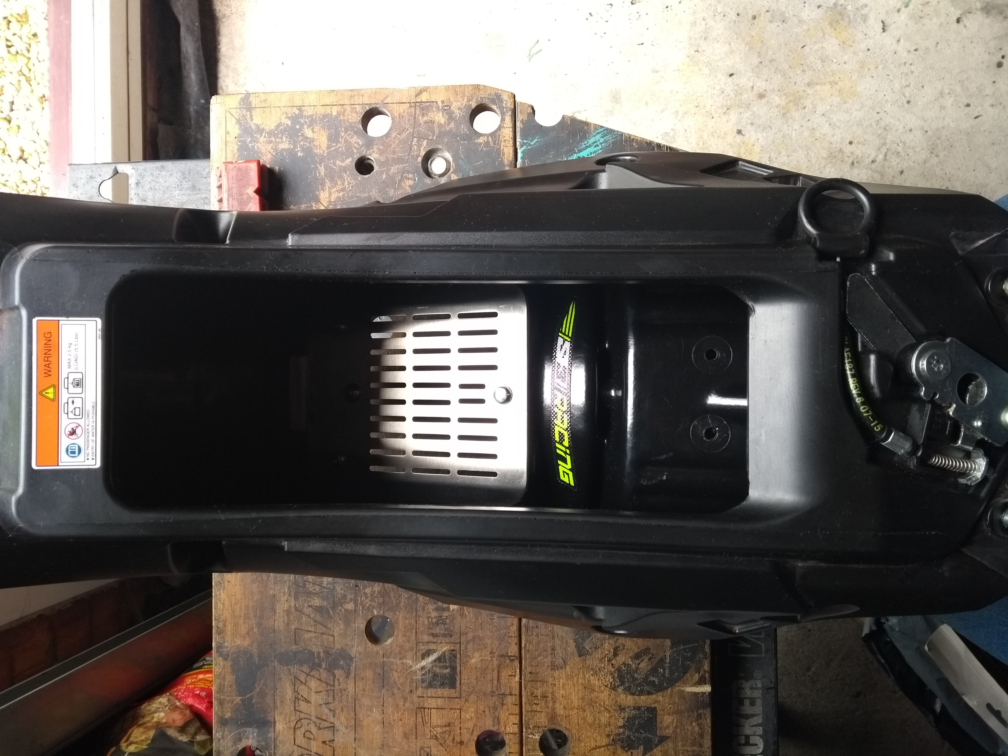

riffraffretro Posted October 21, 2019 Report Share Posted October 21, 2019 (edited) After realising that regular disassembly of the majority of the 4-Ride's rear end simply to check/clean/replace the air filter was a bridge too far, I opted for the S3 access flap kit... fitted today. After careful cutting of the airbox using the supplied template, everything came together nicely; the kit provides adequate access to the filter, with only removal of the seat required and looks well thought through and engineered. IMO, well worth the £59.99 outlay to facilitate air filter changes in minutes, as opposed to hours. Can't recommend enough. Edited October 21, 2019 by riffraffretro 4 Quote Link to comment Share on other sites More sharing options...
