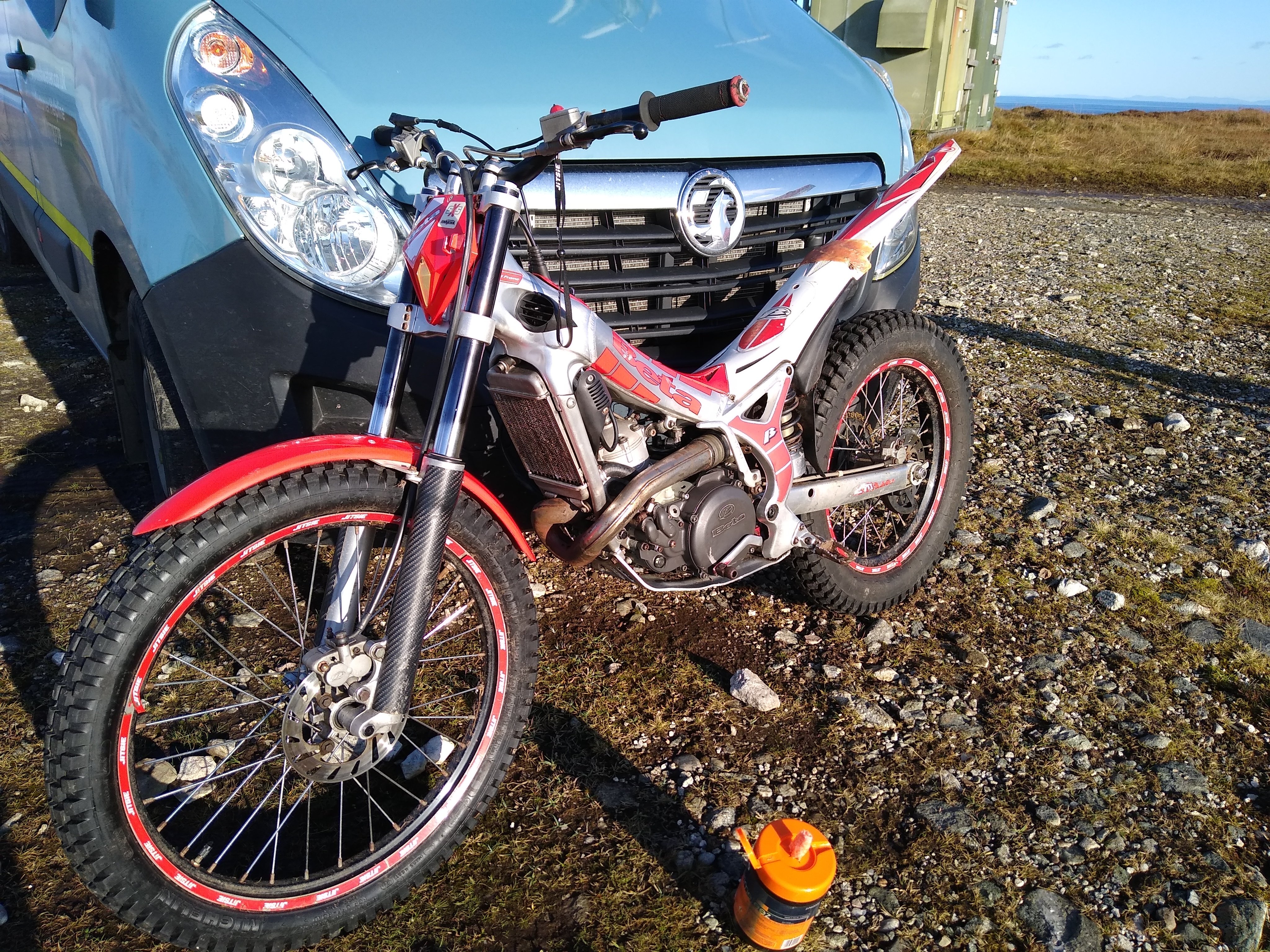

Crazymac680 Posted November 5, 2019 Report Share Posted November 5, 2019 I've just done a full rebuild and about 8 hours riding. I'm pretty sure it's been making the sound since the rebuild. When the clutch lever is pulled the engine sounds normal. As I release and the bike starts to pull I hear a whirring. It sounds a bit like an electric motor. Which increases in pitch according to the revs. I'm using putoline gear oil. Or could it be the clutch release bearing? Oil type? Thanks for any advice Quote Link to comment Share on other sites More sharing options...
