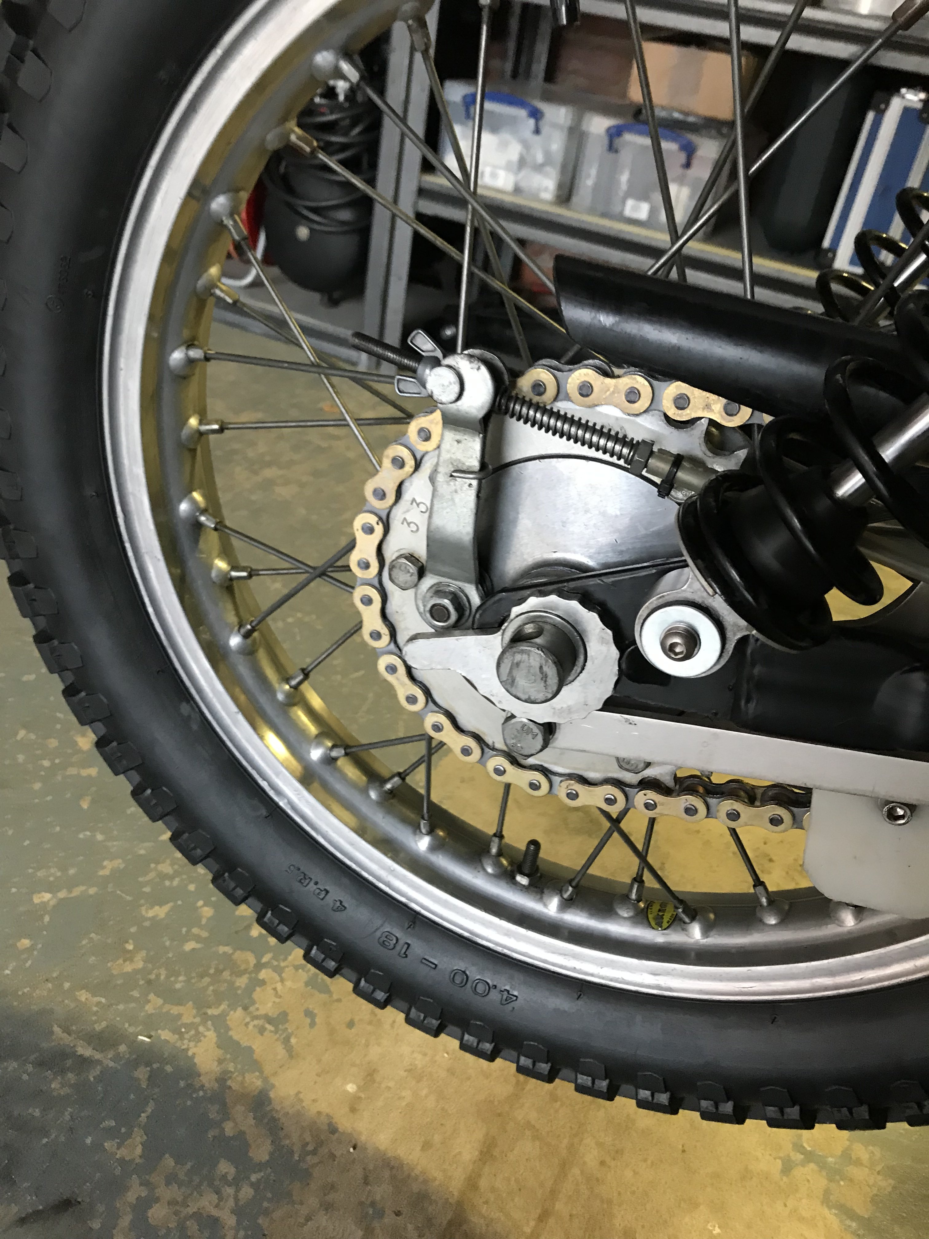

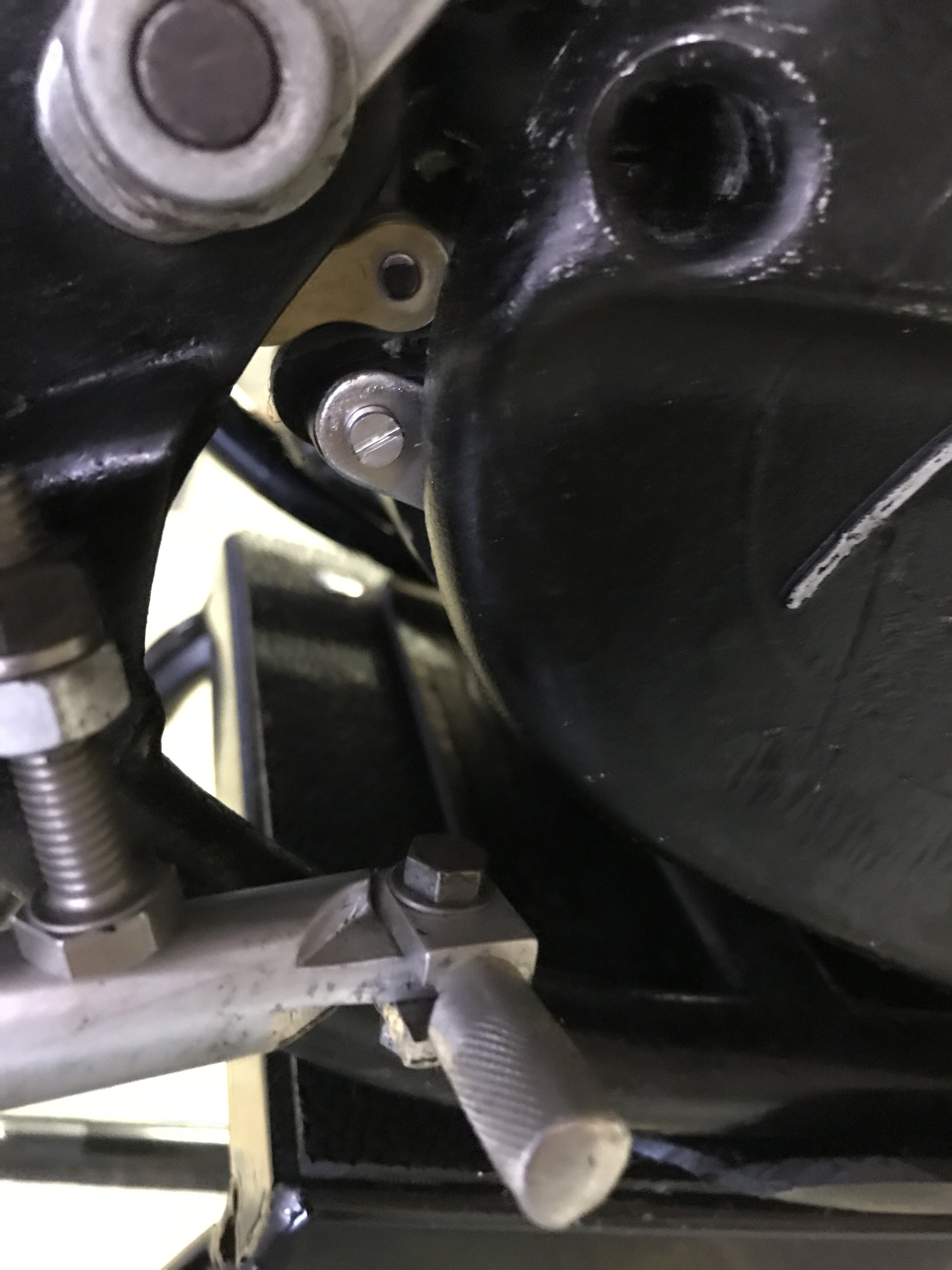

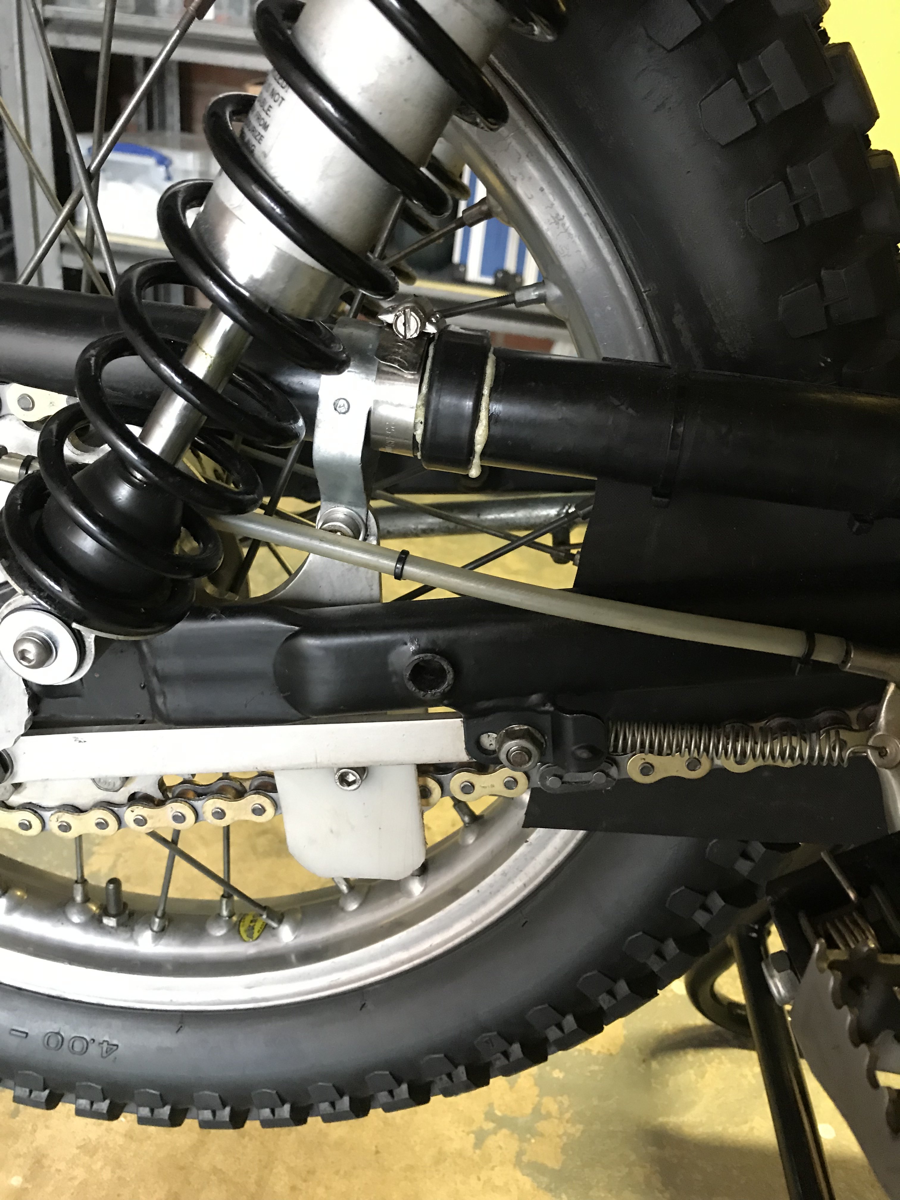

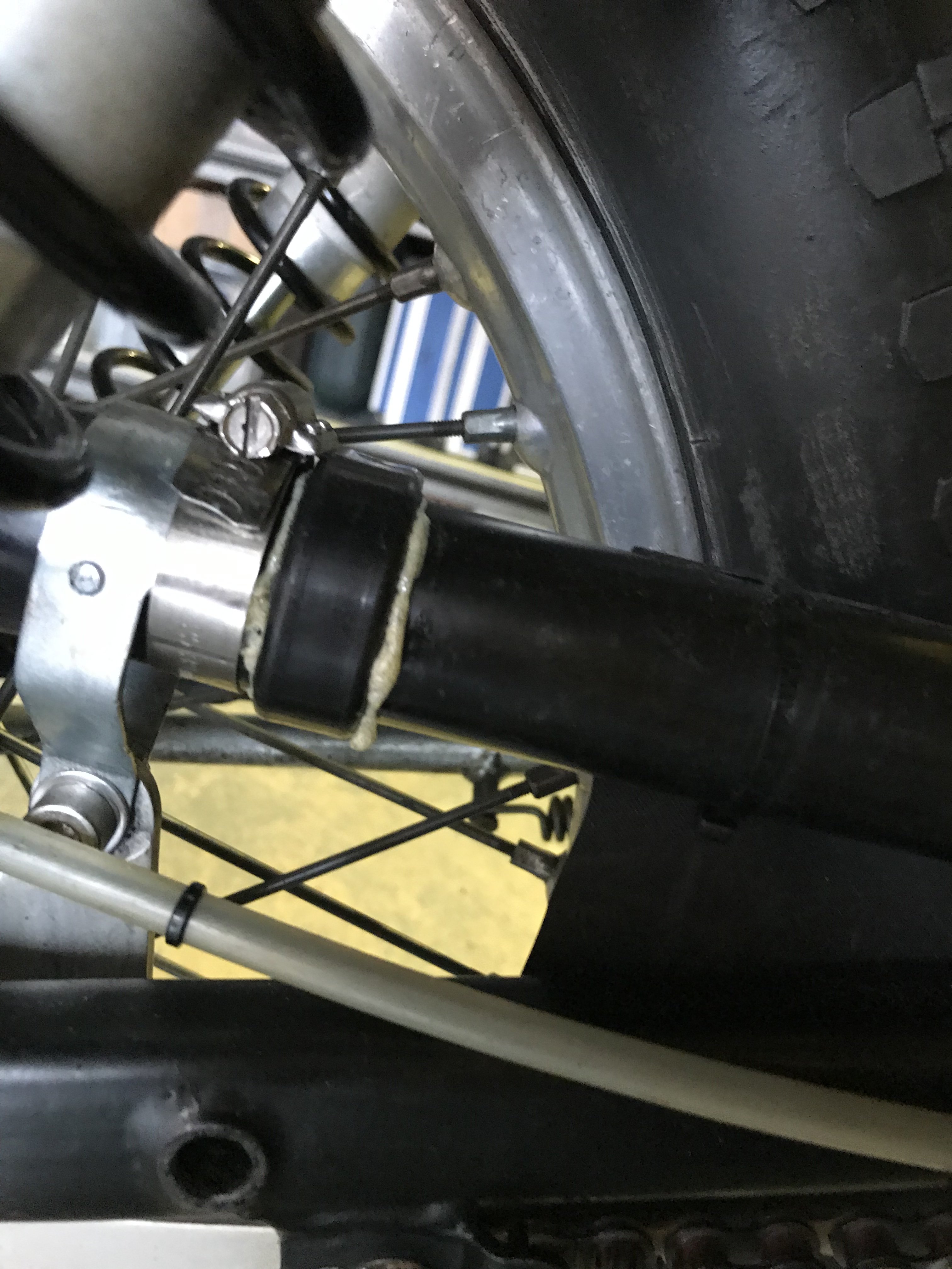

section swept Posted November 20, 2019 Report Share Posted November 20, 2019 Just thought I’d show you my version of a chain guard for the Montesa 348. Didn’t like the idea of paying upwards of £50 ish for something that might get wiped out in a section. There is a chain tensioner courtesy of In Motion nestling next to the gearbox sprocket, the upper chain run is protected by black water pipe ( cheap to replace if it breaks) the lower chain run is protected by thin pond liner sheet, this deflects falling crap from the tyre. There is also a lower chain guide made from bullet proof nylon (well the guy who gave me the plastic said it was ballistic grade). Hope you like. Any exposed glue (Gorilla) has now been carefully removed...it was just a belt and braces finishing touch. You will probably notice I have used the original Montesa chain guard swinging plate 1 1 Quote Link to comment Share on other sites More sharing options...
