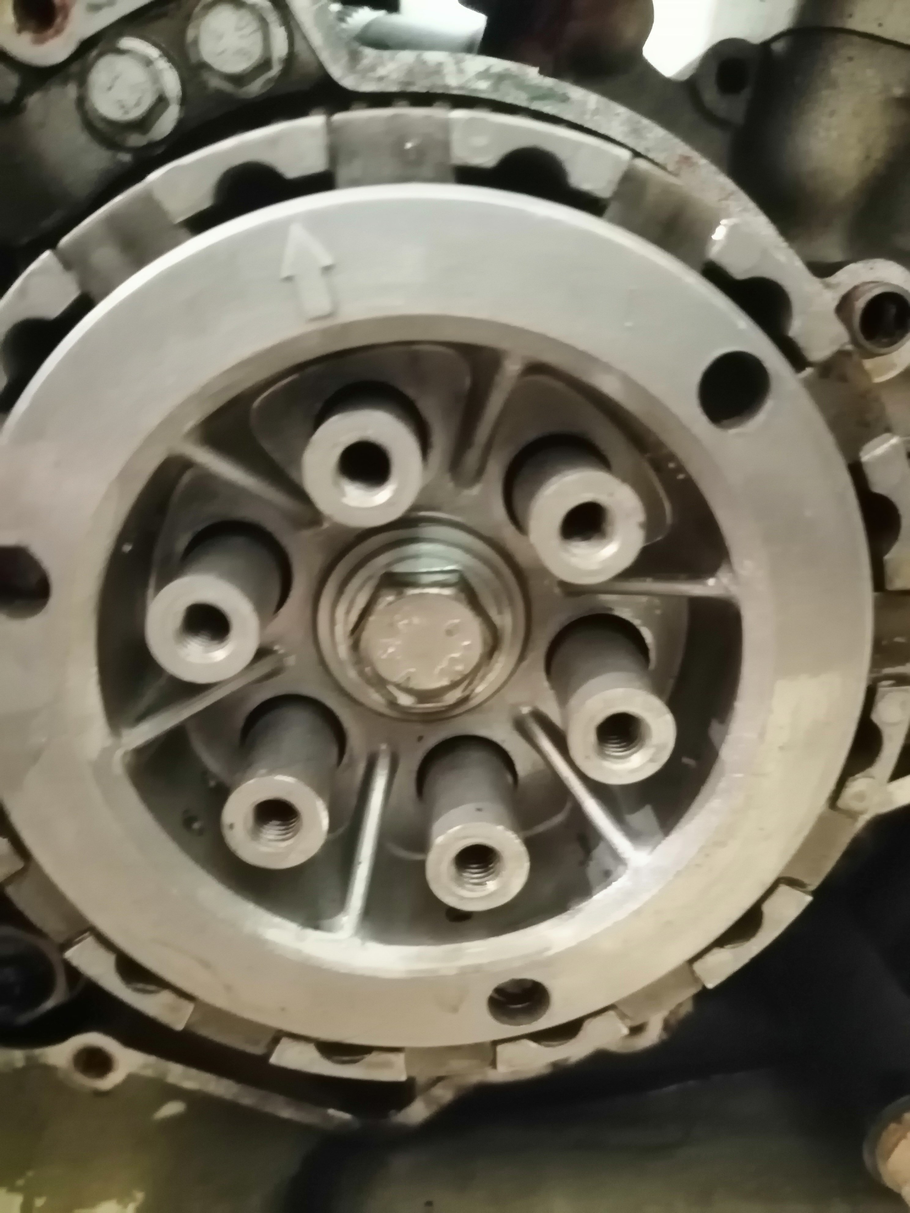

mad_as_u_like Posted November 24, 2019 Report Share Posted November 24, 2019 Hi my sons 80 has been stood for a year and the plates have stuck. I've freed them but they've gone sticky and keep sticking back together so need a clean. Can anyone tell me how to get this bolt out so I can remove the clutch plates. The bolt is just turning. Thanks Quote Link to comment Share on other sites More sharing options...

mad_as_u_like Posted November 25, 2019 Author Report Share Posted November 25, 2019 Hey Bilko that's how I secured it to remove the first lot bolts lol. The basket isn't turning but the nut and plate(with arrow) are both turning. It's in gear but still spins Quote Link to comment Share on other sites More sharing options...

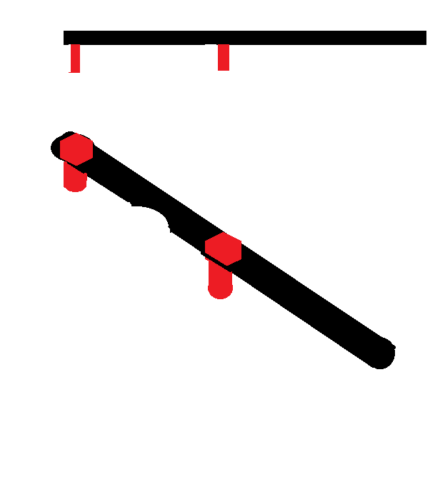

Bilko Posted November 25, 2019 Report Share Posted November 25, 2019 (edited) Can u fabricate something simular to pic even a straight bar with 2 studs across the top 2 holes to hold it Edited November 25, 2019 by Bilko Quote Link to comment Share on other sites More sharing options...
