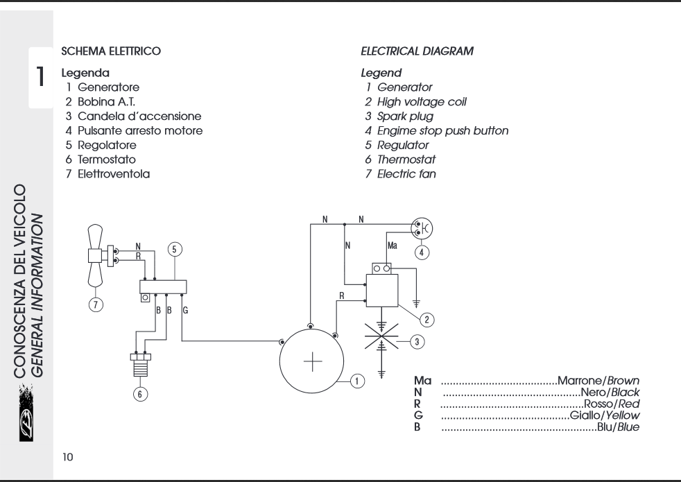

Hi people I’m in desperate help I have rebuilt a 2008 rev 50 for my son for Christmas I can start the bike first kick but it will not cut out using the lanyard kill switch can anyone take some pics of there wiring for me as I’m pretty desperate to get this working ASAP I’m not sure all connections are correct electrically
thanks

You can test to see if you have the lanyard switch wired correctly by doing the following. Disconnect the lanyard switch, hook up 2 wires to where the lanyard was hooked up. Now start the bike, once running short these 2 wires together, the bike should now stop running. If the bike does stop running there is something wrong will the lanyard switch.
