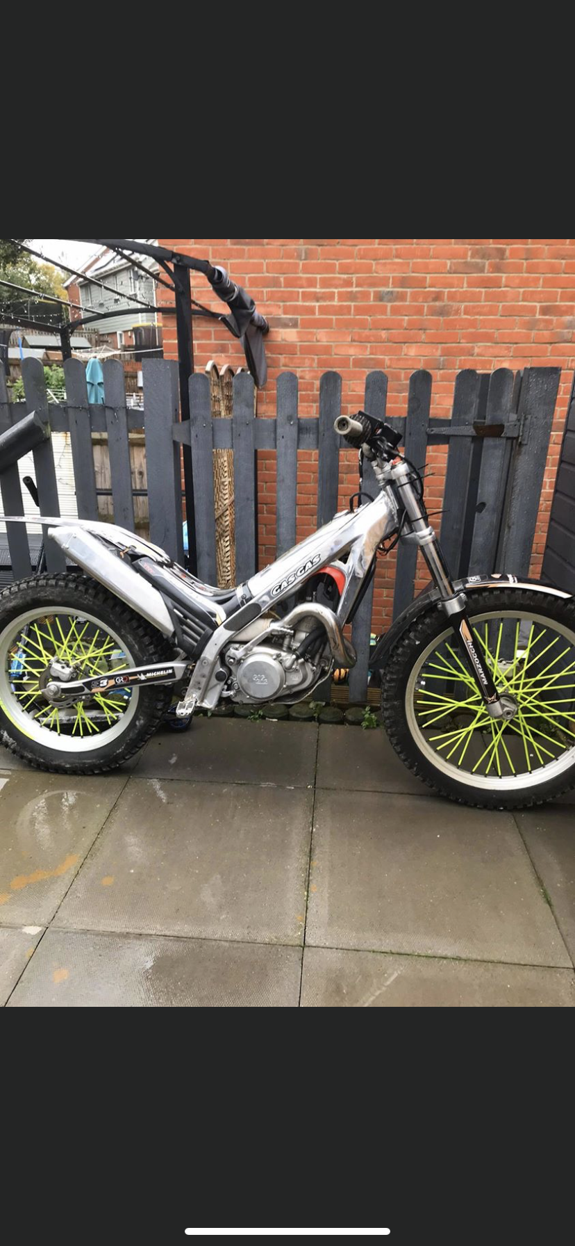

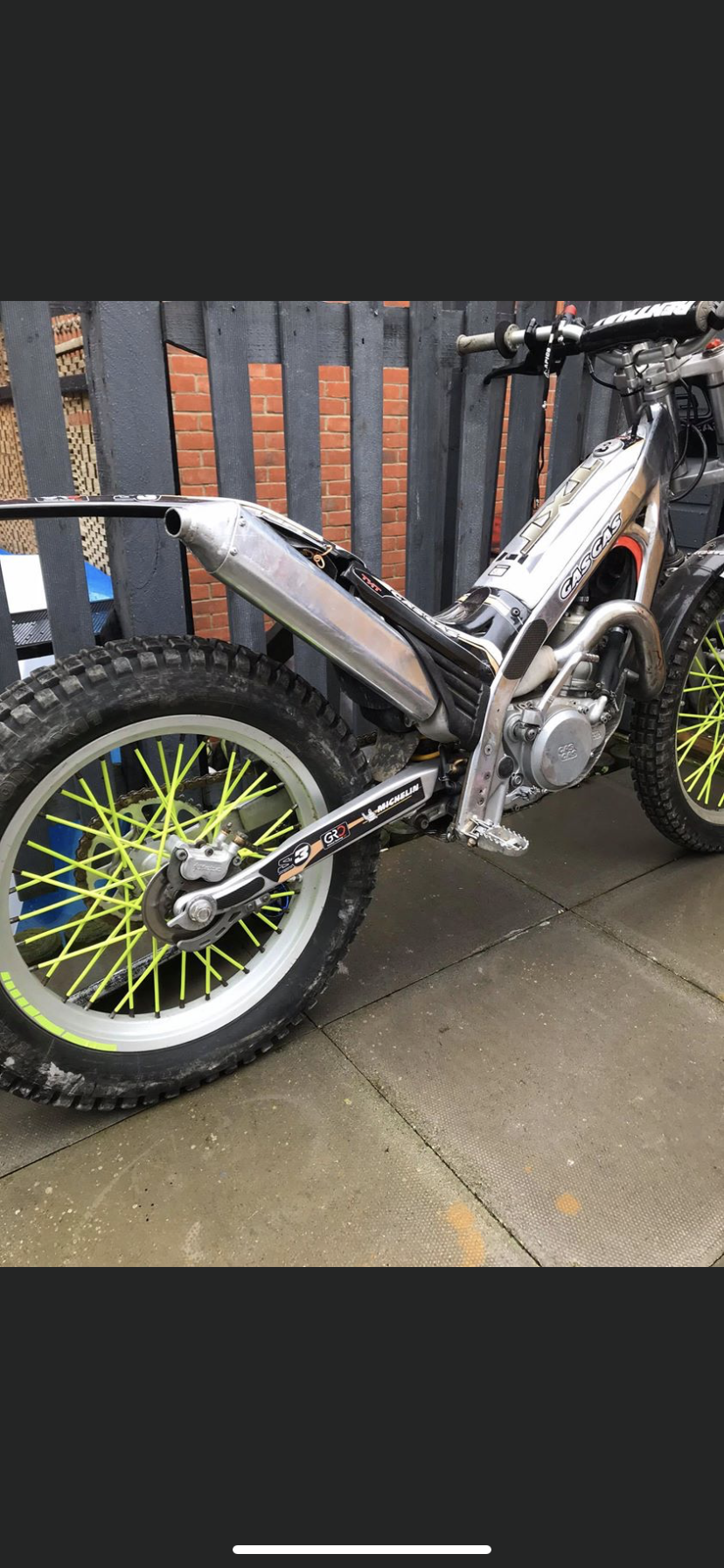

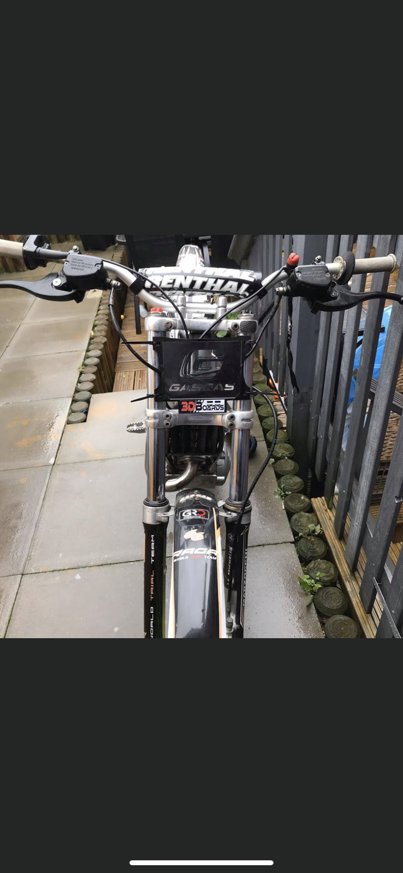

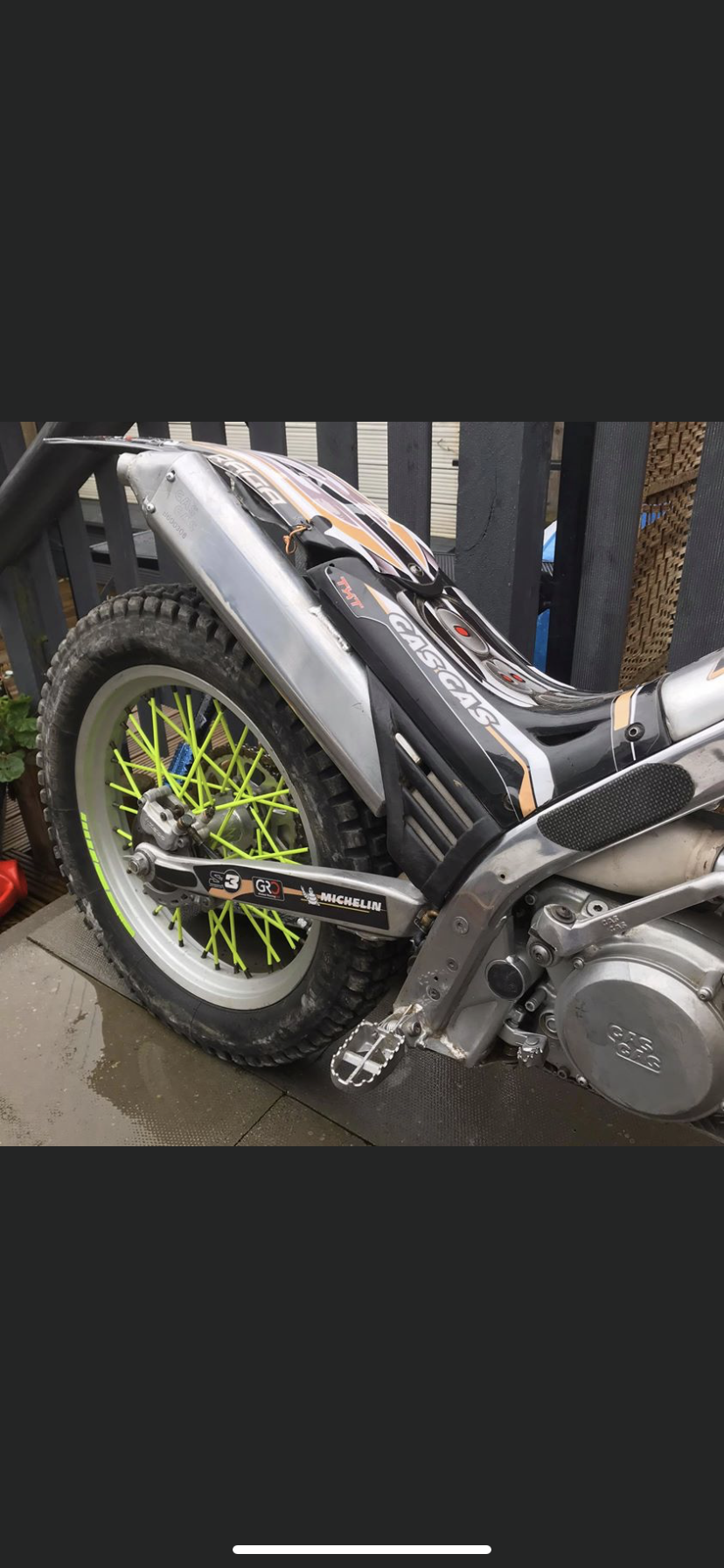

LewisBailey1992 Posted December 9, 2019 Report Share Posted December 9, 2019 Hi all new to trialscentral so please bear with! Currently ride a pretty beaten up 2000 Gasser 280 txt pro and fancy something a bit newer. Found an apparent 05 model but I’m a bit dubious on whether it is what matey says it is. The livery seems to be from a Raga edition but pretty convinced they’ve been put on after. Also from what I can see the frame seems to look like a pre 05 model wondered if anyone can shed any light on what I’m actually looking at? cheers Lewis Quote Link to comment Share on other sites More sharing options...

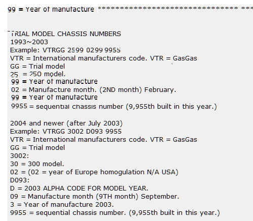

Bilko Posted December 9, 2019 Report Share Posted December 9, 2019 (edited) Well the bike pictured is 2001/2003 Also you say you ride a 2000 280 txt Pro Sorry but the Pro model didn't come out until 2002 . check the Vin against pic Edited December 9, 2019 by Bilko 1 Quote Link to comment Share on other sites More sharing options...
Bilko Posted December 9, 2019 Report Share Posted December 9, 2019 (edited) If you click on the pics they in large https://2bbikes.com/models Edited December 9, 2019 by Bilko Quote Link to comment Share on other sites More sharing options...
tshock250 Posted December 9, 2019 Report Share Posted December 9, 2019 I’d stay well clear of that, it’s nowhere near a 2005 model or a pro (which were introduced in 2002) which brings your own bike into question. Quote Link to comment Share on other sites More sharing options...
LewisBailey1992 Posted December 9, 2019 Author Report Share Posted December 9, 2019 Thanks everyone much appreciated! Mine is a 2002, not a 2000... my bad for the typo! thought as much though, the search continues... Quote Link to comment Share on other sites More sharing options...
