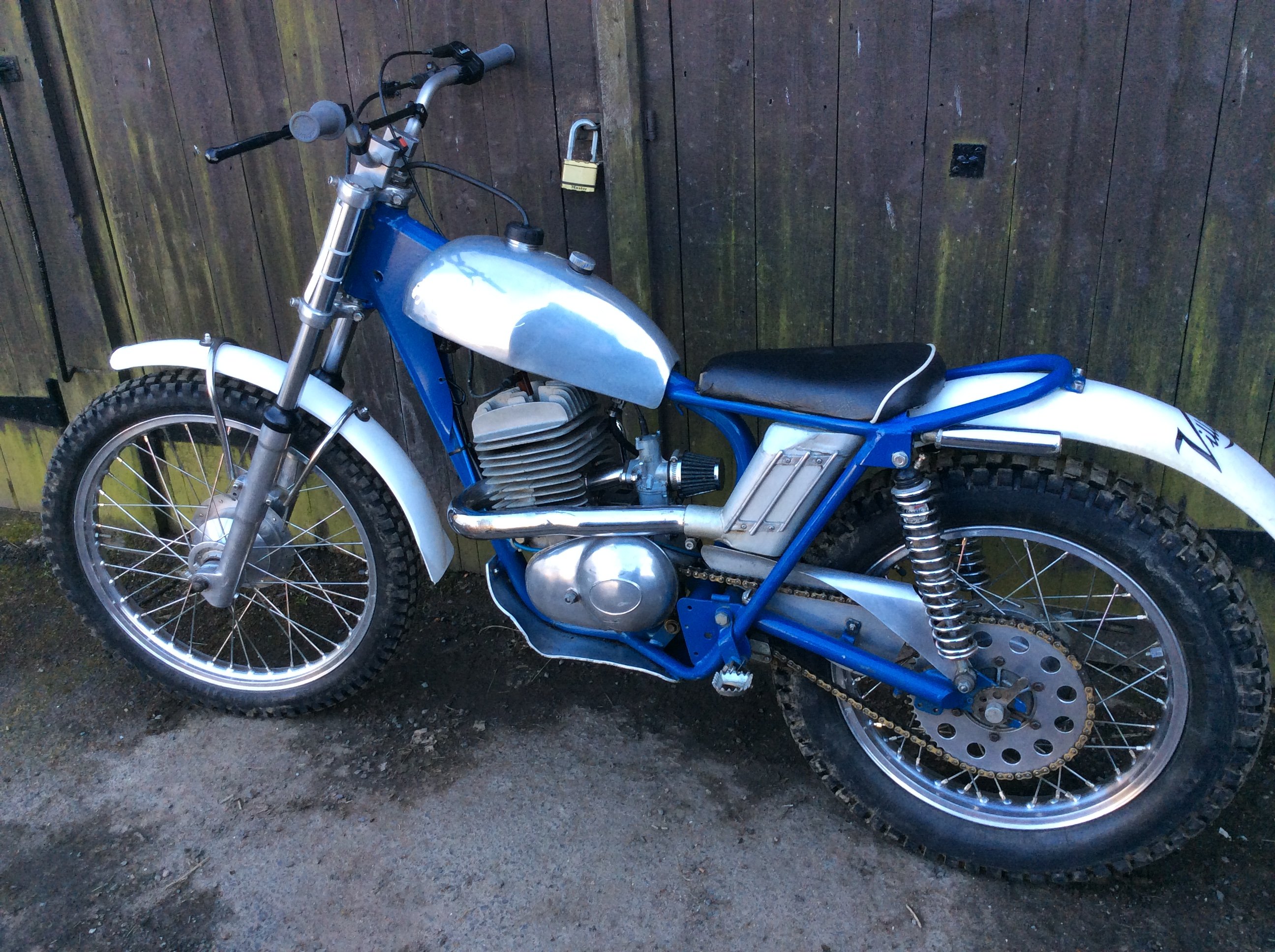

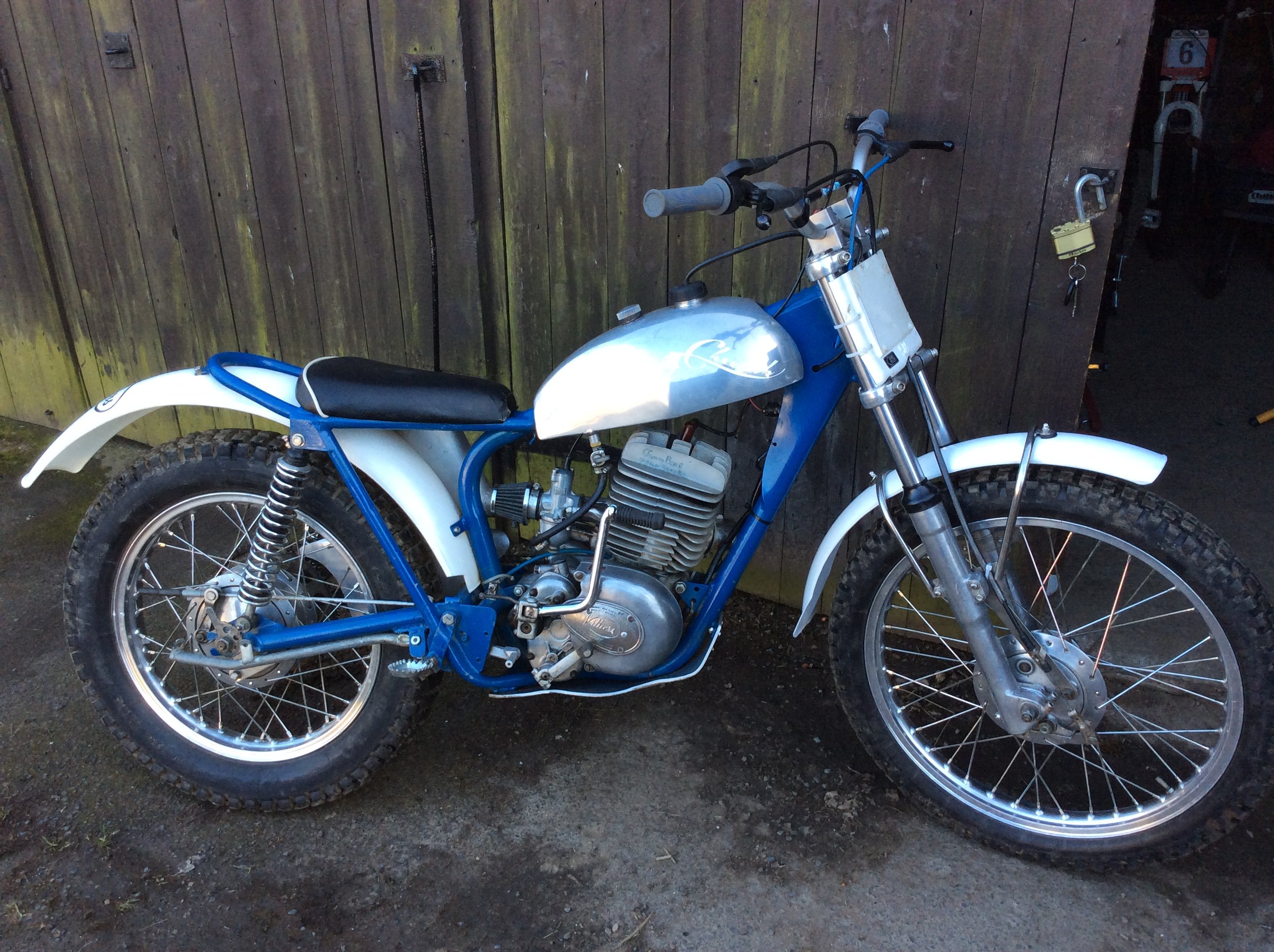

adrianbellingham Posted December 9, 2019 Report Share Posted December 9, 2019 Hi all I have recently found Villiers engined Cheetah Can anyone help with identifying year etc frame number is 1516 with the 6 over stamped with a 7 it has a plated frame and greeves barrels and head look forward to the advise ab Quote Link to comment Share on other sites More sharing options...

stickinthemud Posted December 9, 2019 Report Share Posted December 9, 2019 Hi Adrian - The first Cheetahs looked like this without the double gussets at the headstock. I don't know what number they changed at but mine is 1521 and has the double gussets. I believe that most Frames were sold without engines and riders upgraded their tired Greeves, Dots, Cottons etc with these frame kit options as shown on the attached price list. I think I heard that 98 examples were made during 1967/68. Quote Link to comment Share on other sites More sharing options...

adrianbellingham Posted December 11, 2019 Author Report Share Posted December 11, 2019 Thank you for the information certainly ties the date down Quote Link to comment Share on other sites More sharing options...
