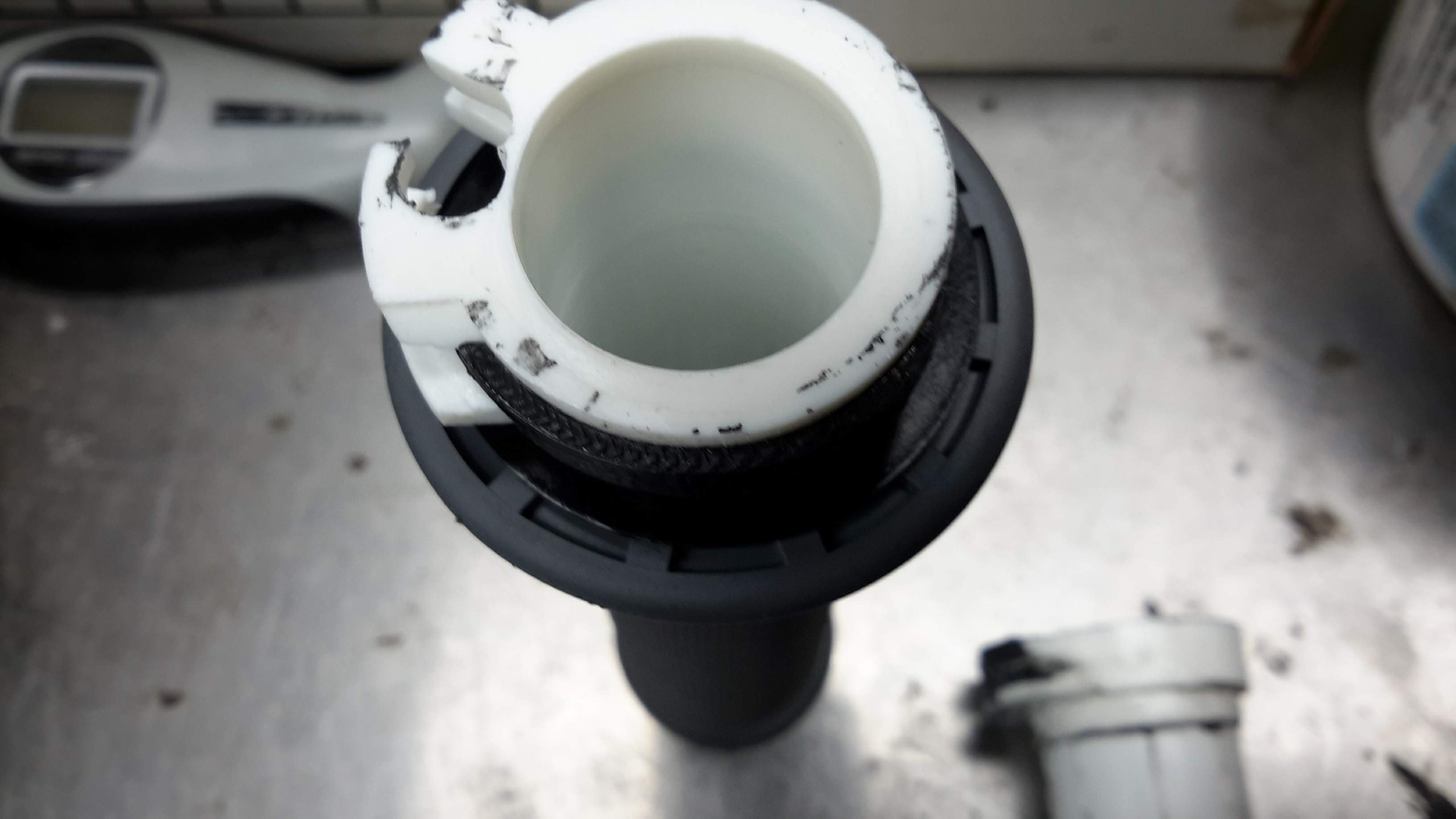

sparkybill Posted December 21, 2019 Report Share Posted December 21, 2019 He may be using the extra fast throttle that came on the 2019 Gold,this is a picture of it. 2 Quote Link to comment Share on other sites More sharing options...

Canario Posted December 21, 2019 Report Share Posted December 21, 2019 (edited) 14 hours ago, sparkybill said: He may be using the extra fast throttle that came on the 2019 Gold,this is a picture of it. This would explain a lot to me. I saw Franzi with his new Gold this year the first time at the first Race for the german Championship in Neunkirchen. It was amazing to hear how fast the engine picked up the revs and I wondered what the trick (one of the tricks) could be. Canario Edited December 21, 2019 by Canario 3 Quote Link to comment Share on other sites More sharing options...
