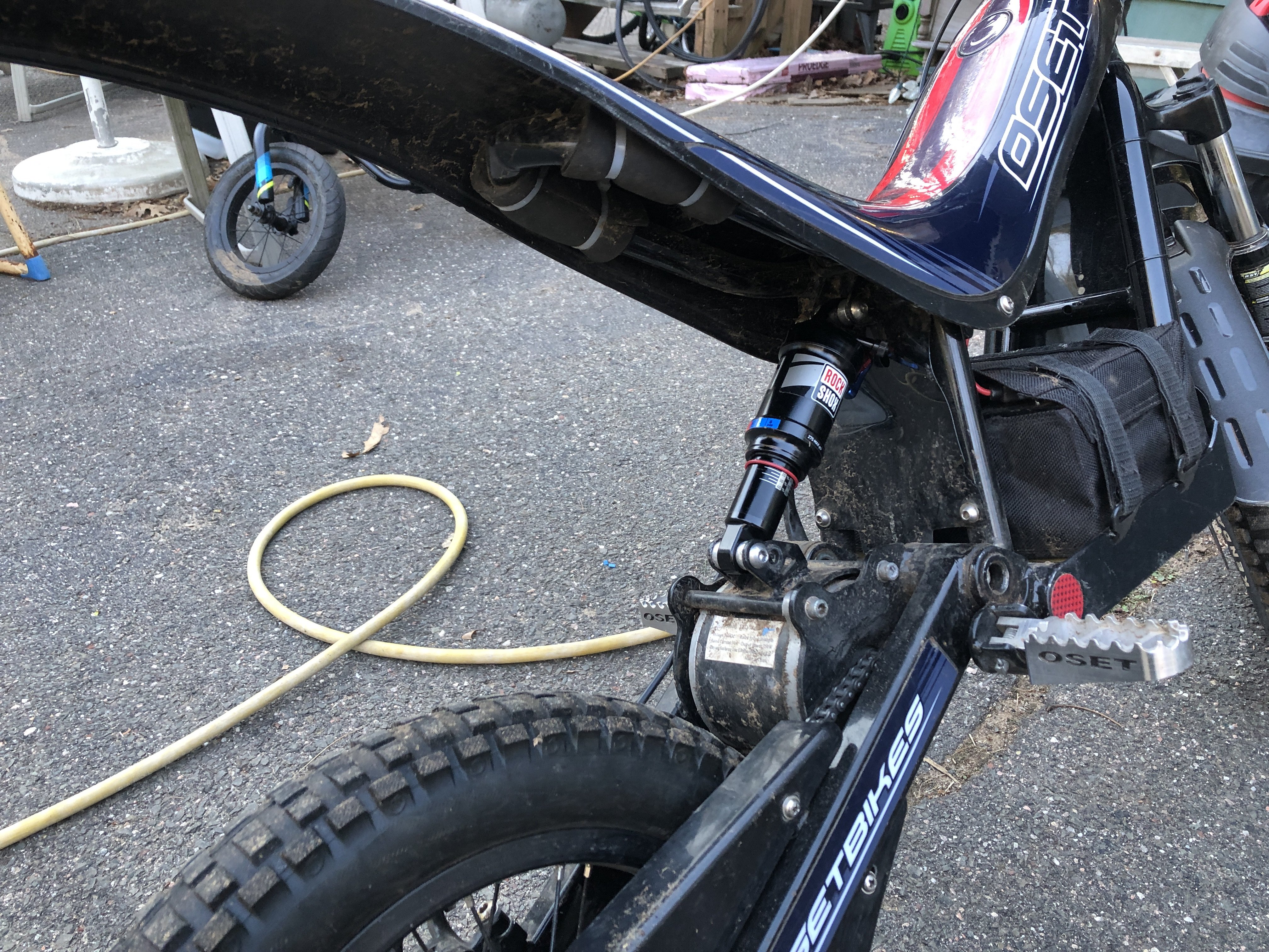

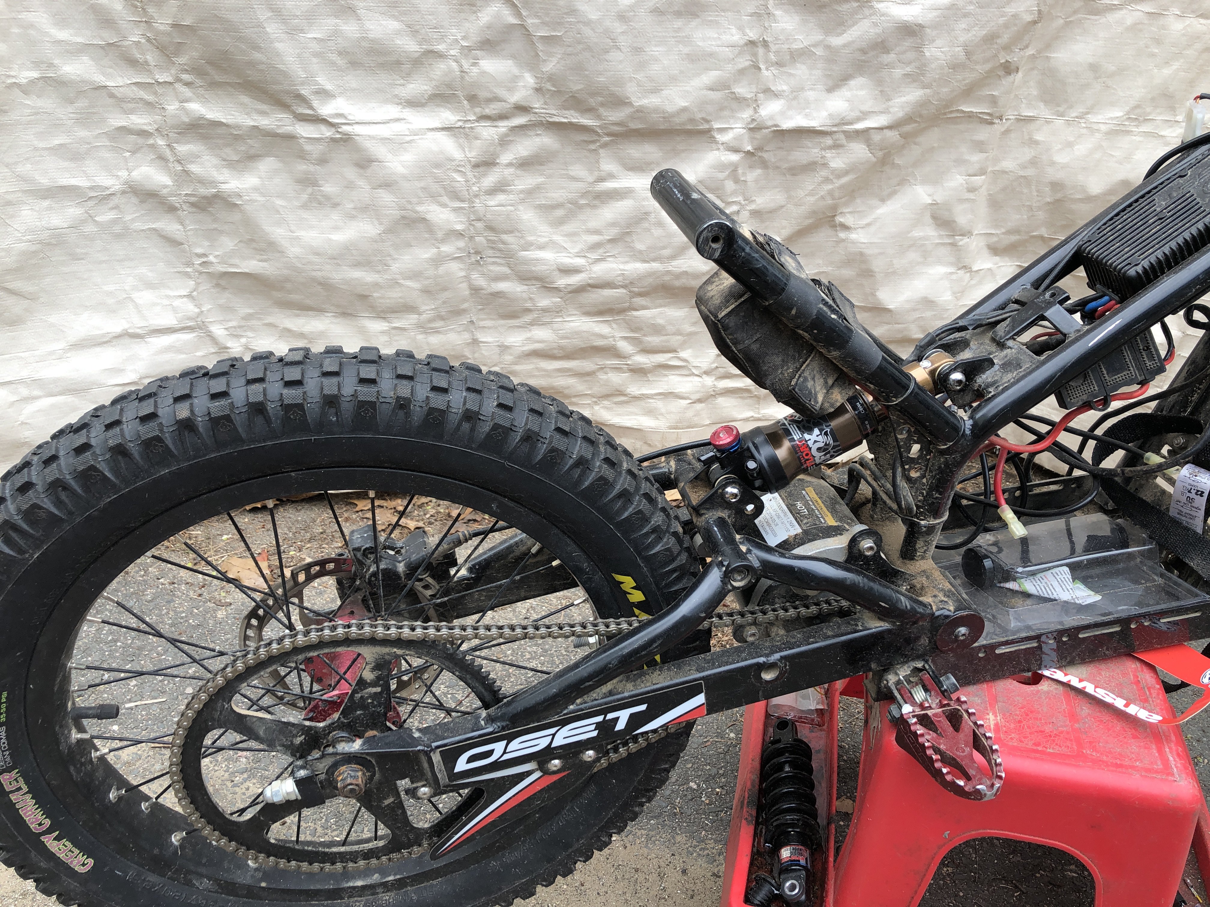

brownbrown Posted April 23, 2020 Report Share Posted April 23, 2020 I have rockshox monarch 6.5”x1.5” fitted on 16 and fox float factory fitted on 20 Quote Link to comment Share on other sites More sharing options...

brownbrown Posted April 23, 2020 Report Share Posted April 23, 2020 6.5” eye to eye on 20 1 Quote Link to comment Share on other sites More sharing options...

brownbrown Posted April 23, 2020 Report Share Posted April 23, 2020 Here’s is 20 with fox 1 Quote Link to comment Share on other sites More sharing options...
