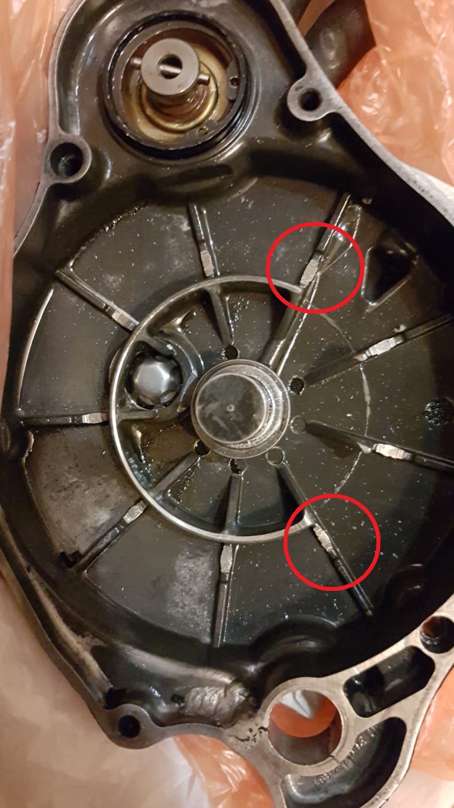

FRV Posted January 2, 2020 Report Share Posted January 2, 2020 Hello, I have just bought GG TXT pro 2007 with a cracked clutch case (kick starter issue - already done), and also checked the clutch. It appeared that it doesn't have clutch bush and screw. Those parts are holding the clutch unit on the axle and prevent axial movement. My local GG dealer said that they are not essential, because clutch is not moving, because the bearing holds it. And newer models doesn't have this part at all. And it is not possible to order those parts now... ( MT280232080, MT280232081). It all looks fine, but my old clutch cover has some scratches from clutch unit. (pictures below) So should I get those parts somehow? Or they are not needed? Quote Link to comment Share on other sites More sharing options...

lineaway Posted June 20, 2024 Report Share Posted June 20, 2024 We have run them without, and no problems. That rubbing can be the fingers are adjusted to high. Quote Link to comment Share on other sites More sharing options...
miner Posted June 20, 2024 Report Share Posted June 20, 2024 The rubbing was something else… put some pics on IMGUR (only use it for here and a few others 🤪)… good news is that I found the vented bolt… it was holding the stator in. 🤦♂️ I was looking at the parts manual including the stator… then I saw the black bolts listed there… I knew there and then it was the most likely place it had been put. 🤪 My next question is around the first two images above which I replicated… Pic 1 shows the clutch and vented bolt… does the bolt go straight in? Or is it missing the bush which is the washer? Pic 2 shows the back of the basket… in the centre, is that the bush? Therefore the vented bolt is purely an axial retainer? I’ve ordered a nut and bush from Lings GG… will probably take 7-10d via Shop & Ship though… wasn’t paying £50 to FedEx it to me in Abu Dhabi 🇦🇪🙅♂️😅… if only that bolt then all good for now anyway. 🤞🙏 There’s a few pics on there showing the clutch casing damage… some dunce may have put a washer under the longer stator black bolt and it all went sideways on the second ride. Last pics are what I was practicing on instead of riding the Gas Gas… made some changes to the setup for the better though… plus fixed the broken fan mount. Just need to do the water pump seal kit now… 🫠😅 GG 250 TXT Pro Clutch 07 Quote Link to comment Share on other sites More sharing options...
