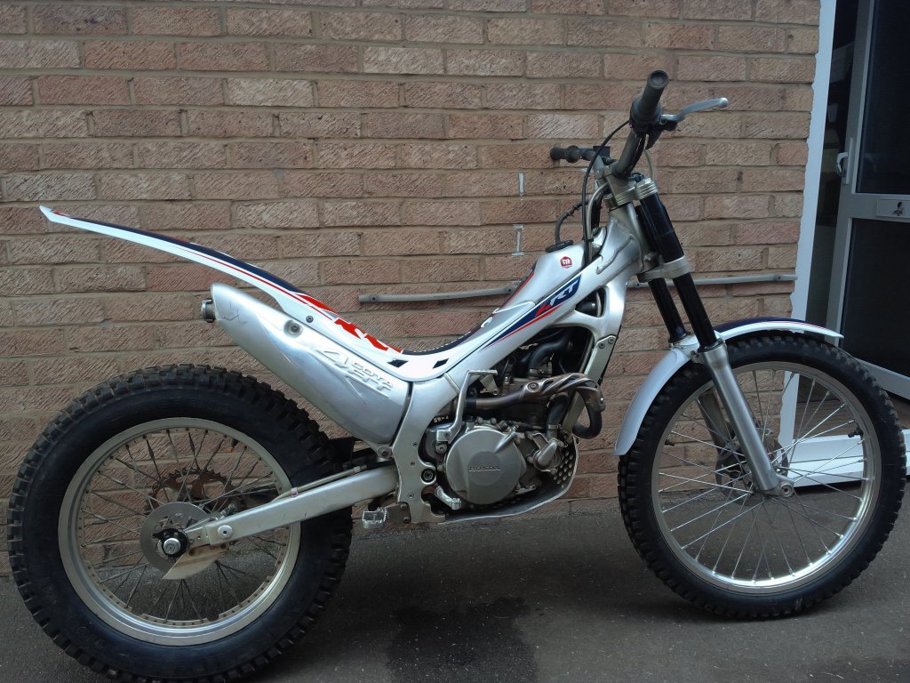

dixie Posted January 16, 2020 Report Share Posted January 16, 2020 I have a 2006 4rt I have had from new , it has never let me down, and even after buying a few more trialers , modern Twinshock and prefer 65, I could never bring myself to let it go, I have just returned to competition after a couple of years, and decided to get the "Lifeboat" out of the shed and tart it up....not bad for a 14 year old Trials bike . 2 Quote Link to comment Share on other sites More sharing options...

dixie Posted January 17, 2020 Report Share Posted January 17, 2020 On 1/17/2020 at 1:42 PM, monteeman said: yes it brushes up well, doesn't look like its done much Ha , only about 150 club trials, Four full seasons of comps , and been my spare bike/lender for ten years after that, I have actually worn through the heat shield ....and straightened the second bash plate many times Just Honda build quality... Expand 1 Quote Link to comment Share on other sites More sharing options...
