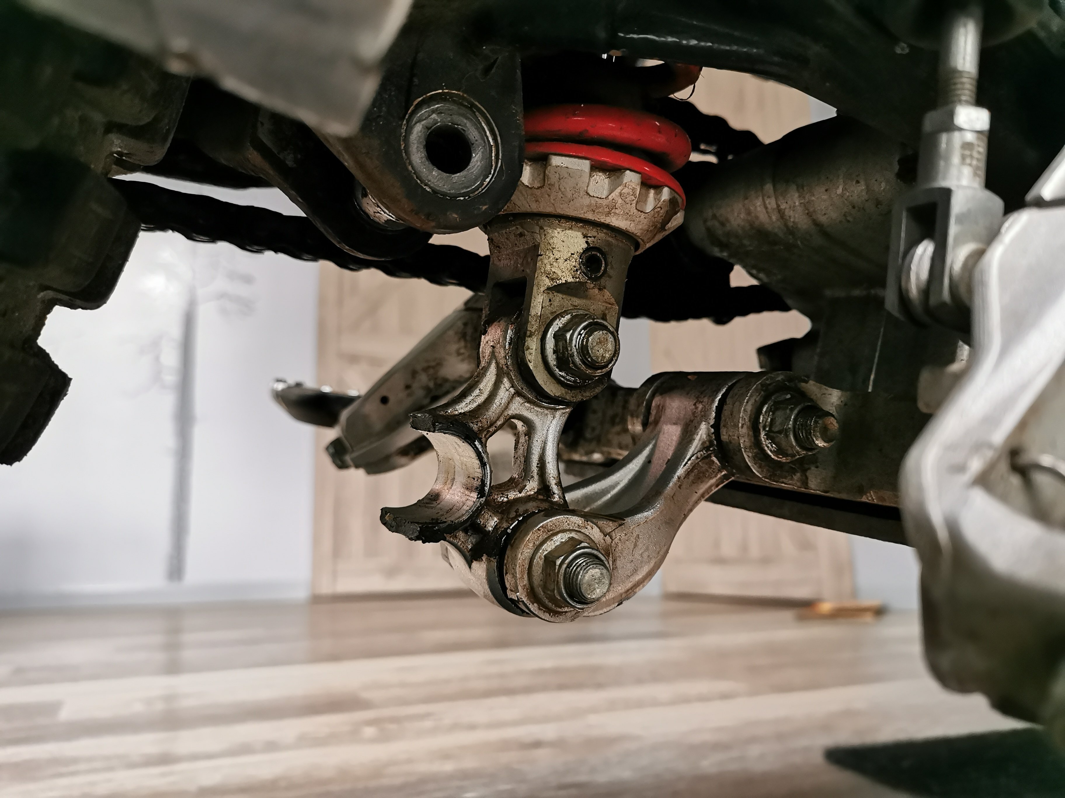

JF4rt Posted March 2, 2020 Report Share Posted March 2, 2020 Hi. Anyone got a broken rear suspension wishbone arm on a TRS one 300 2016 ? Bearing seals and ball joints were lubricated 10 hours of riding before that. Just bought the bike. Yesterday at the club's race, my rear supsension exploded over a 4 ft drop on the second lap. Is it a commun thing? I ordered a knew shock too but...Is that part of the TRS à problem? Thanks a lot Quote Link to comment Share on other sites More sharing options...
huski Posted March 3, 2020 Report Share Posted March 3, 2020 First time I've seen that.Maybe the previous owners hit big steps hard and /or big drop offs a lot 1 1 Quote Link to comment Share on other sites More sharing options...
TRS Fan Posted March 3, 2020 Report Share Posted March 3, 2020 If it was a design fault Adam Raga's bike would not make it through a single X trial event - assuming he has the same linkage fitted. Yes I know he uses a much higher spec. Reiger shock, but he often jumps down from 10 or 15 feet onto a concrete floor. Did the old shock still have some compression damping? 1 Quote Link to comment Share on other sites More sharing options...
pjw123 Posted March 3, 2020 Report Share Posted March 3, 2020 Never heard of it over here in UK. Could be a defective one off. TRRS build quality & suspension up with the best. I'm 13 clem & run the standard Reiger with a softish set up. Brilliant ride. Rider size sometimes requires a stiffer spring, 1 Quote Link to comment Share on other sites More sharing options...
dan929 Posted March 3, 2020 Report Share Posted March 3, 2020 (edited) Yup, I've seen it happen to a mates bike, grumblings from a couple of people he's not the only one. Could just be a few bad parts dropped through the net, it happens with all manufacturing processes. I'd just order a couple and inspect it regularly. Ragas bike is so bespoke it can't be compared to anything the average rider can buy. Although did Toby Martin's bike not suffer the same fate? Edited March 3, 2020 by dan929 2 Quote Link to comment Share on other sites More sharing options...
leembarnes Posted March 3, 2020 Report Share Posted March 3, 2020 Never had an issue, my bike is nearly 3yrs old and has been up and down some fairly big stuff 1 Quote Link to comment Share on other sites More sharing options...
lager raga Posted March 3, 2020 Report Share Posted March 3, 2020 it looks to me like its either had a big crash or when you have greased the bearings the bolts have either been too tight or slack ! I have always been a GG rider up until 2 years ago , when I did a large amount of research on TRS and only heard good things . I bought 1 have riden several large foreign events at an s2 standard done plenty 2 /3 days events nationals etc so at 2 years old I have just exchange it for another TRS having not had a single problem , I would say yours unfortunately is a one off - I would check the shocker is working correctly before rebuilding . Quote Link to comment Share on other sites More sharing options...
