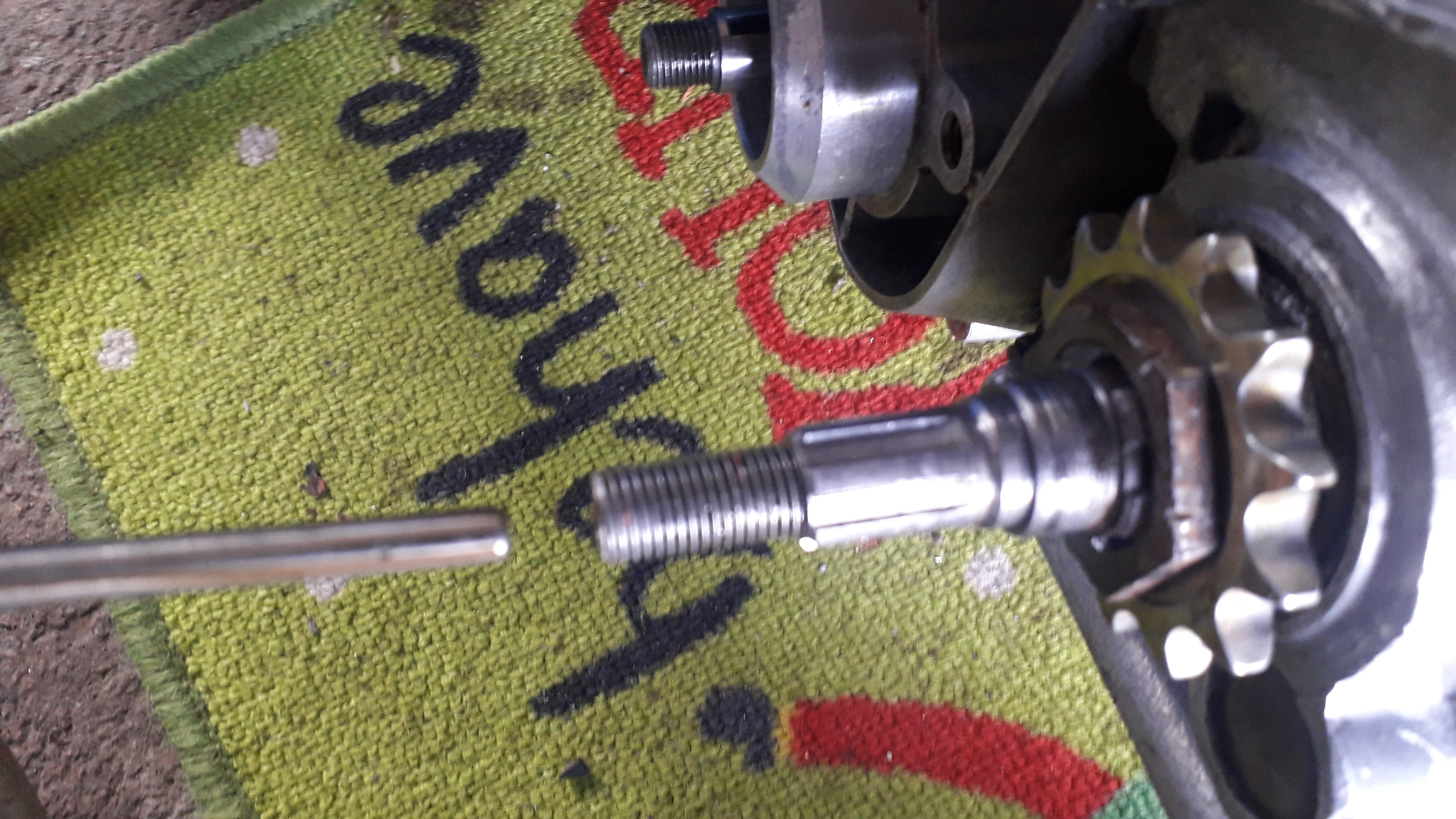

walkertrials Posted March 14, 2020 Report Share Posted March 14, 2020 Should there be a ball bearing behind the clutch pushrod & when arm is pulled in how far should pushrod protrude from end of shaft see photo. Not ready for re-build but making a shopping list of parts ready for Villiers Services order, thanks. Quote Link to comment Share on other sites More sharing options...

teamferret Posted March 14, 2020 Report Share Posted March 14, 2020 If you are going for their 'yamaha' conversion the pushrod will need shortening (and the mainshaft) Quote Link to comment Share on other sites More sharing options...
walkertrials Posted March 15, 2020 Author Report Share Posted March 15, 2020 On 3/14/2020 at 4:22 PM, teamferret said: If you are going for their 'yamaha' conversion the pushrod will need shortening (and the mainshaft) Expand No keeping standard just fitting modern plates, it worked when last used I just expected a ball after I took the pushrod out. The pushrod protrudes out the shaft by 1mm (0.040 thou) Quote Link to comment Share on other sites More sharing options...
teamferret Posted March 17, 2020 Report Share Posted March 17, 2020 No ball bearing in my workshop manual clutch exploded view and no mention in the text Quote Link to comment Share on other sites More sharing options...
