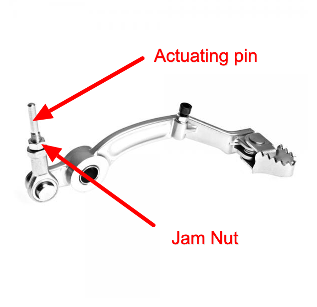

arnoux Posted March 25, 2020 Report Share Posted March 25, 2020 It could be the reservoir port hole is blocked. Do you have some freeplay on the actuating rod? If the piston isn't being allowed to return all the way, then the reservoir port hole is either fully or partially blocked, and you won't be able to bleed it in a month of Sunday! You must have some air gap between the piston and the actuating rod. Same deal on front master cylinders. It is by far the most common problem we see in the workshop with trials bikes. So many people think the actuating pin somehow affect clutch or brake take up point, but it is not for that. It should be set so there is 1mm or so freeplay when in it's relaxed position. Please check that first before moving on. The actuating pin on the rear brake lever can be adjusted for length by undoing the jam nut (10mm open ended wrench) and screwing the rod into the brake lever. until some freeplay is achieved. This allows the piston to go all the way back in the piston port, and opens the bleed port from the reservoir into the system. Quote Link to comment Share on other sites More sharing options...
