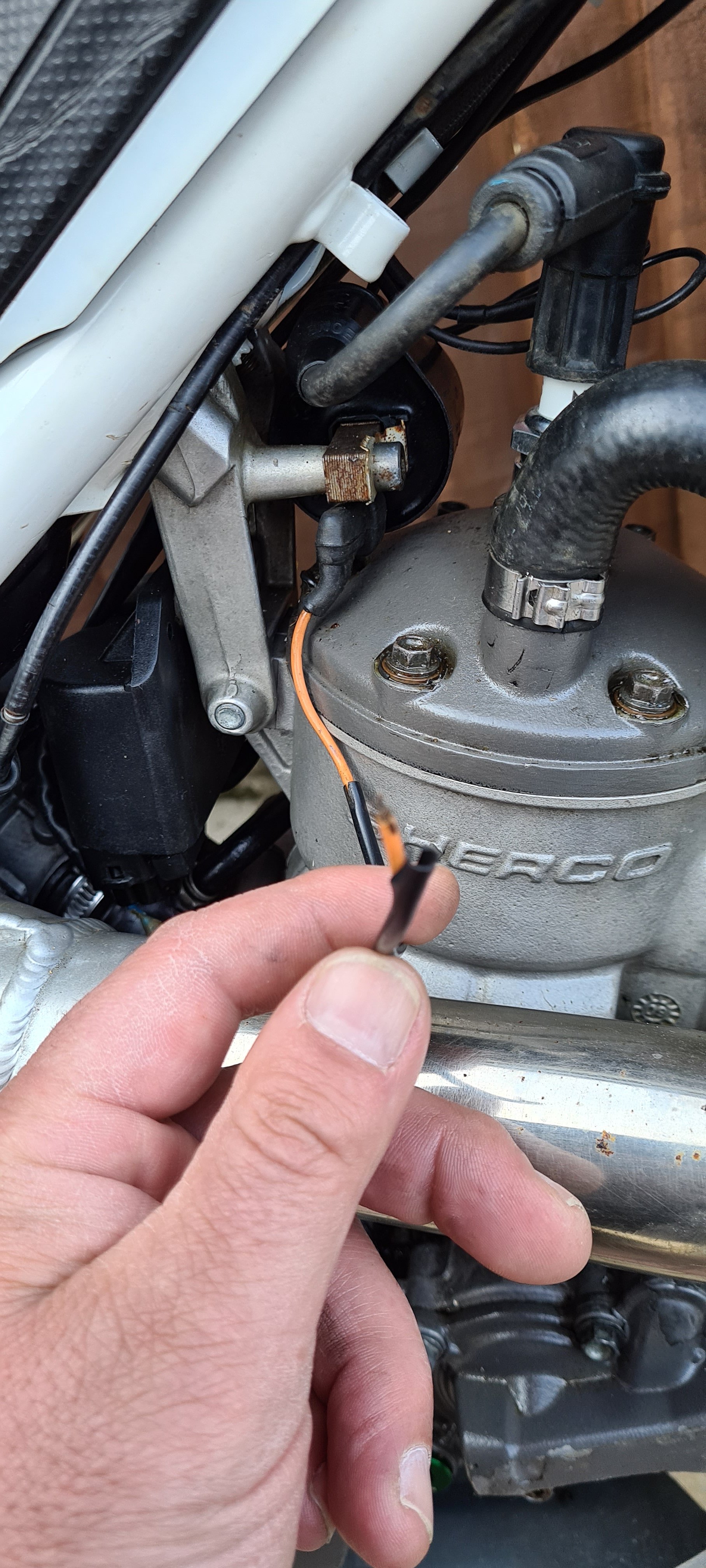

jast Posted March 27, 2020 Report Share Posted March 27, 2020 Any help were this is should be connected to any help appreciated Quote Link to comment Share on other sites More sharing options...
huski Posted March 27, 2020 Report Share Posted March 27, 2020 Kill button? Quote Link to comment Share on other sites More sharing options...

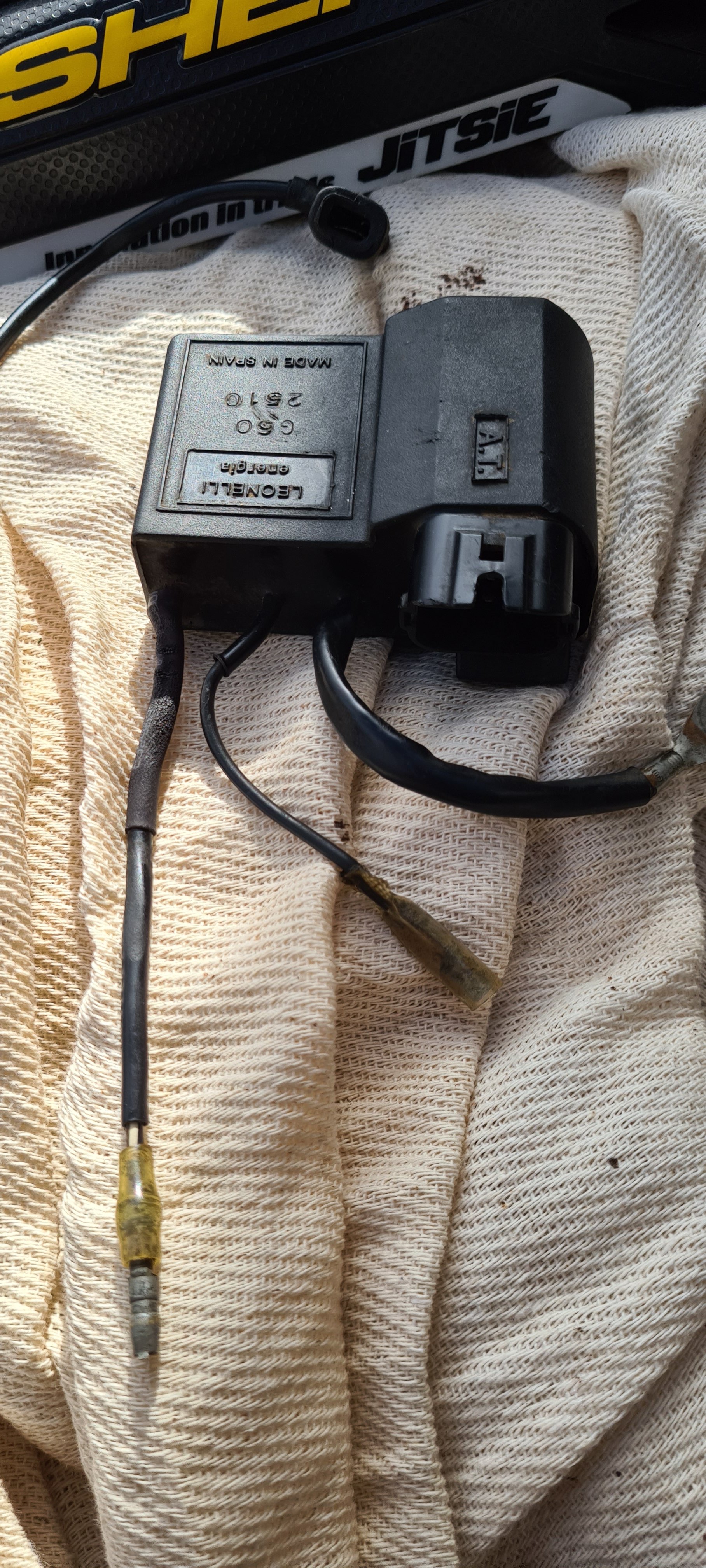

pauls320 Posted March 28, 2020 Report Share Posted March 28, 2020 That orange wire should be connected to the CDI. There should be a two wire harness hardwired into the cdi consisting of ...I think.. a Black with white tracer?, and the other will be your orange...this is what your mystery wire connects to. Good luck Quote Link to comment Share on other sites More sharing options...
jast Posted March 31, 2020 Author Report Share Posted March 31, 2020 Any ideas which one . 1 is black the other white and black can't see were the orage one goes Quote Link to comment Share on other sites More sharing options...
pauls320 Posted March 31, 2020 Report Share Posted March 31, 2020 (edited) Hmm, mine has an orange wire coming out of the left side of the cdi along with that one with the male bullet end, possibly been torn out.? Look closely under that heat shrink tubing at the base of the left side cdi wire(s) exit point..hopefully there is some remnants left to solder your orphaned orange wire back onto. Hope you do not have to buy a new one $$ Good luck Edited March 31, 2020 by pauls320 Quote Link to comment Share on other sites More sharing options...
jast Posted March 31, 2020 Author Report Share Posted March 31, 2020 Yes found the end at the bottom of cdi and sites for replacement can't find any for a 2011 Quote Link to comment Share on other sites More sharing options...
pauls320 Posted March 31, 2020 Report Share Posted March 31, 2020 Did you give splatshop a try? Sometimes its possible to carefully carve/dig/ dremel?? out some of the epoxy and expose enough to solder end onto and then reseal with sikiflex or similar material. Best of luck Quote Link to comment Share on other sites More sharing options...

jast Posted March 31, 2020 Author Report Share Posted March 31, 2020 Wires snaped flush with unit ? Quote Link to comment Share on other sites More sharing options...
