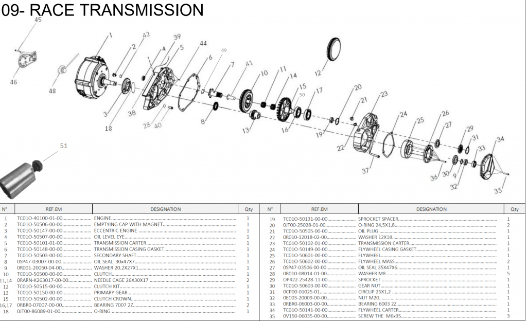

lotus54 Posted June 10, 2020 Report Share Posted June 10, 2020 (edited) This is from another thread- but shows the real clutch on the epure race. I believe the motor shaft has a gear on it that drives the clutch, much like a ‘traditional’ bike. I don’t know how much the flywheel weighs are, but it appears three different options? Edited June 10, 2020 by lotus54 Quote Link to comment Share on other sites More sharing options...
