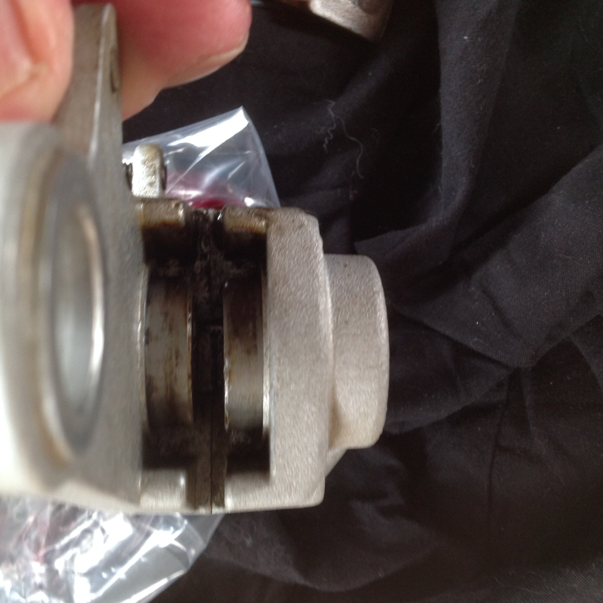

RC4 Posted September 11, 2020 Report Share Posted September 11, 2020 Hi folks and thanks for the advice. I have now taken the caliper off the bike. When connected one piston was slightly better / more out than the other, see image. This was with pedal pressed and after bleeding. My plan is to replace pistons and seals if I can get them out. Not clear how you push them out with compressed air? Anyway plan to visit Honda Montesa dealer in Glasgow to seek advice and necessary parts. You can probably tell I am no mechanic! Thanks again. 1 Quote Link to comment Share on other sites More sharing options...
totty79 Posted September 11, 2020 Report Share Posted September 11, 2020 One piston normally moves more than the other, find a way to hold it in place and you can use the peddle to force the other one out. Edge them out in turn until one pops out and you lose fluid and the other won't have far to go so won't be a hard to get out. 1 Quote Link to comment Share on other sites More sharing options...
massimo Posted September 12, 2020 Report Share Posted September 12, 2020 Dear RC4, once the caliper is out of the bike, you must open it, unscrewing the two screws blocking the two parts.You will find a little hole connecting the two parts. Blow air in these holes, and close with your finger the oil inner (only on one side...). Once the pistons are out, check theme, and the seals. If they are not damage, you do not need to replace theme. I hope you could understand me... sorry for my English... Have a nice day. Massimo Quote Link to comment Share on other sites More sharing options...
RC4 Posted September 12, 2020 Report Share Posted September 12, 2020 Hi Massiimo. Thanks for the advice. I took the caliper to a dealer this morning and he did as you said. It took him 5 minutes! He split the casing, freed up the pistons and told me to clean it carefully later. I have now done this and the seels are fine and the pistons are now free. See the image now. Will put it all back together tomorrow. Dealer did this foc which was great. 1 Quote Link to comment Share on other sites More sharing options...
