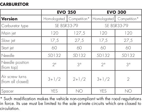

lineaway Posted April 23, 2020 Report Share Posted April 23, 2020 Did not see your last post. The fuel screw is in front of the bowl towards the engine intake, under the carb. That is why you need the thumb screw. And usually the dealers do not recommend jetting changes. The only reason I can reason is it is hard. The Beta owners manual showed the jetting changes for years, under competition jetting. The 4t always came lean for emissions. 1 1 Quote Link to comment Share on other sites More sharing options...
retromlc Posted April 23, 2020 Author Report Share Posted April 23, 2020 Cheers lineaway, I checked the beta USA support section, no setting in the 2013 manual but the 14 & 15 manual gives the same changes so I'll assume the 13 would be the same, might have a look later today 1 Quote Link to comment Share on other sites More sharing options...

retromlc Posted April 23, 2020 Author Report Share Posted April 23, 2020 Checked the jets today and pilot jet is 27.5 but the main jet stamp is a bit off so it could be 127 or 121, do they out a line through the 7 in their jets? Quote Link to comment Share on other sites More sharing options...
lineaway Posted April 23, 2020 Report Share Posted April 23, 2020 I would guess you are good as lo g as you have a thumb screw to fine tune it your good. Quote Link to comment Share on other sites More sharing options...
pindie Posted April 24, 2020 Report Share Posted April 24, 2020 (edited) As lineaway says Retro. It’s under the intake side and not air box side And side of carb like a 2t air screw. I’ve not ever looked at a 4t fuel screw on a Evo but I know on other dirt bikes they are a pig to get to at the best of times. I used to use a little 90 degree ratchet on my KTM 4t to reach it. I can see why people suggest adding the thumb screw for easy adjusting. Try wiping a permanent marker over the jet markings and wipe wipe your finger before dry. The marker ink will stay in the markings but wipe off the outside making the numbers easy to see.... Edited April 24, 2020 by pindie 1 Quote Link to comment Share on other sites More sharing options...
retromlc Posted April 24, 2020 Author Report Share Posted April 24, 2020 Pindle the jet numbers sorta miss, so with the last number is a 7 or a 1? It should be 127.5 so it makes me think it not a 7? Quote Link to comment Share on other sites More sharing options...
pindie Posted April 24, 2020 Report Share Posted April 24, 2020 Do you have three or four digits? If four then it’s likely it’s the 127.5? Quote Link to comment Share on other sites More sharing options...
retromlc Posted April 24, 2020 Author Report Share Posted April 24, 2020 I'll need to get it.out.again but pretty sure just 3 Quote Link to comment Share on other sites More sharing options...
retromlc Posted April 26, 2020 Author Report Share Posted April 26, 2020 Its a 127,5 having a mare getting the carb back in, I'm pretty sure I have the connection rubber boot from back if carb to airbox facing the right way as the fitting diameter it.larger in the carb side than the.airbix side, but I can't get it all connected without it rolling off the back of the carb as I tighten the jubalie clip, any suggestions Quote Link to comment Share on other sites More sharing options...
