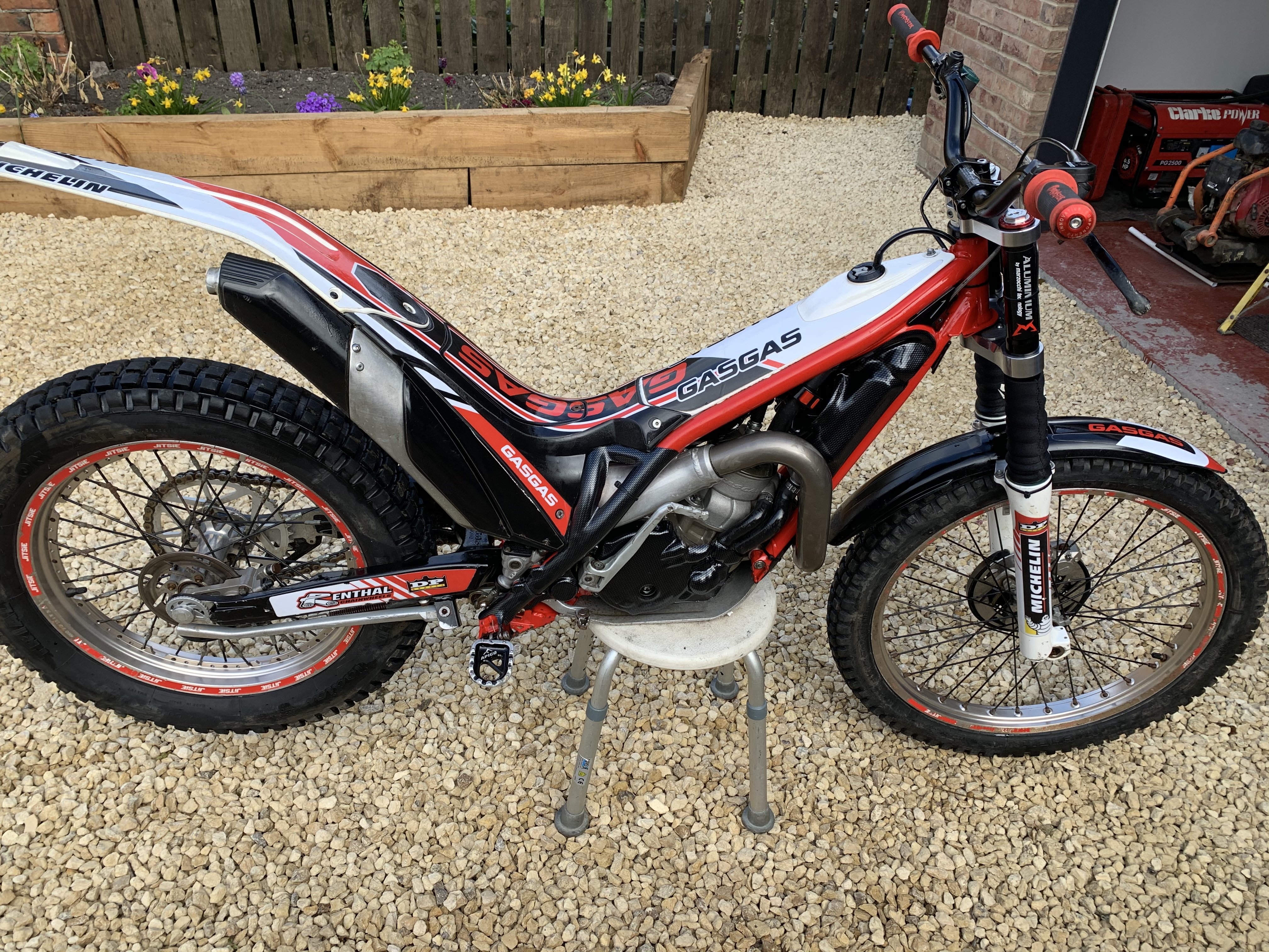

MarkLathrope Posted April 7, 2020 Report Share Posted April 7, 2020 (edited) Hi again guys is there any trick to getting off a seized on kick start I’ve followed the removal process by undoing the Allen bolts and using the lever to prize it off the splines. looking for tips now how to remove I’ve soaked it in release agent thanks Edited April 7, 2020 by MarkLathrope Quote Link to comment Share on other sites More sharing options...
d2w Posted April 7, 2020 Report Share Posted April 7, 2020 You might be able to exploit the fact that the splined shaft is steel and the kick starter housing is aluminum, so the two different metals will have different rates of expansion. Use a heat source (propane torch, electric heat gun) to heat the kick starter housing. That may help to break any corrosion. Or it may be that the splines contain a thread-lock (which will be softened by the heat as well). Also gently tap the housing with a small metal hammer to try to break any corrosion. As a last resort a small bearing puller might be fitted to pull the housing against the shaft. Just take it easy on your actions; no welding torches and sledge hammers! ? Quote Link to comment Share on other sites More sharing options...
MarkLathrope Posted April 7, 2020 Author Report Share Posted April 7, 2020 Thanks next stop was a blow lamp on the knuckle on the splines ? shes had a full strip down and clean just a good general clean and tidy. Could really do with new wheel bearing again what a pig to pull the rear spacers they won’t budge Quote Link to comment Share on other sites More sharing options...
d2w Posted April 7, 2020 Report Share Posted April 7, 2020 Looking good. Attempt to tap the wheel spacers out from the opposite side using a drift (i.e., through the axle shaft channel). I fall a lot and so I've done well to wrap the header pipe with heat shield/exhaust weave so that I don't melt my pants and/or burn my leg; it can get stinking hot. Quote Link to comment Share on other sites More sharing options...
