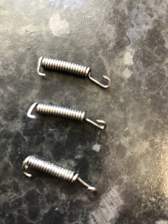

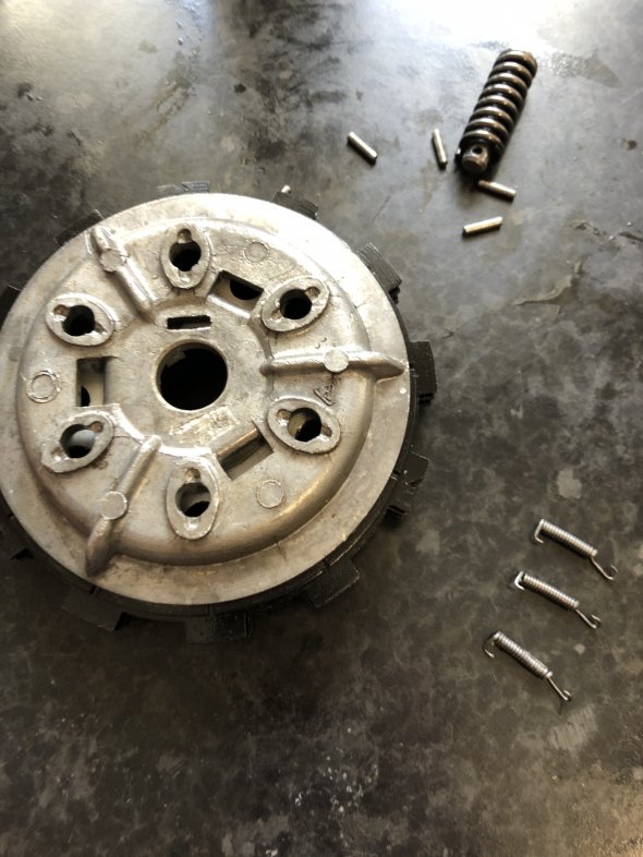

Bob Davies Posted April 13, 2020 Report Share Posted April 13, 2020 Hi Guys looking for a little assistance, took the clutch apart as Im overhauling a 349 Montesa circa 1980 and I'm having difficulty putting the 3 little clutch springs back. I know I should have taken a photo first before removing them but I forgot, is there a set up to reinstalling the clutch Quote Link to comment Share on other sites More sharing options...

Bob Davies Posted April 15, 2020 Author Report Share Posted April 15, 2020 Thanks for that delberto but mine is a different configuration, the 3 little springs just hook onto the outer lugged plate some how and are fully exposed not in a recessed hole like that one. Quote Link to comment Share on other sites More sharing options...
sparkieb Posted April 17, 2020 Report Share Posted April 17, 2020 I left them off my 348 when i rebuilt the clutch, think they are anti-rattle springs and have been known to fall off. I needed new pins for the main springs (they crack) but they are available ? i think i got mine from " in motion " Quote Link to comment Share on other sites More sharing options...
Bob Davies Posted April 17, 2020 Author Report Share Posted April 17, 2020 Thanks Sparkieb for the info I'll leave them off. many thanks Quote Link to comment Share on other sites More sharing options...
