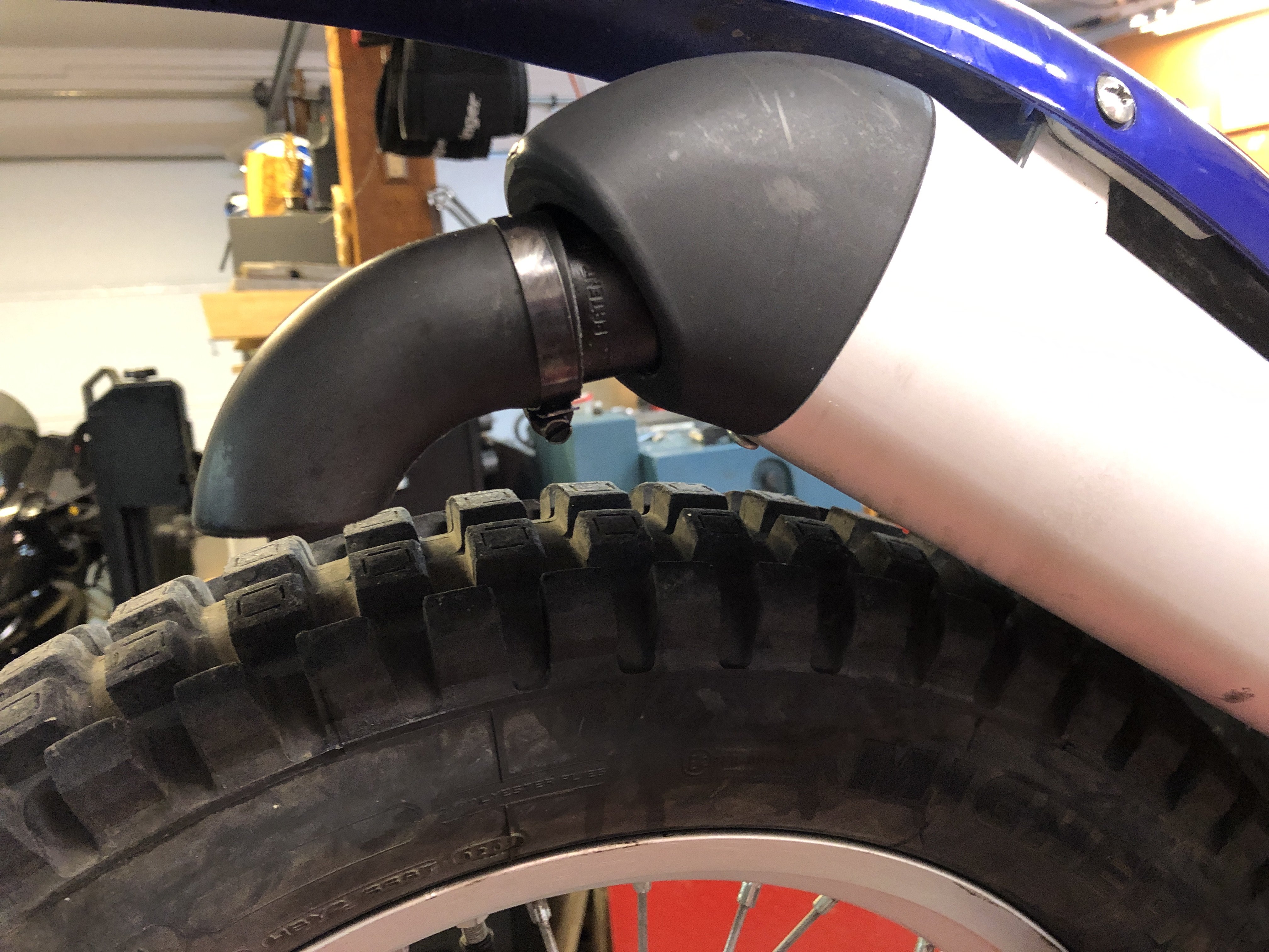

mcman56 Posted June 7, 2020 Report Share Posted June 7, 2020 I had a some success quieting down an 2001 270. It is not a night and day difference but there is a noticeable decrease in sound. The bike had a megaphone shaped spark arrestor and I swapped it out for a John Deer style. The link shows the type but I'm not sure it is the exact size. There are 2 or 3 sizes. https://www.ebay.com/itm/Lot-of-2-NGP-49024-AM108146-Exhaust-Muffler-Spark-Arrester-Screen-Type-1-3-8-OD/162488243183?hash=item25d50dd3ef:g:2NIAAOSwWWxY~Wzt Second, I put on a rubber 90 degree elbow on the end of the exhaust so it points at the ground. 1 Quote Link to comment Share on other sites More sharing options...
