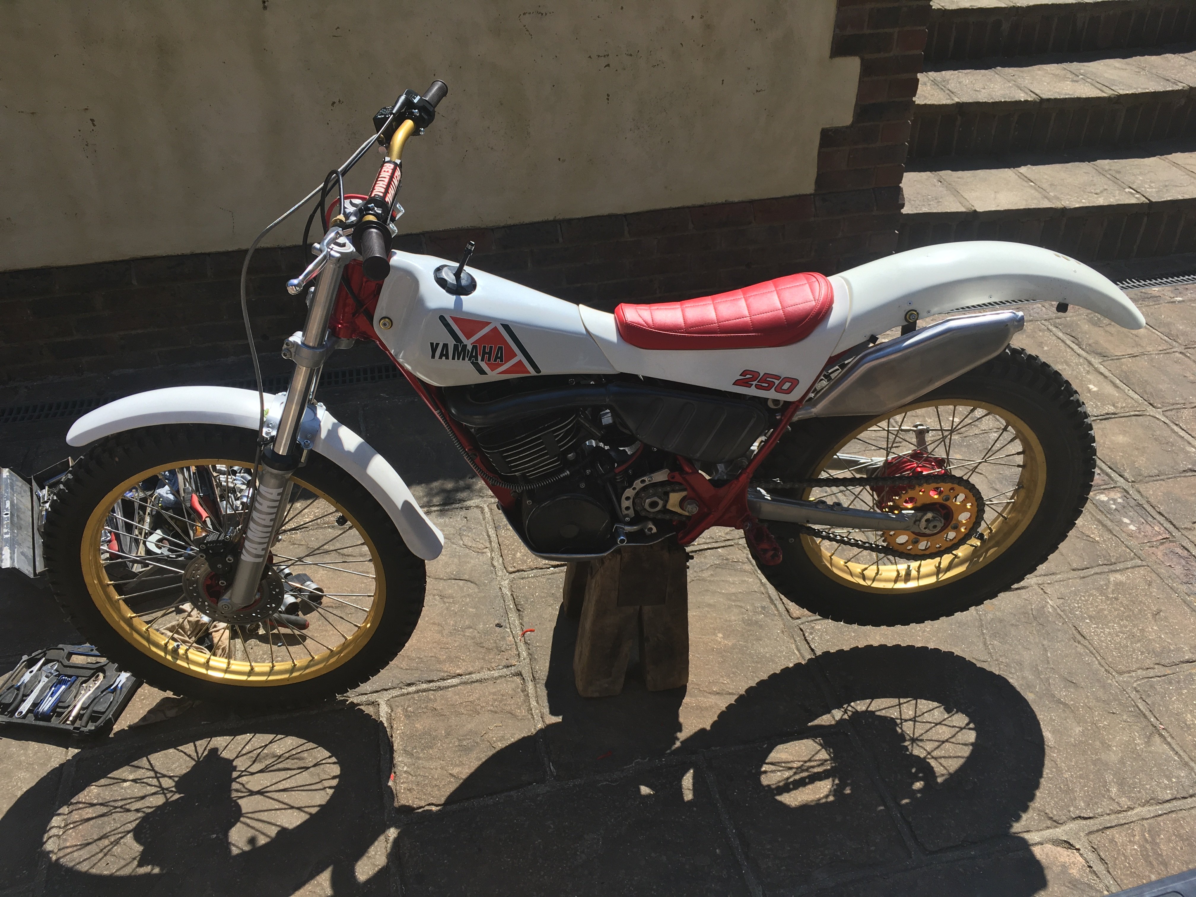

dannyboi Posted April 25, 2020 Report Share Posted April 25, 2020 Hello I just picked up this beautiful 1985 250 mono, however it’s got a couple of weird things about it The rear is super stiff, I do not believe it has anything to do with the shock it feels like something else, it will go down a bit but not come back up also the front caliper rocks forwards and backwards, is this normal? It’s actually unridable atm, all the linkage bearings are newish and the swing arm I believe also any ideas guys? Just paid £2000 for this bike, other than these points it is lovely Thanks Quote Link to comment Share on other sites More sharing options...
lineaway Posted April 25, 2020 Report Share Posted April 25, 2020 The 1985 had drum brakes. You need to check the linkage for a broken bolt. Quote Link to comment Share on other sites More sharing options...
misscrabstick Posted April 25, 2020 Report Share Posted April 25, 2020 I think with the rear suspension, you are going to need to get the bike up and remove the rear wheel, then the shock and manually push and pull the swinging arm and linkages to check for binding, what you describe could be typical of a bent piston rod in the shock. Quote Link to comment Share on other sites More sharing options...
misscrabstick Posted April 25, 2020 Report Share Posted April 25, 2020 A video would help to give any clue on the caliper. Quote Link to comment Share on other sites More sharing options...
section swept Posted April 26, 2020 Report Share Posted April 26, 2020 There should no movement like you describe with the front caliper. Careful inspection should show up the problem. 1 Quote Link to comment Share on other sites More sharing options...
dannyboi Posted April 26, 2020 Author Report Share Posted April 26, 2020 It has had a disc conversion on the front, I tightened it all up and it stopped moving by hand, but still moves back and forth when braking took everything apart this morning, all linkages seem fine and I regreased them but when I tighten the swingarm spindle once it gets to a certain point of tightness it starts binding ive tightened it up so much just before it starts binding, lock tighted it and went for a ride, moves more freely now but still creaks however, every little bump and the tire is hitting the rear fender, if I sit at the back of the bike it is rubbing constantly not too sure what to do now ? thanks for your replies Quote Link to comment Share on other sites More sharing options...

misscrabstick Posted April 26, 2020 Report Share Posted April 26, 2020 My guess with the arm would be incorrect assy by someone, or perhaps something left out, it should be possible to tighten it without tightening, as for the bottoming out, is the shock the right one? or perhaps the linkages have been assembled incorrectly./ 2 Quote Link to comment Share on other sites More sharing options...
rotors7 Posted April 26, 2020 Report Share Posted April 26, 2020 Are the front caliper mounting bolts too small in diameter, either to the fork leg or a bracket if fitted ? If, as you say, it's the caliper itself that's moving then it must be the wrong bolts. Could it be worn disc to hub mounts you're feeling ? Quote Link to comment Share on other sites More sharing options...
