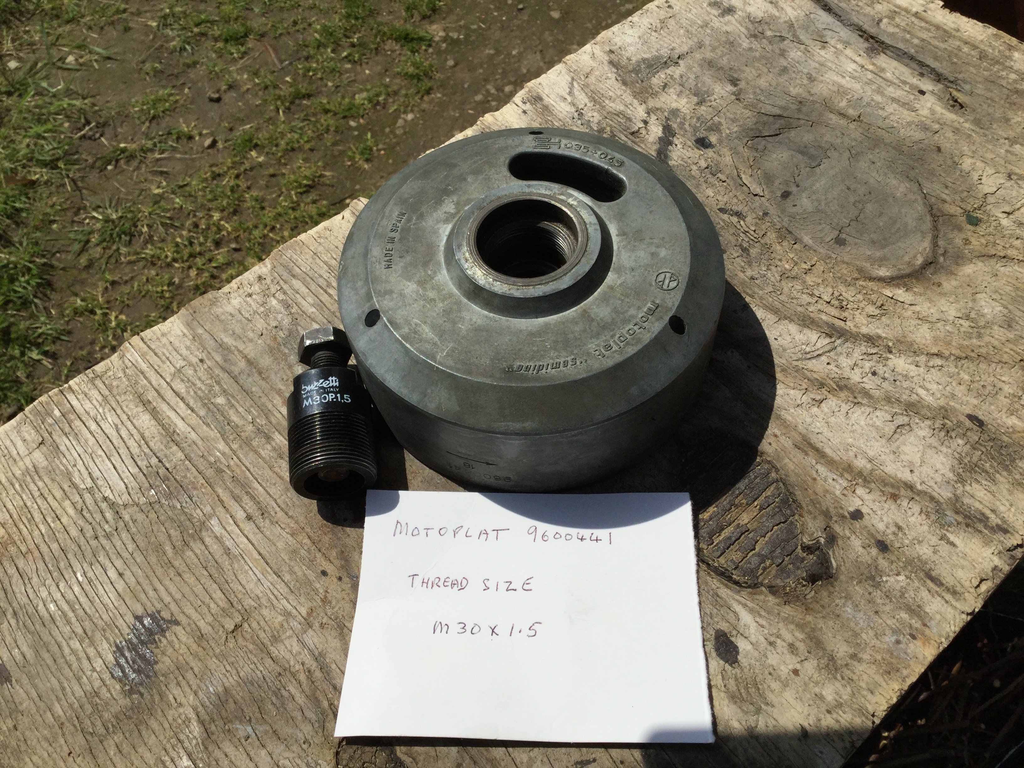

johnjsy Posted May 7, 2020 Report Share Posted May 7, 2020 Yes Mick, it is M30 X 1.5 I have a picture, not sure how to put it on here, going to try anyway. Quote Link to comment Share on other sites More sharing options...
johnjsy Posted May 7, 2020 Report Share Posted May 7, 2020 Hi Mick,lets see if this is correct. 1 Quote Link to comment Share on other sites More sharing options...
mick annick Posted May 7, 2020 Author Report Share Posted May 7, 2020 John Brilliant thank you, that’s the same flywheel as mine! Quote Link to comment Share on other sites More sharing options...
