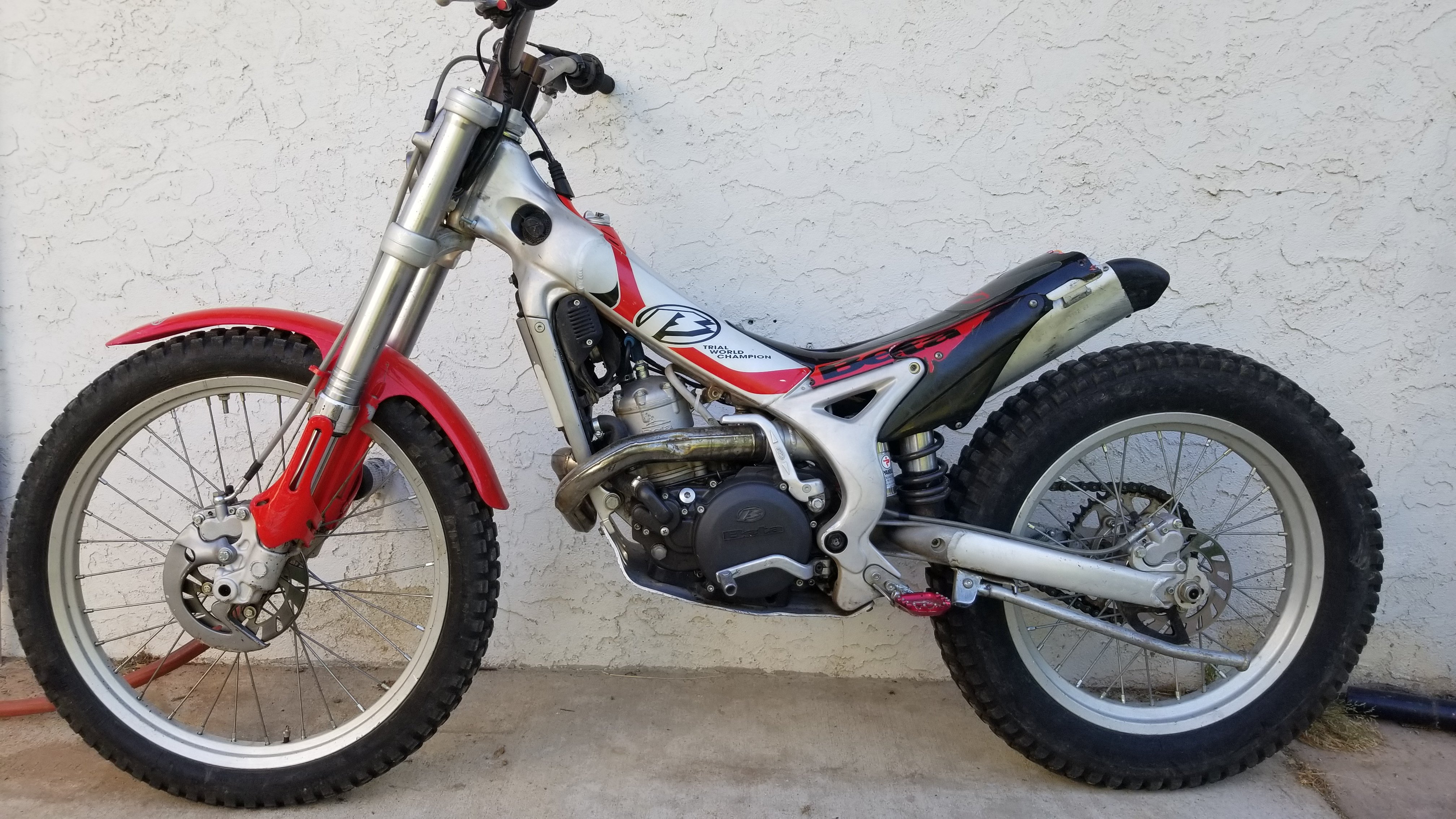

jbrandt Posted May 22, 2020 Report Share Posted May 22, 2020 Hey folks, I just brought home a new (old) 2000 Beta Rev3 270. This is my first trials bike, but I've been riding trails for 15 or so years. I can already tell it's a handful! But I'm not scared (much, lol) I've been doing a fair amount of googling trying to find various sources for parts/accessories for this fine steed, but I'd like to get some advice from the well seasoned Beta gurus. One things is I'm trying to figure out parts compatibility. It's a 2000 model year, but what other model years have interchangeable parts? The 2001 seems pretty similar, just different color plastics? It needs a new rear fender, and the fork seals (inverted forks) are leaking a bit. Also wondering about silencers, hand controls and foot levers and all that typical stuff. Are those pretty specific to Beta trials bikes? Tires are pretty beat up too, but I'll limp those along for a little while longer. Also, and I KNOW I'm going to sound like a total goober, but this is also my first 2-stroke, so I'm wondering if there is a standard pre-mix ratio that's different from trail bikes. Are they all pretty much 40:1? Also, does the type/brand of pre-mix matter? Again, I'm a complete noob to 2-strokes. Here's the new steed, because I know the internet likes pictures: Quote Link to comment Share on other sites More sharing options...

jbrandt Posted May 22, 2020 Author Report Share Posted May 22, 2020 (edited) 17 minutes ago, retromlc said: Where are you based I have some old tyres that are barely used, that I changed due to age, the front Michelin isn't as good as the new one but the rear IRC doesn't feel any different, if you're near Ashford Kent you can have them for free haha, I'm in California, USA, maybe a little far. Appreciate the offer! The tires (tyres?) are serviceable for now, first priority is the fork seals and maybe a fender that I'll probably immediately break again. Edited May 22, 2020 by jbrandt 1 Quote Link to comment Share on other sites More sharing options...

petert Posted May 22, 2020 Report Share Posted May 22, 2020 You may struggle with the rear fender and air filters as they were peculiar to the 2000 and I think 2001 Revs. Ask me how I know! 1 Quote Link to comment Share on other sites More sharing options...
lineaway Posted May 22, 2020 Report Share Posted May 22, 2020 There is a fender and air filter on e bay right now. 1 Quote Link to comment Share on other sites More sharing options...
jbrandt Posted May 22, 2020 Author Report Share Posted May 22, 2020 3 hours ago, lineaway said: There is a fender and air filter on e bay right now. Yeah, I saw *one* for a 2001, and was wondering if it would work for the 2000 Quote Link to comment Share on other sites More sharing options...
jbrandt Posted May 22, 2020 Author Report Share Posted May 22, 2020 (edited) 9 hours ago, markparrish said: https://www.beta-uk.com/ is a UK Beta specialist - their website looks like it's being rebuilt as I write this, but when they are running they have parts diagrams for all years and you can compare part numbers to see if yours are interchangeable. At a glance, I'd say lots of them are but the forks and swingarm are different from my old 2007 for example. The oil mix is closer to 70:1 on the 2007. I imagine 40:1 would be too strong. Good luck - It will be great fun! Mark glad I checked. Thanks! I did some more searching and it looks like 70:1 is more for euro fuel, 80:1 seems to be a better spot for the US gas. I saw some running much leaning oil mixes, like 100 or more. Edited May 22, 2020 by jbrandt 1 Quote Link to comment Share on other sites More sharing options...
jbrandt Posted May 22, 2020 Author Report Share Posted May 22, 2020 9 hours ago, markparrish said: https://www.beta-uk.com/ is a UK Beta specialist - their website looks like it's being rebuilt as I write this, but when they are running they have parts diagrams for all years and you can compare part numbers to see if yours are interchangeable. At a glance, I'd say lots of them are but the forks and swingarm are different from my old 2007 for example. The oil mix is closer to 70:1 on the 2007. I imagine 40:1 would be too strong. Good luck - It will be great fun! Mark The problem with part number searches is that I know that at least the 2000 and 2001 fenders are different colors, so I'm sure the part numbers would be different. Quote Link to comment Share on other sites More sharing options...
lineaway Posted May 22, 2020 Report Share Posted May 22, 2020 Yes, the fender is the same for a 2001, I had 3 in 2001 myself. 1 Quote Link to comment Share on other sites More sharing options...
