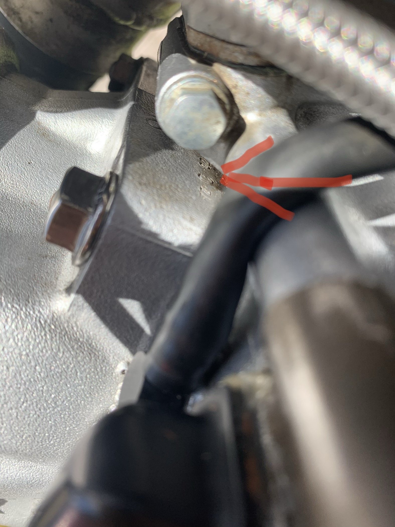

section swept Posted May 25, 2020 Report Share Posted May 25, 2020 Remove the exhaust and see if it drains out unburnt oil. If the exhaust is partially holding oil this could be your problem. Really a photo of more of the cylinder bore would be good. Did you have the engine running when you saw the bike to buy? Quote Link to comment Share on other sites More sharing options...

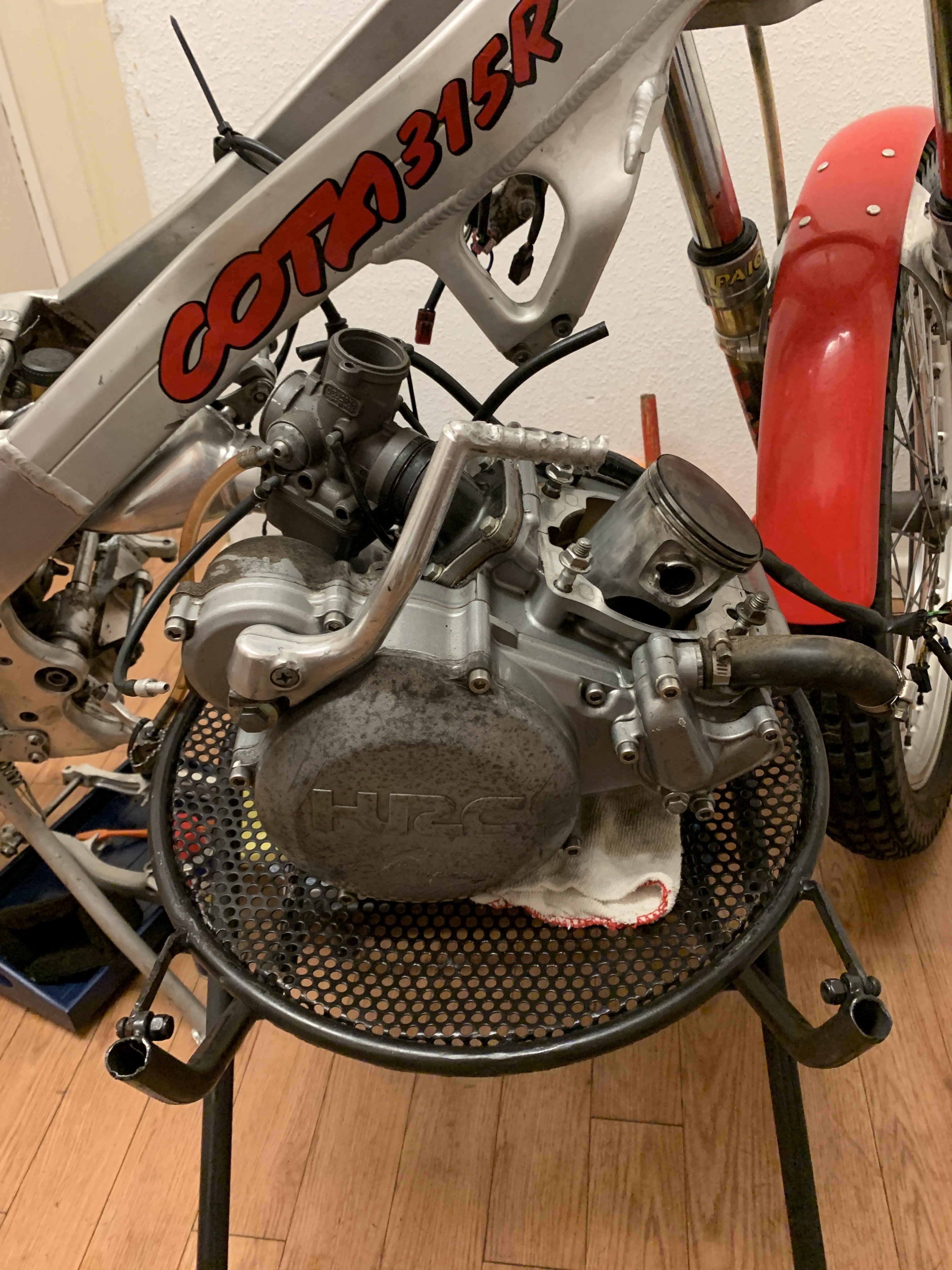

NickMacro Posted May 25, 2020 Author Report Share Posted May 25, 2020 No I only started the bike when I got it home.Im just going to do all seals and bearings in engine.It started off just doing piston but couldn’t see which I needed but now it’s looking like full rebuild.Ive now think it’s a 97.With a c size piston and.Can anyone please let me know we’re I can get parts I need.And is this a size “C” piston?.... Quote Link to comment Share on other sites More sharing options...
NickMacro Posted May 31, 2020 Author Report Share Posted May 31, 2020 I’m just starting to rebuild the engine tomorrow got all the parts o need from Splatshop.He is a good guy there!?Anyone got any tips or any thing I should know before I start tomorrow.Aslo for some reason my clutch give up just before I dicided to rebuild her.Ive tried bleeding the clutch and Still nowt? Quote Link to comment Share on other sites More sharing options...
