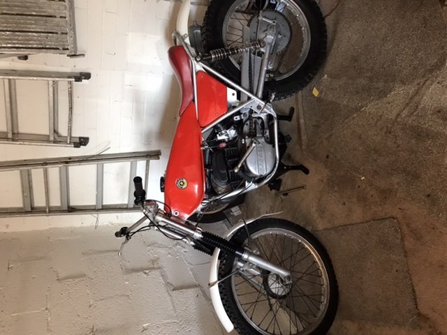

rileys Posted May 30, 2020 Author Report Share Posted May 30, 2020 Yes thanks for the reply’s. great bit of kit from in motion. Should be plug in and start. Went in garage for a few hours today. The woodruff key is not needed Carl. and as Johnjsy said if the timing is right it will fire. So I had to alter it just a little bit and it started up happy days. Again thanks for the reply’s picture of my 158 1 Quote Link to comment Share on other sites More sharing options...
