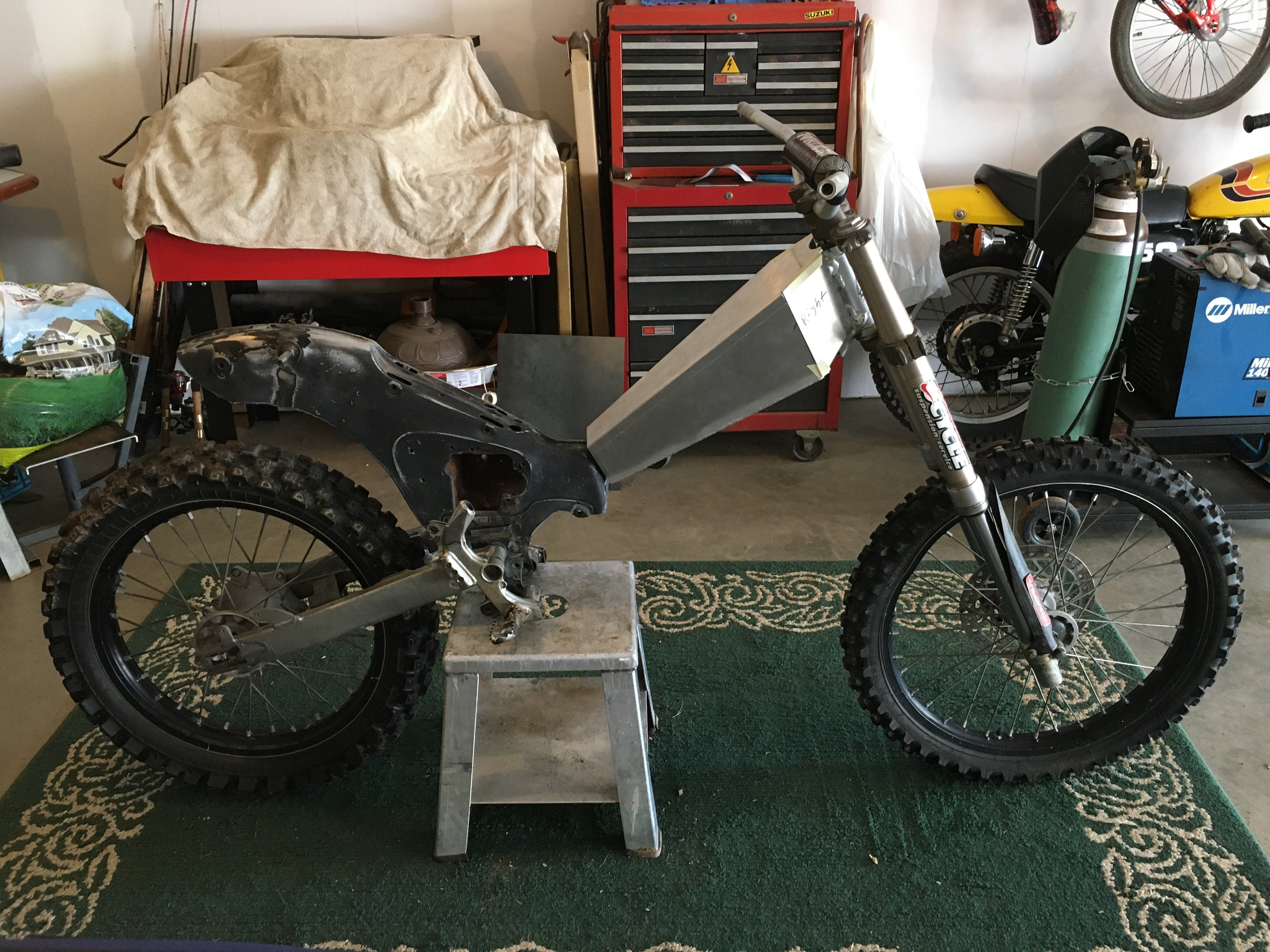

jcone Posted May 30, 2020 Author Report Share Posted May 30, 2020 Looks like I’m pushing 28 degrees, here’s what I have so far yes the knobby tires are going I scored the wheels for 100 bucks couldn’t pass it up. 3 Quote Link to comment Share on other sites More sharing options...

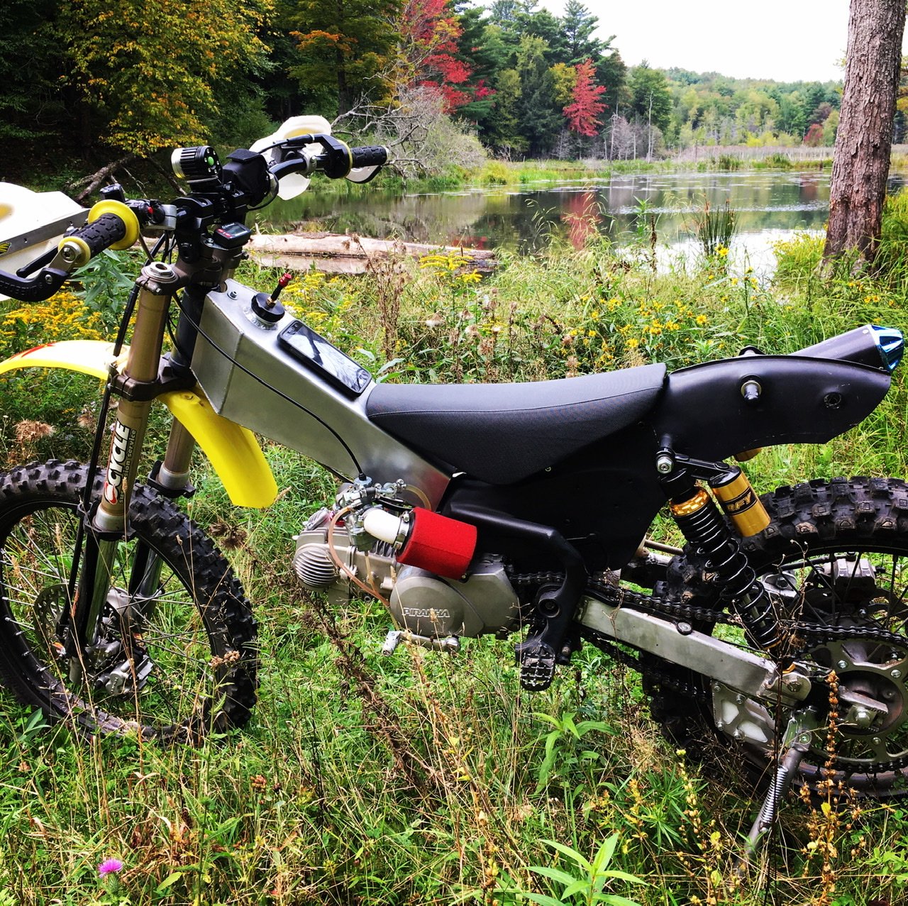

jcone Posted September 28, 2020 Author Report Share Posted September 28, 2020 (edited) It’s been awhile but here it is my 1965 Honda cub Adventure bike. It feels very trials like to ride weights about 170lbs and turning radius is very good I have about 16hrs of ride time on it and couldn’t be happier. Edited September 28, 2020 by jcone 2 Quote Link to comment Share on other sites More sharing options...
Creepytheclutchmaster Posted September 28, 2020 Report Share Posted September 28, 2020 How did you get the head tube of the triple clamps to fit through the frame, iv looked at a few honda cub/c90 frames with the idea of doing a off road mod but the head tubes have all been designed for a old fork with a very thin head tube. Cheers. Quote Link to comment Share on other sites More sharing options...

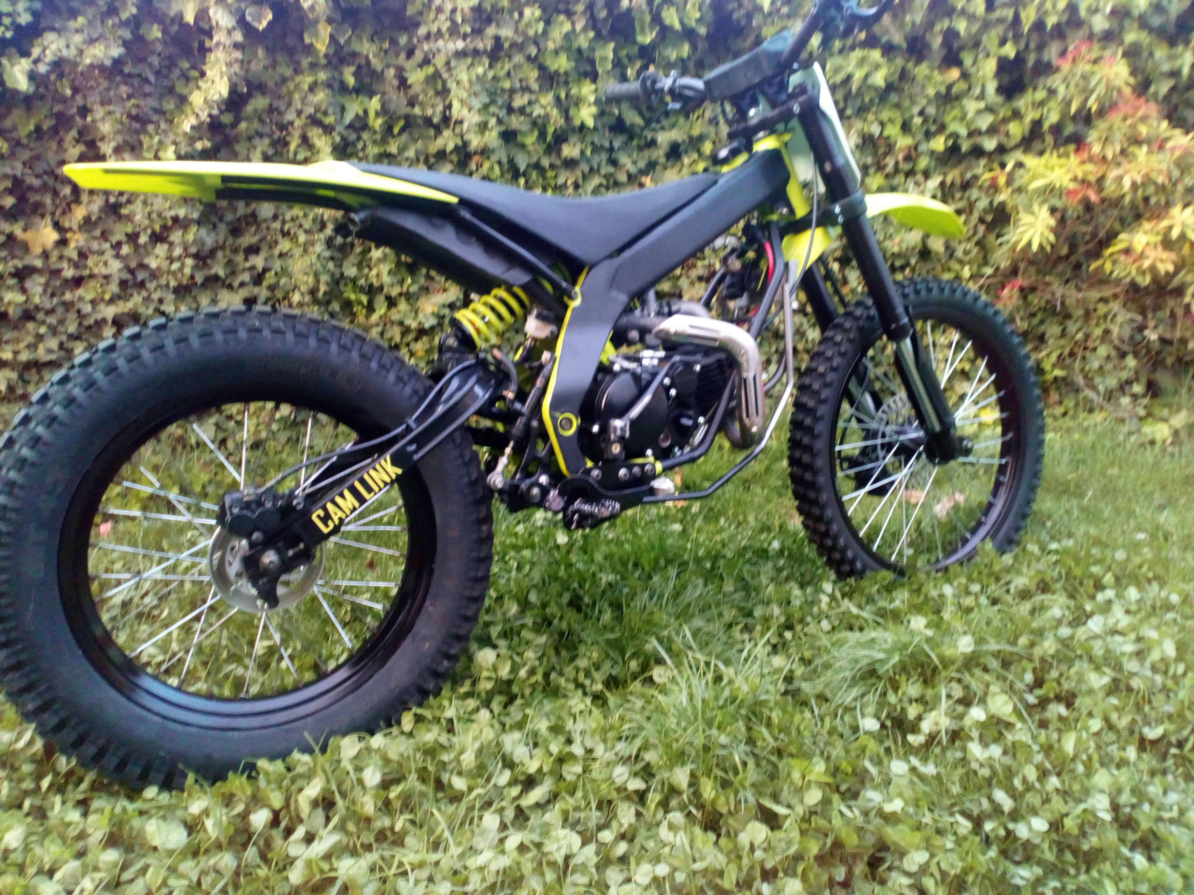

Creepytheclutchmaster Posted September 28, 2020 Report Share Posted September 28, 2020 Here is a bike I did a foot peg mount modification and welded some bash guard frame rails in, added a gasgas rear wheel and mini brake mount it was a pretty cool bike. I'd like to do a cub 90 next. 1 Quote Link to comment Share on other sites More sharing options...
jcone Posted September 29, 2020 Author Report Share Posted September 29, 2020 13 hours ago, Creepytheclutchmaster said: How did you get the head tube of the triple clamps to fit through the frame, iv looked at a few honda cub/c90 frames with the idea of doing a off road mod but the head tubes have all been designed for a old fork with a very thin head tube. Cheers. I cut the head tube off the donor bike and welded it to the Honda cub Quote Link to comment Share on other sites More sharing options...
jcone Posted September 29, 2020 Author Report Share Posted September 29, 2020 7 minutes ago, jcone said: I cut the head tube off the donor bike and welded it to the Honda cub and plated the gussets. Quote Link to comment Share on other sites More sharing options...
jcone Posted September 29, 2020 Author Report Share Posted September 29, 2020 I cleaned it all up in the end Quote Link to comment Share on other sites More sharing options...

Creepytheclutchmaster Posted September 29, 2020 Report Share Posted September 29, 2020 Ahh though you would of had to do a welded head tube job, I don't trust my welding abilities well enough to do a head tube lol. This bike goes by many names, it's a puzy rocky, a Cleveland ffx, a jumper 125, a stag rocky. A probly a few others, it's a great bike to modify, it has the fuel tank inside the frame and has pretty good geometry for a Chinese bike.the foot pegs are way to far forward from new to be used as a trials bike, but it's an easy fix to be honest. Quote Link to comment Share on other sites More sharing options...
