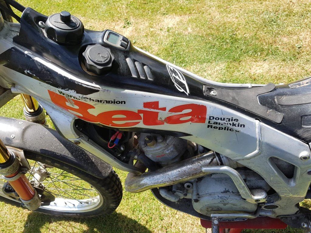

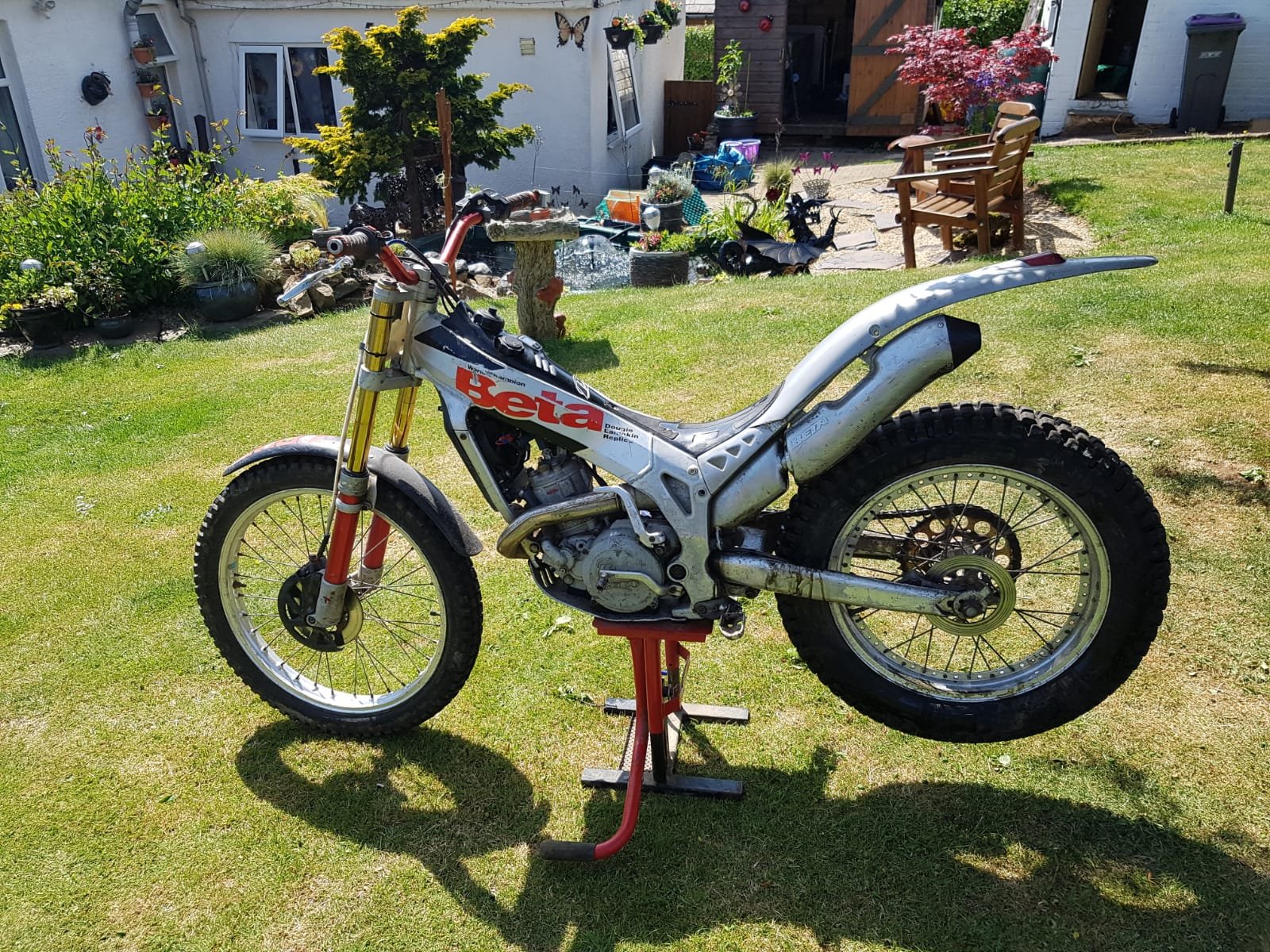

BetaTechno1999 Posted June 2, 2020 Report Share Posted June 2, 2020 Hi, I Just bought a Beta Techno Dougie Lampkin replica. It was in terrible condition as the previous owner neglected the bike big time. I had to buy it, as what a waste of a bike. But to be honest, i think i paid a bit too much for the bike in the condition it was in (£600). On closer inspection nearly every bearing has gone on it and will all need replacing. I am on the lookout for a wokrshop manual. I have the owners manual but it doesn't really go into too much detail. I have started the restoration of the bike and i am finding it hard to source parts for it. I will try to upload some pics when i can. Quote Link to comment Share on other sites More sharing options...
rich500 Posted June 2, 2020 Report Share Posted June 2, 2020 Iconic bike though so good buy! Had one myself back in the day... John Lampkin should be able to help with sourcing parts. Posts some pics when you can - I'd like to reminisce! Quote Link to comment Share on other sites More sharing options...
BetaTechno1999 Posted June 2, 2020 Author Report Share Posted June 2, 2020 Thanks rich500 i need some encouragement at this present moment ive got some pics bike is completed stripped its going to be a nut and bolt restoration as long as parts are available. ? 1 Quote Link to comment Share on other sites More sharing options...
