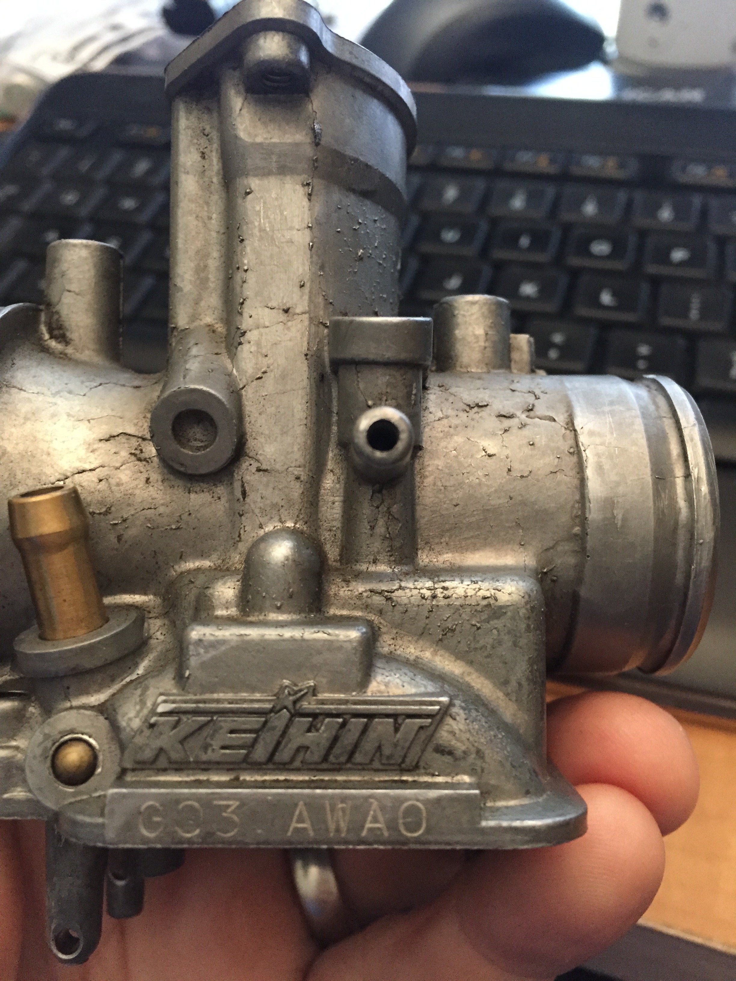

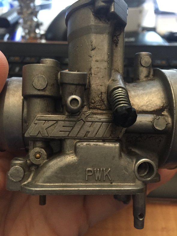

dan williams Posted June 17, 2020 Report Share Posted June 17, 2020 On 6/16/2020 at 3:55 AM, feetupfun said: Another consideration is that the carby has a bowl vent on each side so it probably makes no practical difference if one of them is blocked off Funny you should say that. All the PWK28 Keihins I’ve seen only have one vent open even though Beta puts two hoses on them.? 1 Quote Link to comment Share on other sites More sharing options...

jbrandt Posted June 17, 2020 Author Report Share Posted June 17, 2020 23 minutes ago, dan williams said: Funny you should say that. All the PWK28 Keihins I’ve seen only have one vent open even though Beta puts two hoses on them.? That's pretty funny. Quote Link to comment Share on other sites More sharing options...
