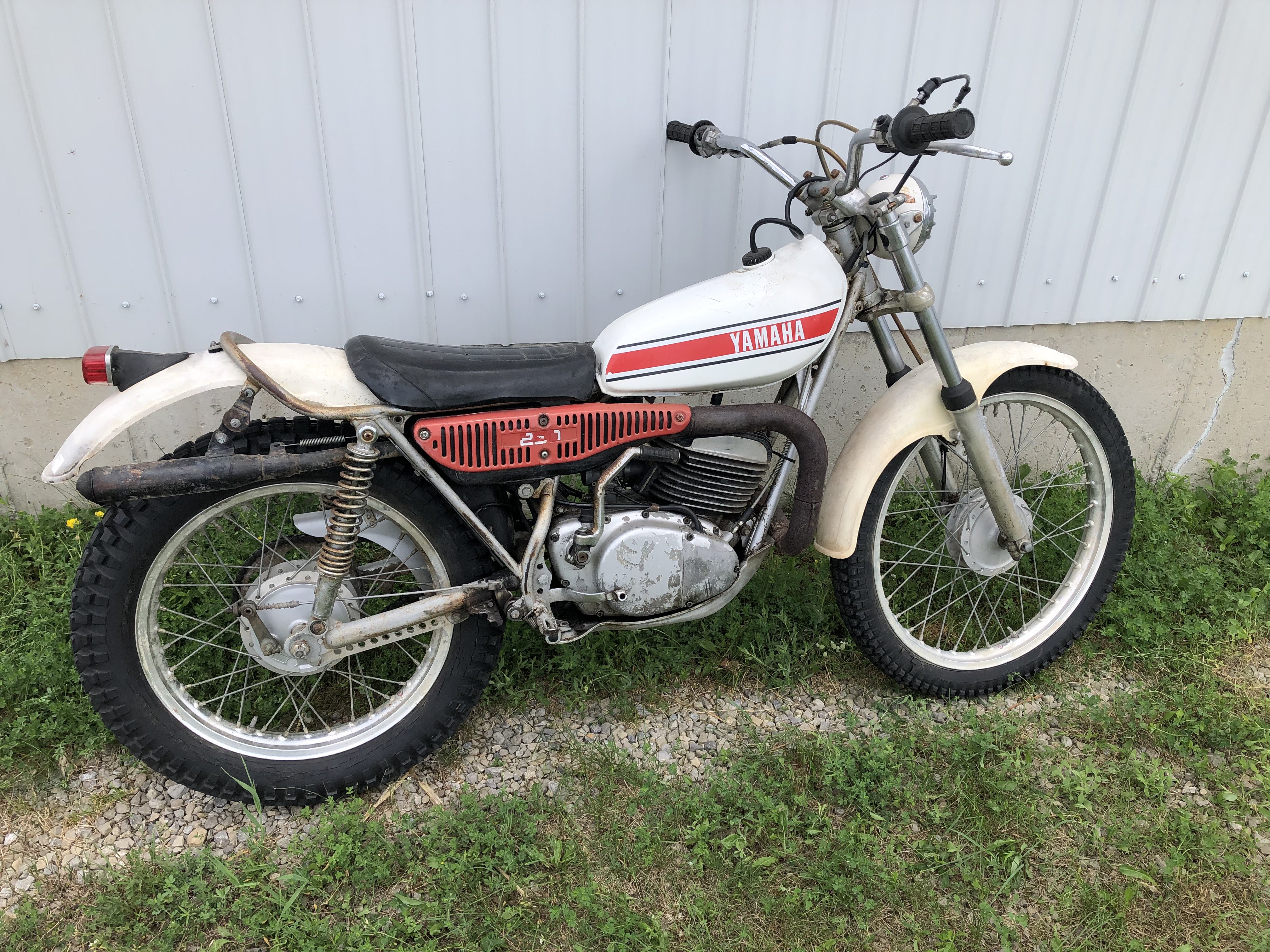

MarkFromOttawa Posted June 24, 2020 Author Report Share Posted June 24, 2020 (edited) Thanks for this! I am still having a look at it...the previous owner got it running after he got it and replaced the flywheel as it was missing... I am a little worried about being able to turn the motor over so easily with the flywheel, maybe due to the 6.0:1 CR? The bearings feel a little graunchy... I think I might do a proper rebuild rather than riding it around right now. I am planning on taking off all the stuff if I am going to ride it...but the tank is mint, I dont think it has but one tiny little ding! It also has an orphan gear lever, I will have to put a new one on... I was saying to friends, I hardly ever buy a bike that actually runs! Edited June 24, 2020 by MarkFromOttawa 1 Quote Link to comment Share on other sites More sharing options...
feetupfun Posted June 25, 2020 Report Share Posted June 25, 2020 Wow that's amazingly original after all the years. Good find and great to see. Thanks for the photo. The absence of external damage and wear makes me think it must have been parked up somewhere for almost its entire life so far. The tyres look like 1970s type. I bought a TY250 in this sort of condition in 1994 and was amazed at how unused and undamaged it was at the time but that was 26 years ago so yours is even more surprising. Quote Link to comment Share on other sites More sharing options...
