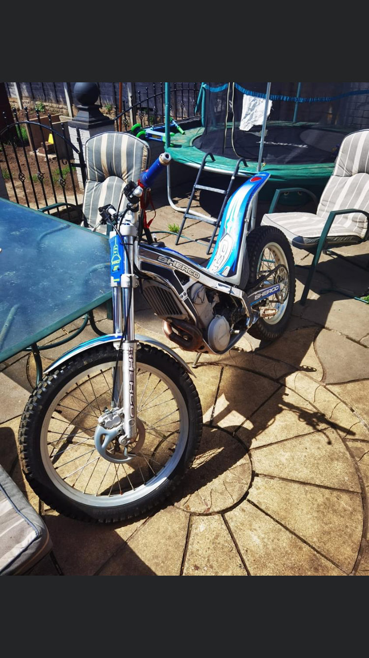

Craigop Posted August 8, 2020 Report Share Posted August 8, 2020 Hi. Anybody know roughly what age this Sherco st320 is? Quote Link to comment Share on other sites More sharing options...
huski Posted August 8, 2020 Report Share Posted August 8, 2020 2005 ish Quote Link to comment Share on other sites More sharing options...

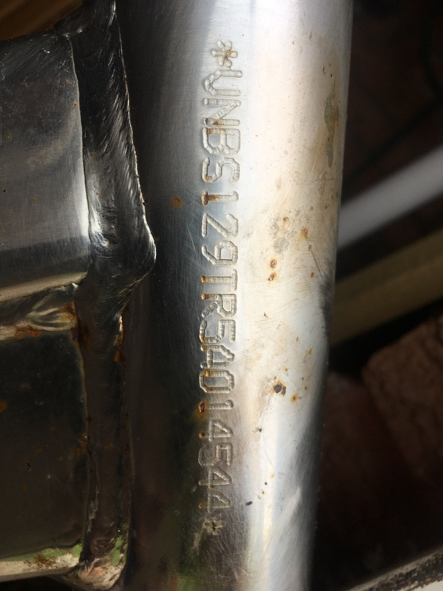

Davidtwinshock Posted August 10, 2020 Report Share Posted August 10, 2020 Check the frame headstock. 6 & 7th is engine size (2.9) 272 cc 10 is year. (2005) hope this helps. Quote Link to comment Share on other sites More sharing options...
